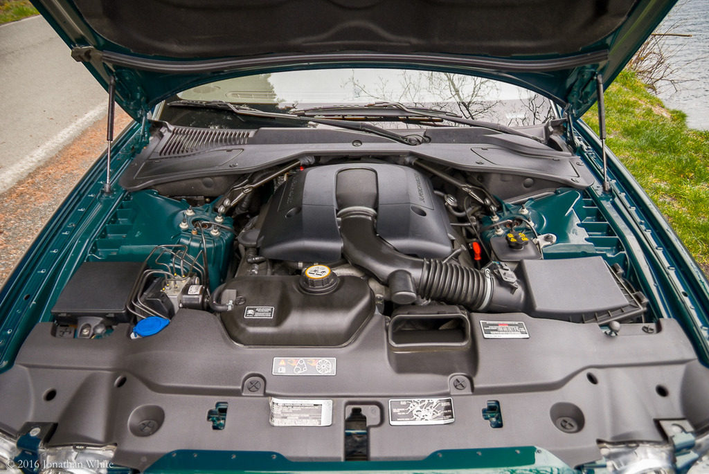

I put Meguiar's new "Ultimate Black Plastic Restorer" on mine. It looks new. I'm really impressed with that stuff. I found it much easier to apply with the bonnet fully up. I never tried removing the skirting.
