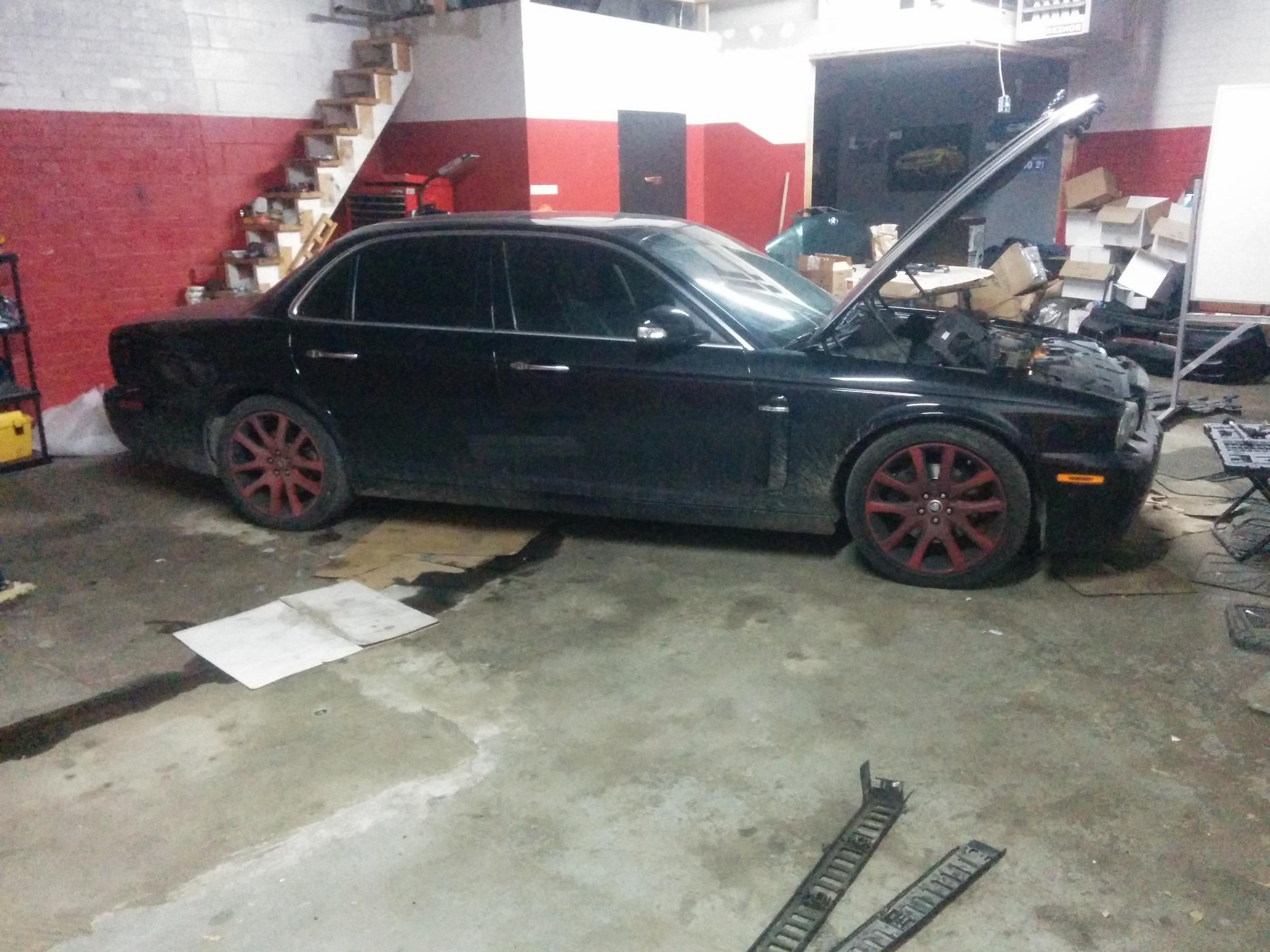

Well... Brought her in, going to start taking a look in just a bit. She's quite dirty, I'll admit. But that's how she likes it.

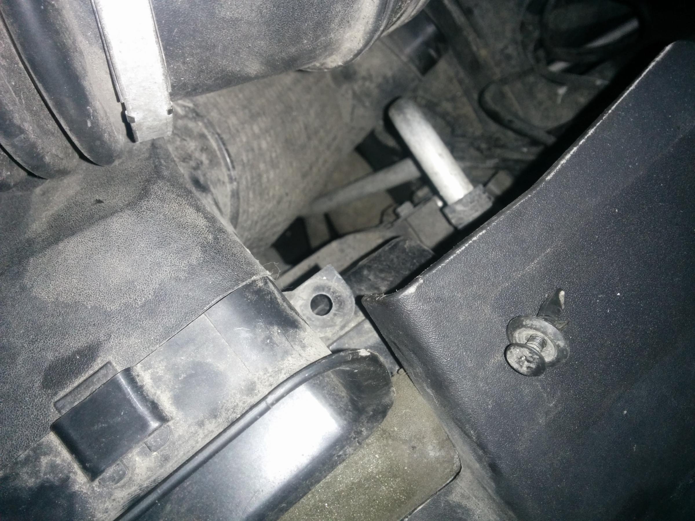

Removing the intake is very easy- there are 3 bolts to remove. One to the right of the filter housing and two small screws at the mouth of the intake which are tied into the rad fan casing.

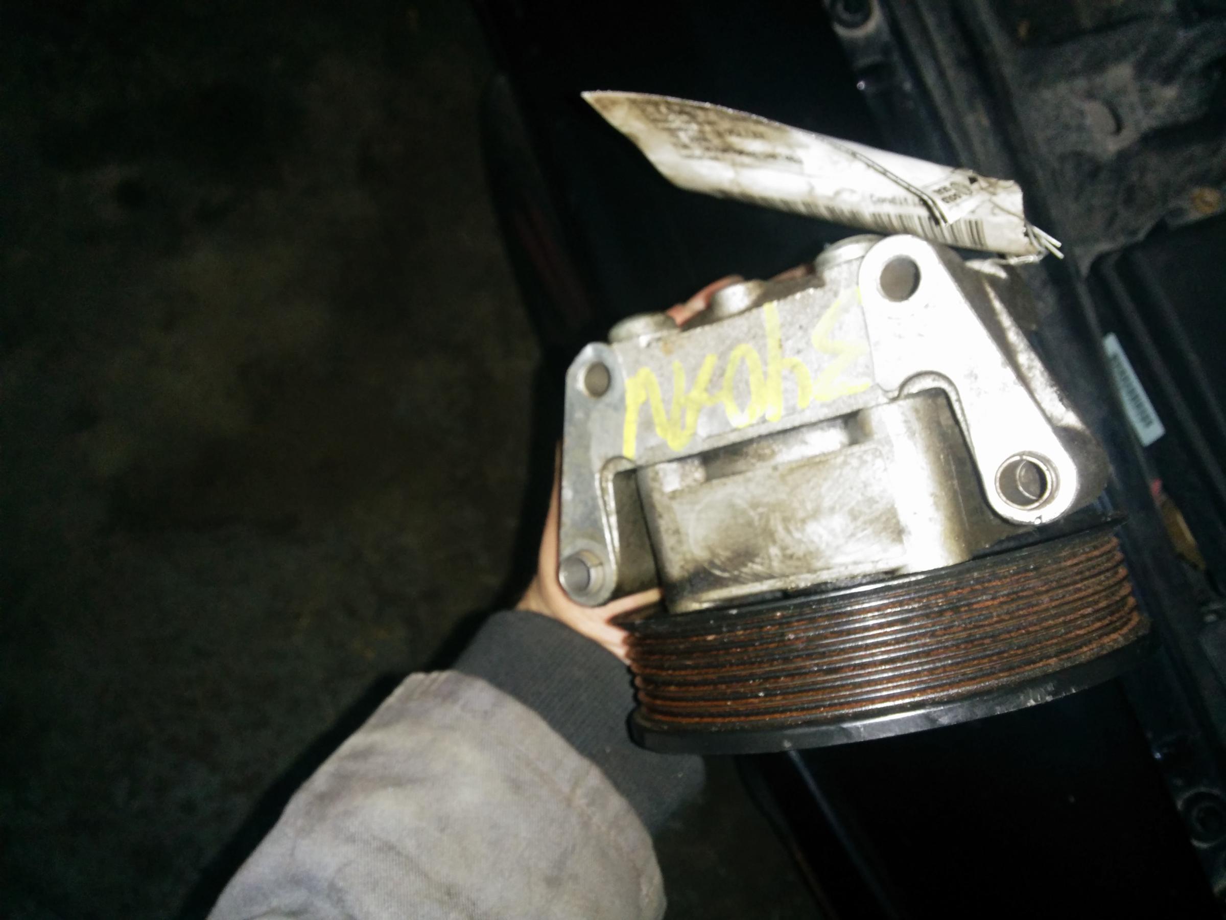

Looking at the new pump, there should be 4 mounting points. From the top, I can only see two. Also, it seems that the hoses are at the bottom too. Now, I will jack up the car to give myself enough room to squeeze under.

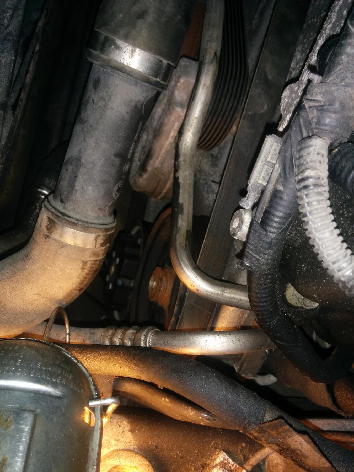

Now with the rim removed I can get a nice solid look at my pump. Everything seems a lot easier with the wheel off.

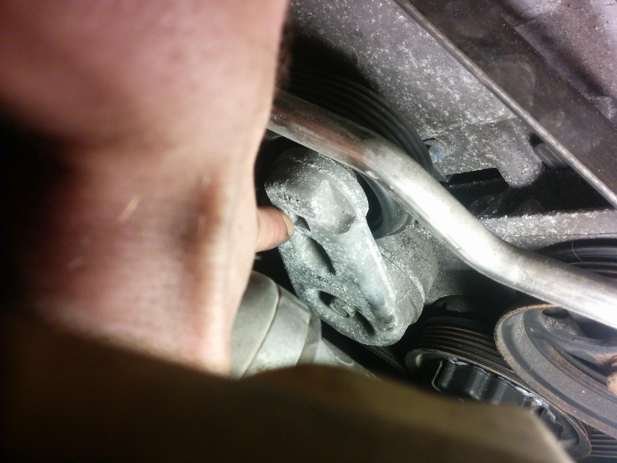

Since we've verified all the mounting points and their accessibility we can go ahead and loosen the belt with the tensioning pulley. I'm sure there is a proper tool for the pulley, however, I do not have it. What I will be using is the next best thing... A ratchet. As you'll notice in the picture there is a small square slot(indicated by my finger) for a 1/2inch torque device but we will just have to suck it up and use an extension of some sort on our rachet.

Okay, found my rachet! For anyone that doesn't have a pulley tensioner tool. A rachet, deep socket and extensions are your best friends. It should give you just enough torque.
