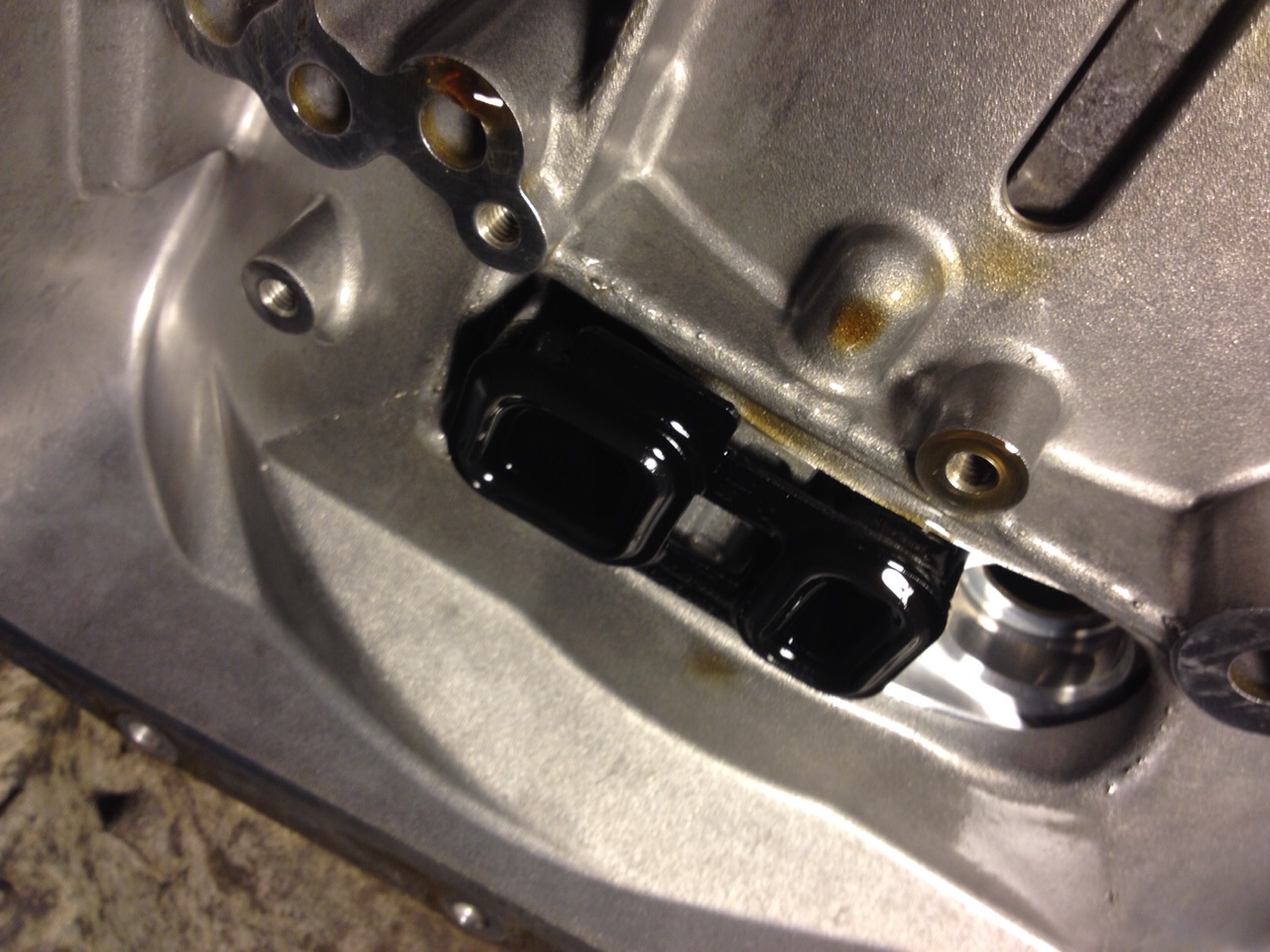

Well, I got the fluid drained, pan dropped and valve body removed (after removing the electrical sleeve of course).
The adapter seal is a loose fit, old one and new one, but the new one is in place. I don't see any visible damage to the old seal, but it is very rigid. The sealing edges though are still fairly pliable and intact. I guess it could be cracked in such a way that I don't see it; I hope so because that means the new seal will correct the problem.
The little sealing sleaves are pushed into their respective places. Based on their length there really wasn't much ambiguity as to which one went where; I just matched sizes and switched them out. The new sleaves are just a "hair" longer than the ones that came out. Perhaps the old ones shrank? In any event, the sleeves were fairly flush with the metal surface when I removed them, but the new ones protrude out a little (see picture). I don't want to force them in farther unless I know they are supposed to be flush. Does anyone know if they should be forced in flush, or are they supposed to protrude to make a seal.
Thanks
Thanks
The adapter seal is a loose fit, old one and new one, but the new one is place. I don't see any visible damage to the old seal, but it is very rigid. The sealing edges though are still fairly pliable and intact. I guess it could be cracked in such a way that I don't see it; I hope so because that means the new seal will correct the problem.
Thanks
Thanks

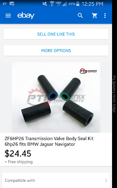

Everything went back together pretty well. The electrical sleeve is always hard to "set", but I'm pretty sure I got it.
There was a lot of spillage, especially while removing the valve body, but I think around 6 liters came out, maybe more. I have put about 6 liters back in but still can't confirm she's full.
The car is still up on jack stands as I wait for it to cool (2nd time today). It heats up so fast I miss my window to verify the level. When I added fluid it was kind of strange. If I pumped it in fairly fast it would flow back out, but when I stopped pumping it would not flow. So I kept adding and adding, slowly, and it would only flow out if I pumped a bit faster, but stop as soon as I stopped pumping fluid in. It was at 49 C when I put the cap back on last time, and it still wasn't flowing when I removed the siphon hose.
I have done this about 5 or 6 times, on 5hp24 and 6hp26, so I am fairly familiar with how filling it is supposed to work. The shop that gave me the adapter seal diagnosis said the fluid level was good, so I must have done it right last time.
When I shift through the gears it's smooth and there are no fault codes, so I'm anxious to drive it and see if the "slip" has been improved or eliminated. My wife has driven it a couple of hundred miles over the past weekend and said it never slipped once, BUT she drove it like a grandma. She is usually a very aggressive driver so it's been tough for her, haha.
I am rambling, but I'm just waiting for it to cool so I can test it again. I really want to get a test drive tonight. I put a box fan blowing on the transmission and left the garage door open. Soon I hope.

The fluid temperature finally dropped to about 33 C so I cranked it up again, ran it through the gears and started adding fluid. At 45 C it started streaming out! It took almost 7 liters. I capped it off, dried everything and put the undercarriage panel back in place.
Test drive: I went about 10 miles, high speed interstate, curvy back roads, stop and go in-town traffic etc. I gave it everything I had, floored it at every speed, zoomed up to 90 mph on interstate (by accident, honestly officer). I did hard braking followed by vigorous acceleration and the car didn't blink. Smooth and fast.
Finally I took it onto the stretch of road where it slipped so bad last time. The surest way to get it to slip in the past was to cruise at 50 mph and hit the accelerator followed by coasting and then the accelerator again. It used to slip badly EVERY time I did that. Well, I could NOT make it slip tonight. I would hit the gas and coast, then floor it, then coast etc... In fact, the car seems faster and takes off from a stop more smoothly than before.
Ok ok, it's only 10 miles. I'm not going to raise the victory flag just yet. BUT, the results so far are pretty encouraging!
I spent less than $200 on parts and fluid. I just pray it STAYS fixed.
Edit: I forgot I spent $25 on the little tube shaped seals that abonano recommended, so I did go a little over $200.

Methinks you have done it!
When you asked about the seal protruding I am guessing that
it needs to protrude since it is sealing against the valve body.
Well done and I have learnt something too!
