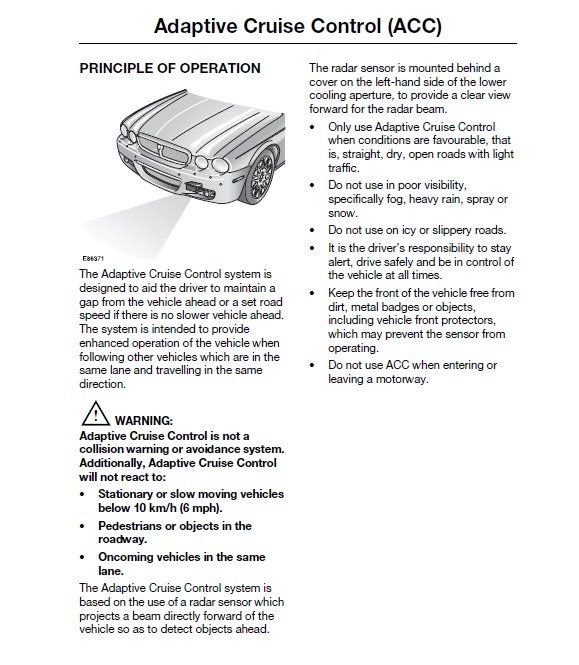

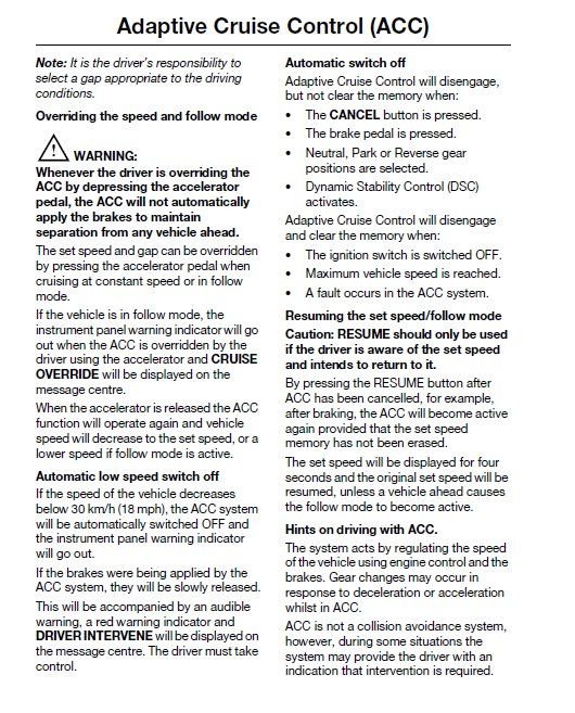

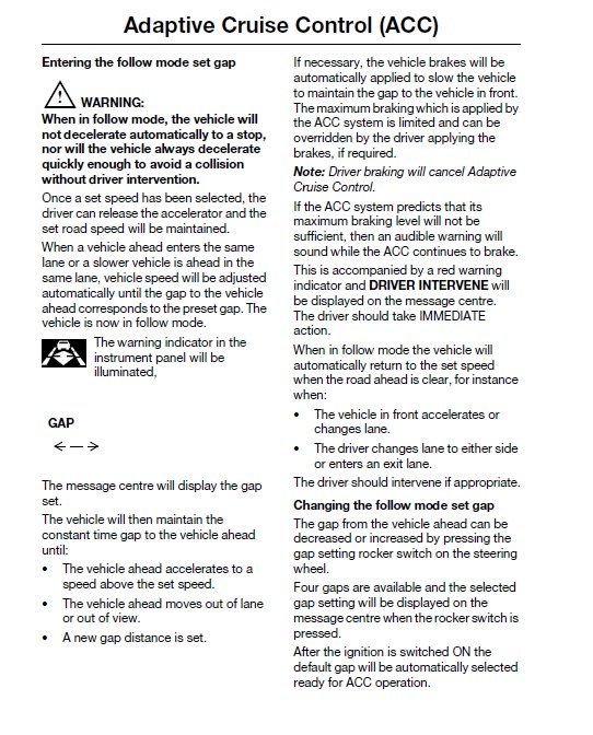

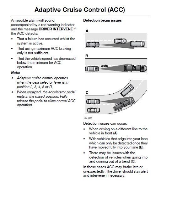

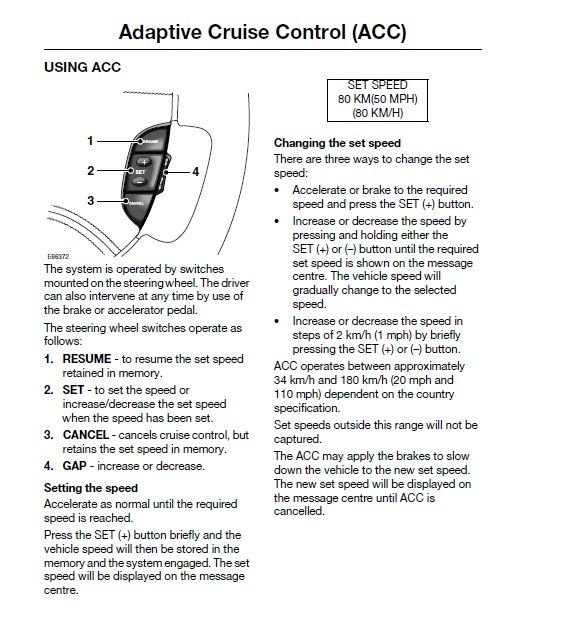

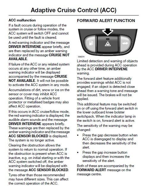

Hi Dean,
Nothing to worry about, it seems that your car has ACC (Adaptive Cruise Control).
With this option (which, at least in Germany, was standard only on the Super V8 and the XJR, and an option on the other models), the car also has this warning function that shows the "driver intervene" function, which can sometimes show up even if you yourself would think that there is now danger at the moment it appears, but then these systems are alswys set to be on the cautious side...
There should be a button between the ones for the boot and the fuel tank flap with which you can switch off the alert warning. When it is switched off, it will only appear in very rare moments.
In case you do not have the owner's manual, here's the relevant excerpts:

Hi Thomas, thanks a lot for putting my mind at rest. You're correct, I had accidently put the ACC alert warning button on! I need a manual that's not in Japanese... lol. I won't worry if ever I see it again. However, it doesn't explain why it came on when the ACC was not engaged? Maybe this was an electrical 'glitch'. I seem to have an ever changing number of these lately. Like the lights going really bright, switching off completely, then re-appearing as normal, all in the space of around 1 second, three times on a trip at night the other week (but not since). Or the remote lock button on the fob not working occasionally (fob battery already replaced). Or the parking sensor alarm going off at random when I'm driving along the road. I resolved to buy a new battery. The one that's on was probably fitted when the car was imported 18 months ago, it's a Bosch, and it looks okay, but a few on the forum say Bosch do not always work well with these cars. It's also a lower rating (800A / 85Ah) than the Yuasa battery that's coming tomorrow (900A / 100Ah). Maybe that will help.

If you read the right hand side of last page that I posted, you will see that the forward alert feature also works when ACC is NOT engaged. That's why you have the separate button for it...
So, no electrical glitch in this case.
