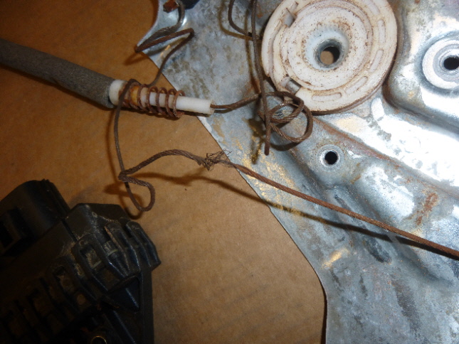

On my way home from British Car Day in Oakville yesterday and my LH front power window failed to close. Fortunately it was a nice sunny afternoon so driving home was OK.
Took a look this morning found a drive cable rusted out. As with all modern cars one is required to buy a whole assembly.
This job is reasonably easy and the Service Manual instructions are easy to follow and they work.
Attached pics show the issue.
Attached Thumbnails Driver's Side Front Power Window Malfunction-lh-front-window-regulator.jpg   Driver's Side Front Power Window Malfunction-broken-drive-cable.jpg

My driver's side front power window is working again. I bought a used window regulator, with motor, from ebay for $71US including shipping and all customs charges .Took about 1 hr to install . Once again the factory manual works well.
