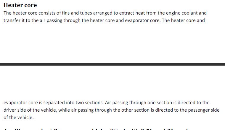

Here is a "How it works" from the X350 shop manual. It looks like the one core has two sections, so one side of yours could be blocked.
You didn't say if this is all the time or just at low speeds and idle. If if gives normal heat at higher engine speeds; then the aux coolant pump isn't working.
It is badly worded but I think that just means that the heater core straddles the air intake for both sides of the dual zone unit.
There isn't a hot water shut off valve on the X350 so hot water circulates through the matrix all the time so there is little point having dual cores.
Air temperature is purely controlled using the blend flaps enabling driver and passenger to select their own temperatures.
