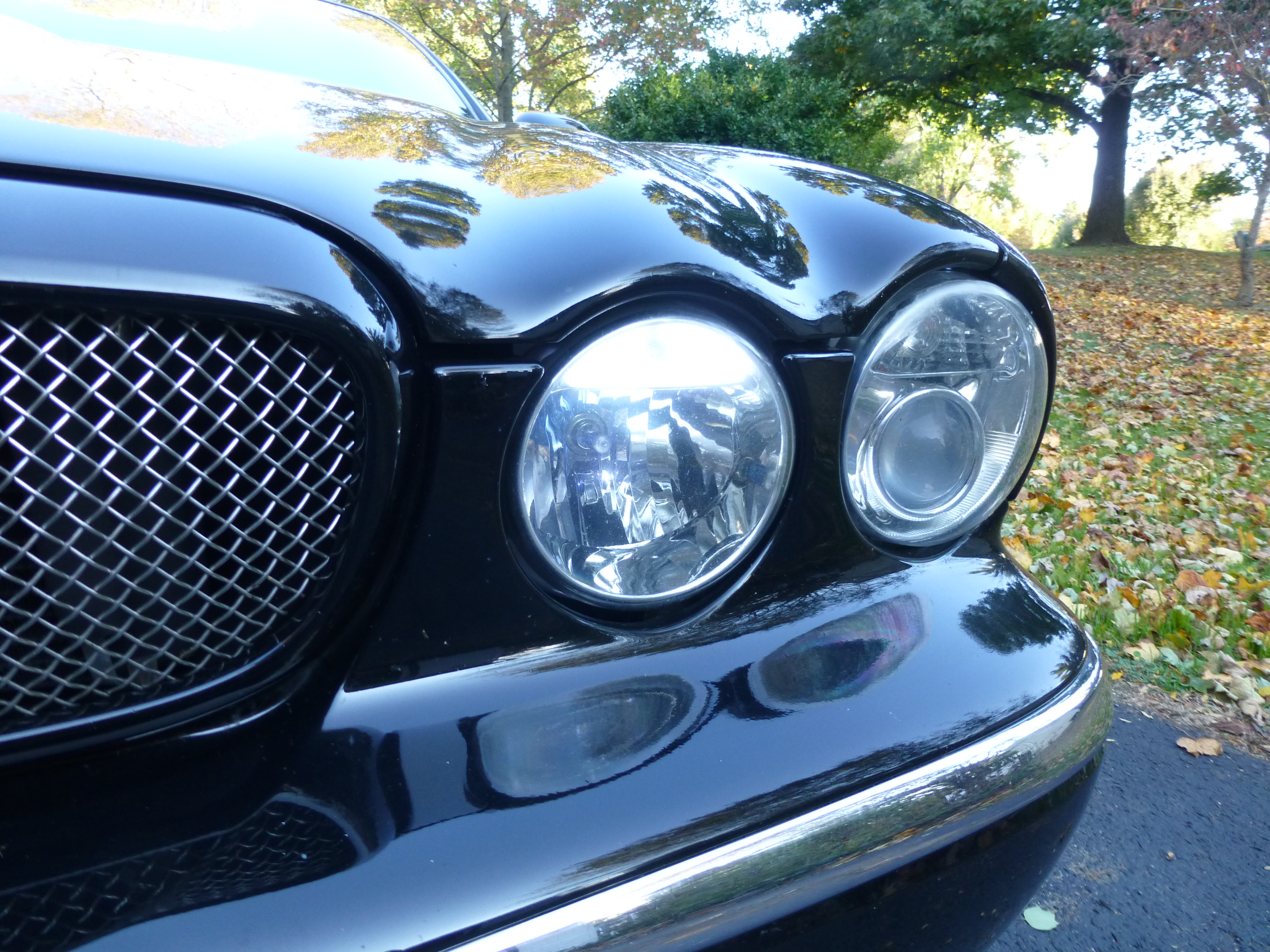

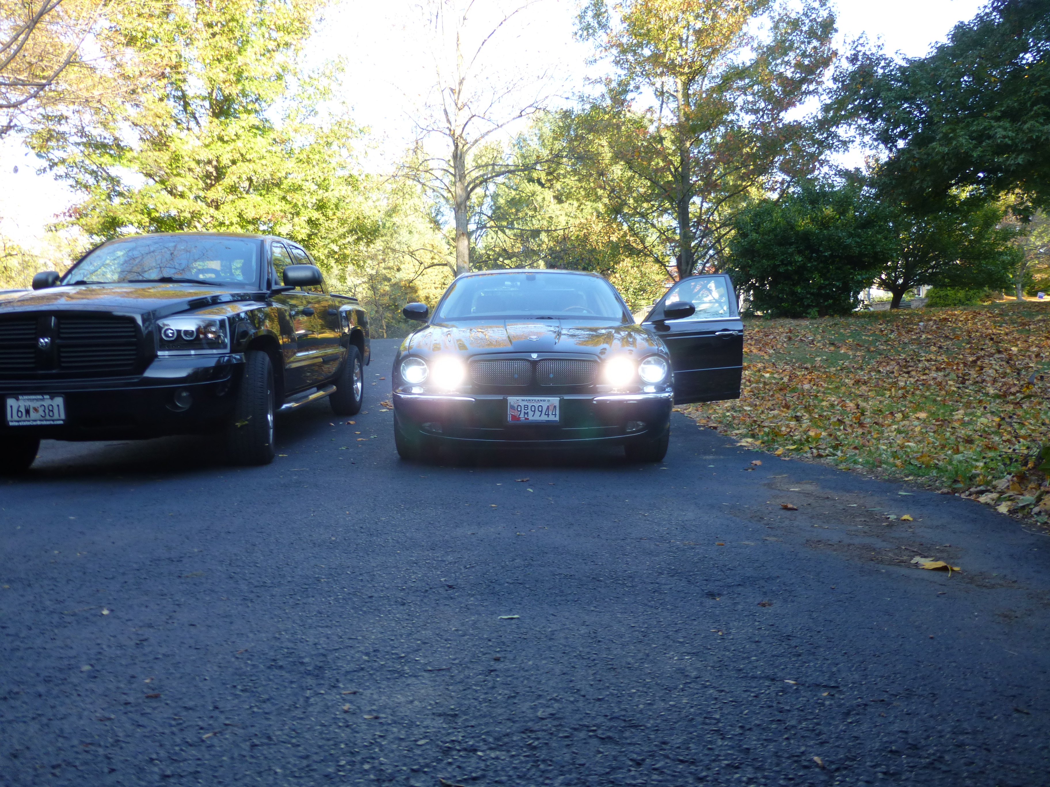

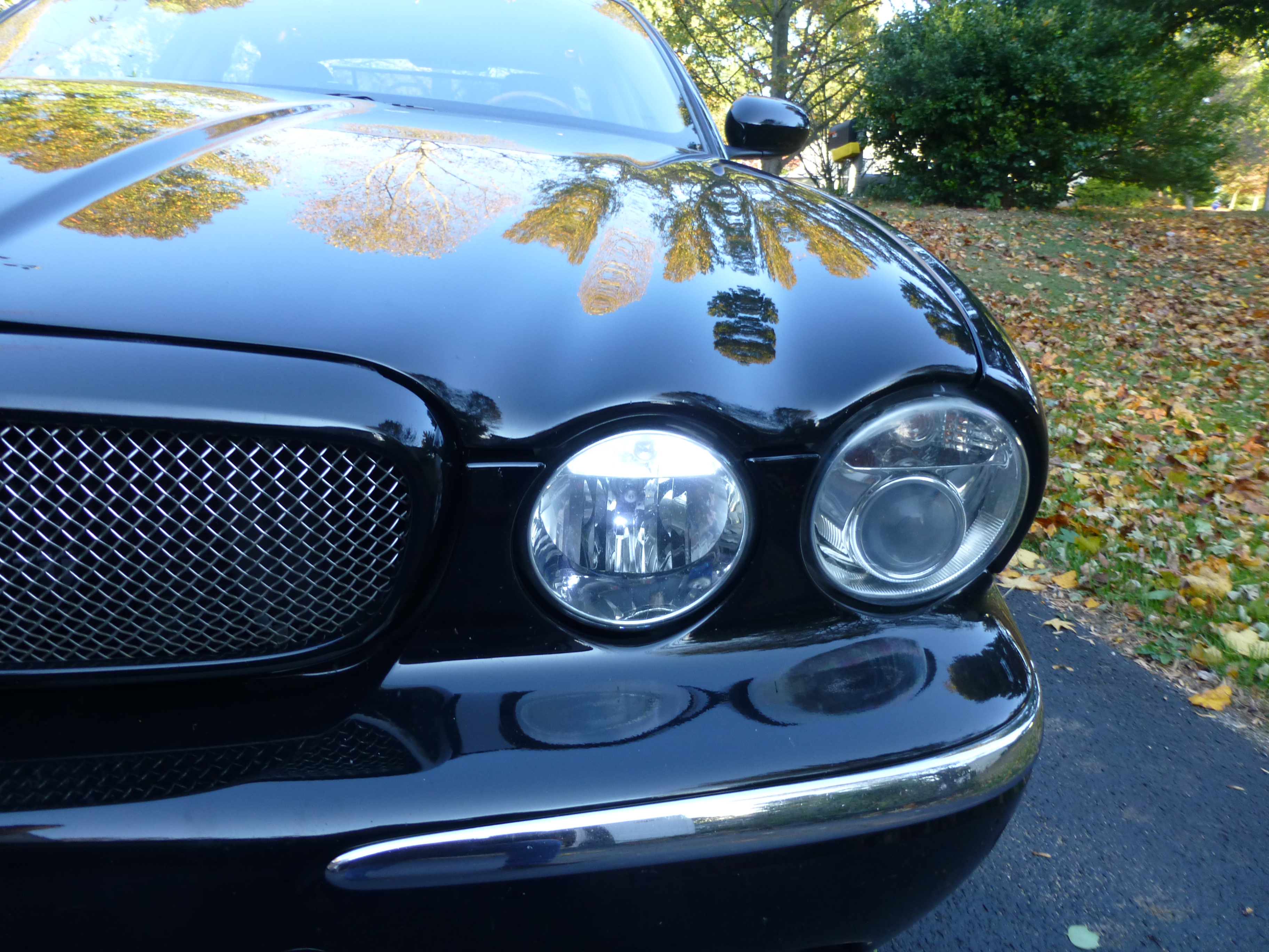

Old Oct 23, 2016 | 07:52 AM
jackra_1's Avatar
Joined: Aug 2014
Posts: 6,264
Likes: 1,764
Default Pics of lights
Just took these pics of lights. Do not know wattage of LEDs and no markings on them.
I upgraded all front facing bulbs. Night time vision is extremely good.
I bought spares of LEDs for the driving lights.
Attached Thumbnails DRL - Any Suggestions?-p1080081.jpg   DRL - Any Suggestions?-p1080080.jpg   DRL - Any Suggestions?-p1080079.jpg   DRL - Any Suggestions?-p1080078.jpg   DRL - Any Suggestions?-p1080077.jpg
Old Oct 23, 2016 | 08:00 AM
jackra_1's Avatar
Joined: Aug 2014
Posts: 6,264
Likes: 1,764
On my first attempt to upgrade bulbs I did it with the front bumper in place.
Managed to insert the driving light tube holder incorrectly so had to take bumper off in the end to sort it out.
So much easier with the bumper off.
Also LED contacts are one way only so if inserted incorrectly will not light up.
