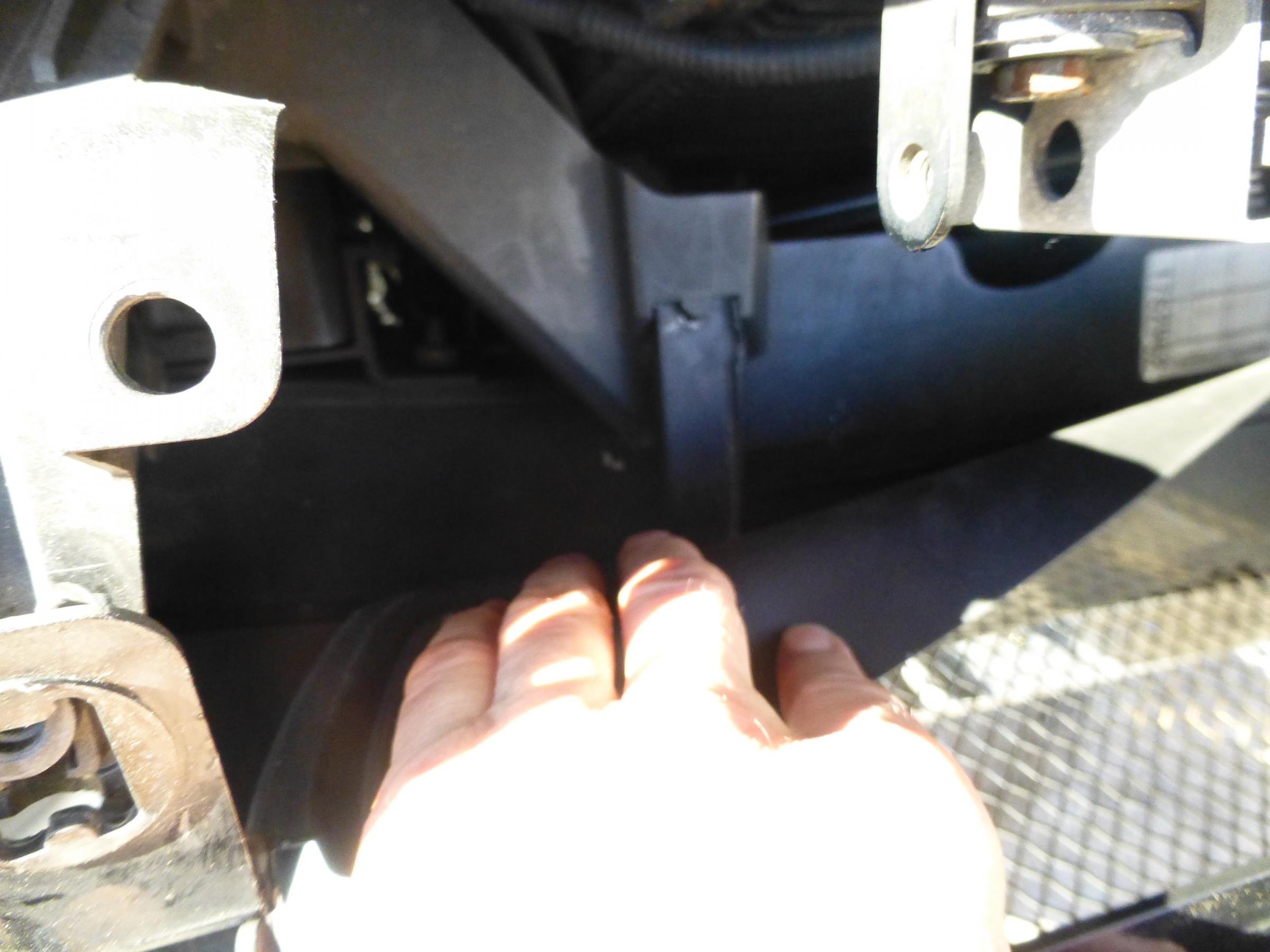

There are two horizontal metal "tabs" that protrude from the base of the grill assembly into a holder just in front of the radiator. I cannot see how to release these.
See in the pic where my forefinger is pointing.

There are two. Just push the chrome lips down a bit while pulling the gril forward. Don't pull on the top of the gril but on the bottom. If you tilt the top of the grill forward it will make undoing the lips more difficult since you want them to go down.

Push down on the tab that is attached to the grill and it will release
The tba has a hole in it and the mount has a circular section that goes though it to locate the grill. In your pic you can see this as the half circle on the end
Worst case press the tab with a screwdriver to release it

Jackra_1,
Take a small flat tip screwdriver and from the top-- where your finger is, slip the screwdrivers tip under the tap. That will release the things and pulling forward from the bottom the grille will come out. Note that the tabs slid through slots in the frame work. You can spend most of a day trying to put the grille back on if you don't slid the tabs back through those slots.....
34by151 I will have another go tomorrow using your suggestion. I did try that today and the tab will move down a bit when I tried pushing on it with a screwdriver. I dont think I pulled at the same time though. Now that I know how it is supposed to work I will have more confidence in what I am doing!
Thanks for everyone's help. I did use a screwdriver to press hard down right before the circular "button" and with some force got the grill out.
