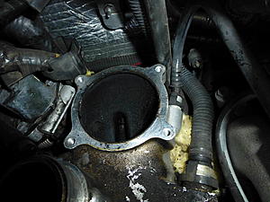

Totally agree I did the same and now have an oil catch can on the high load breather hose which does catch oil.
The oil/gunk build up was pretty severe on my charge coolers at around 100k miles.
See pic of the inlet elbow when I first dismantled everything.
