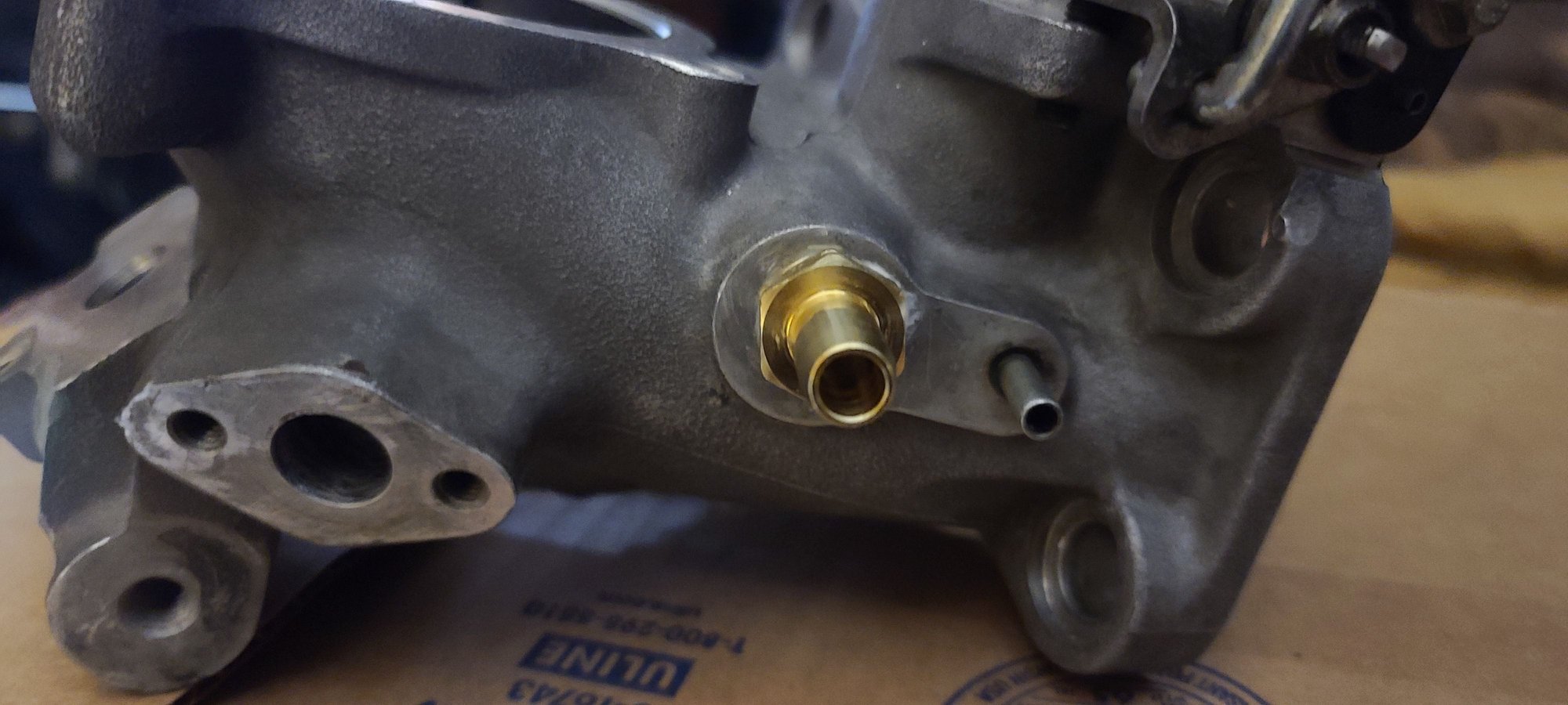

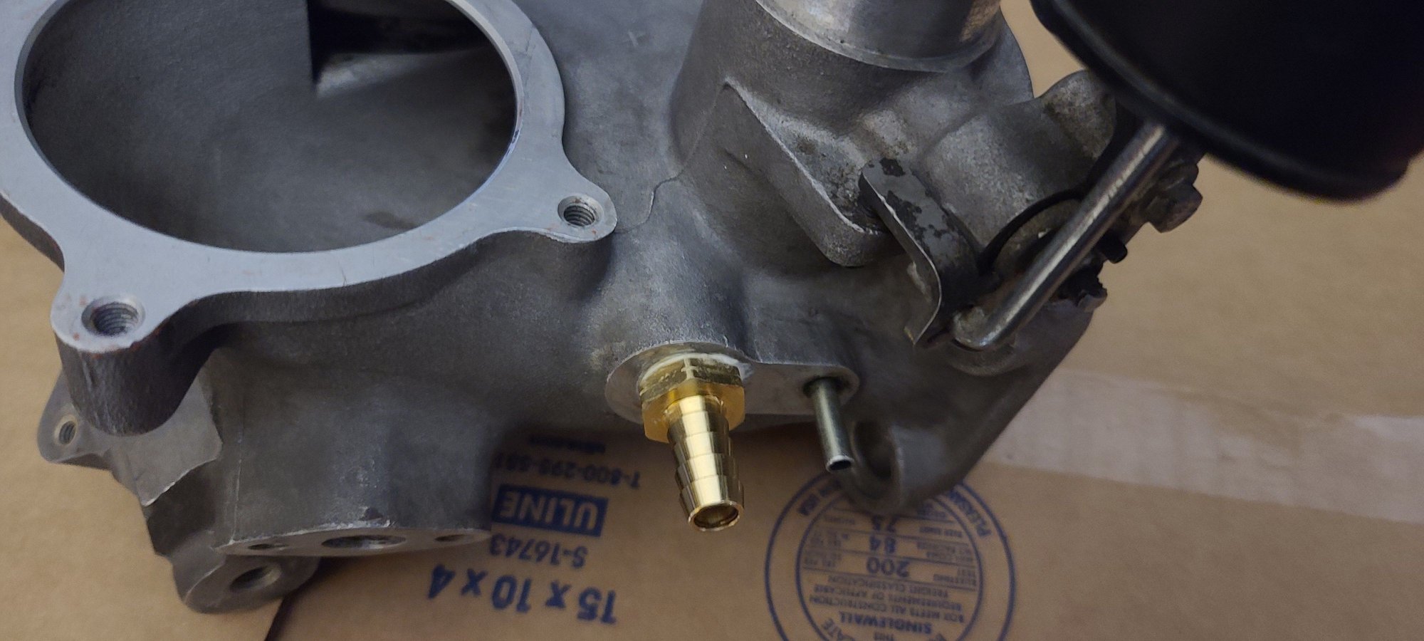

I know this has been addressed somewhere on this forum, However, after replacing the bushing and o-ring twice, I decided to tap the bushing and replace with s screw in brass fitting from Home Depot. Should fix the leak for good.
