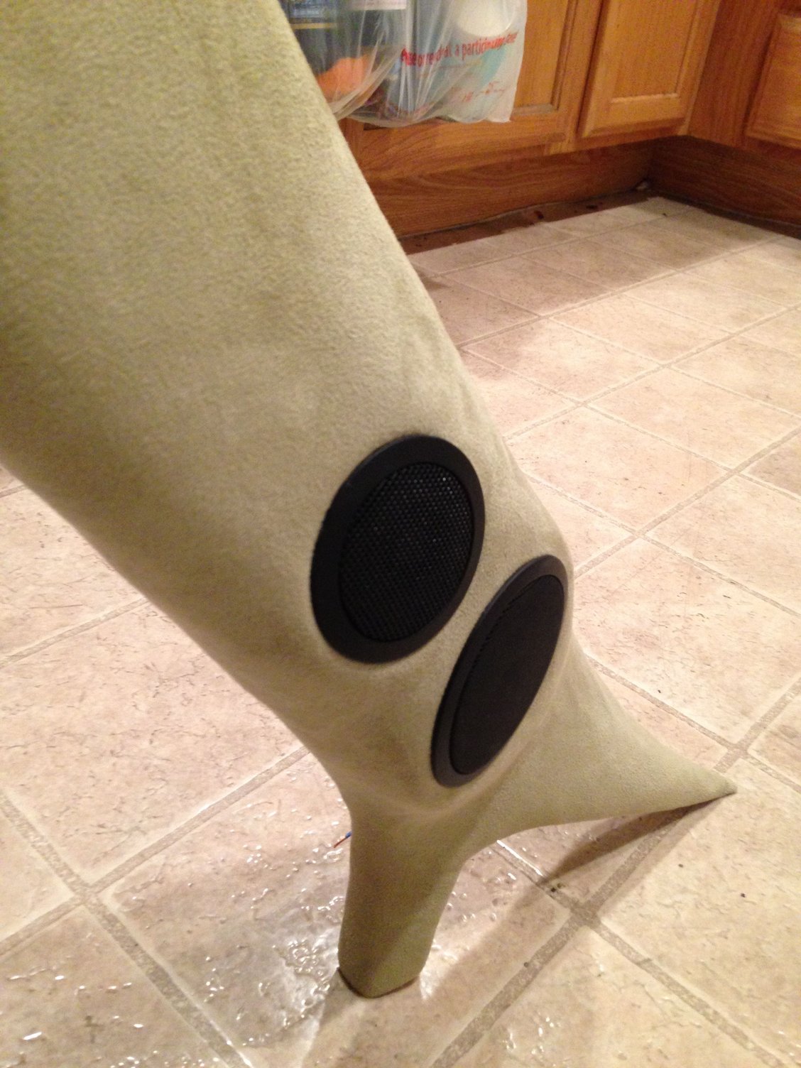

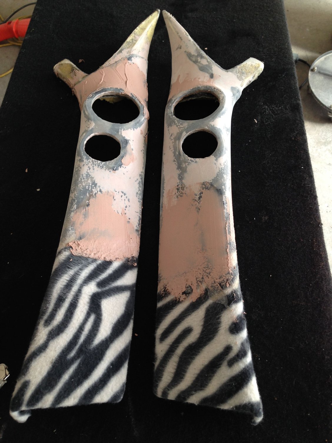

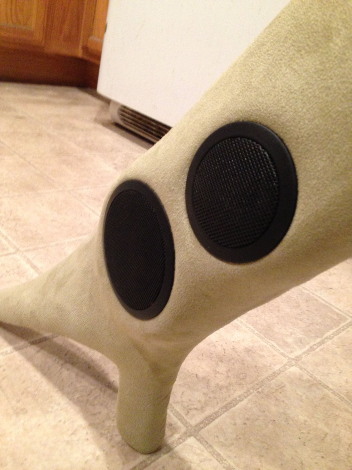

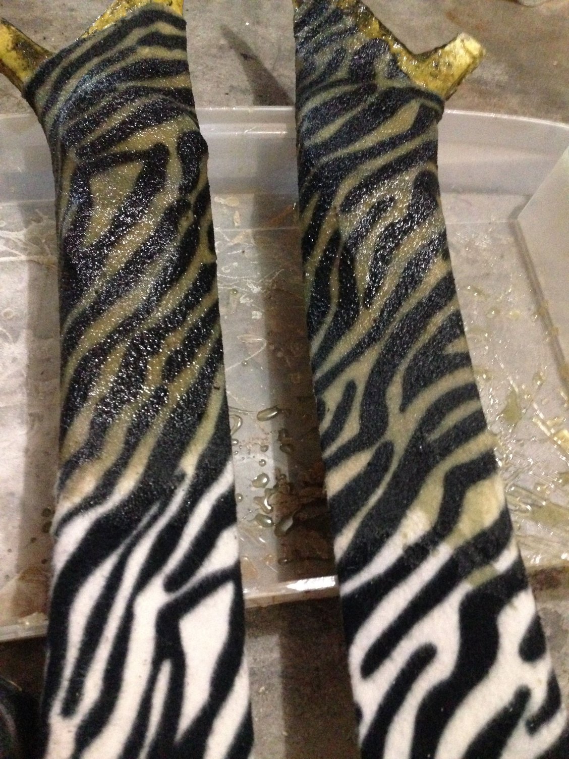

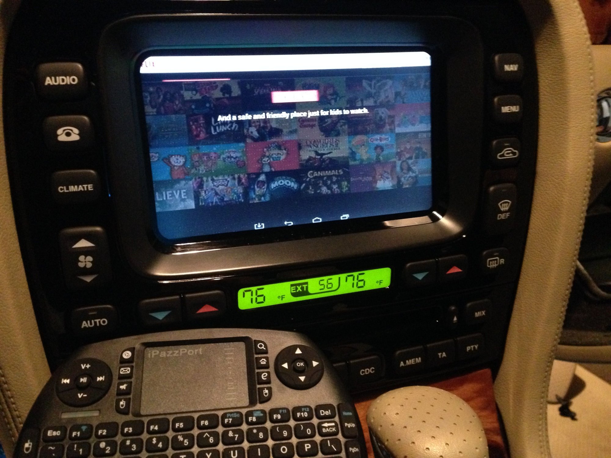

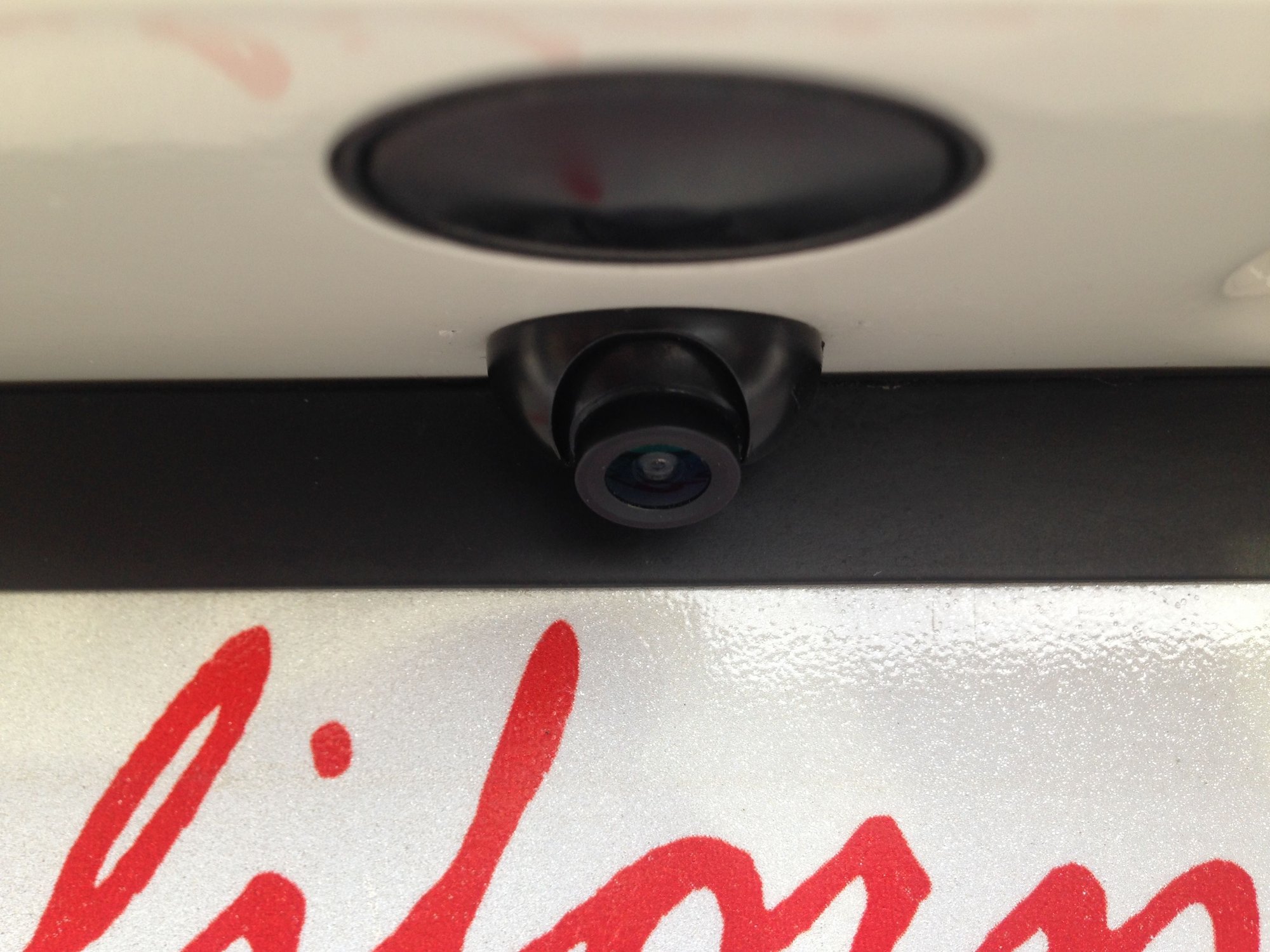

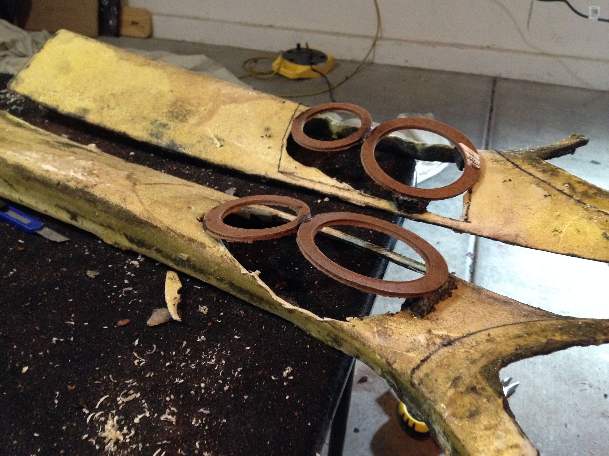

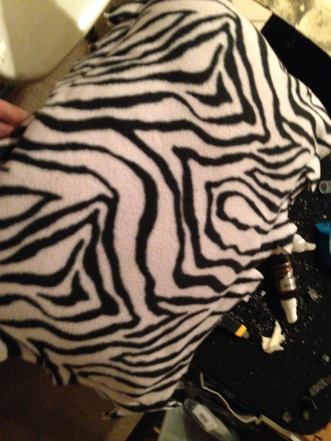

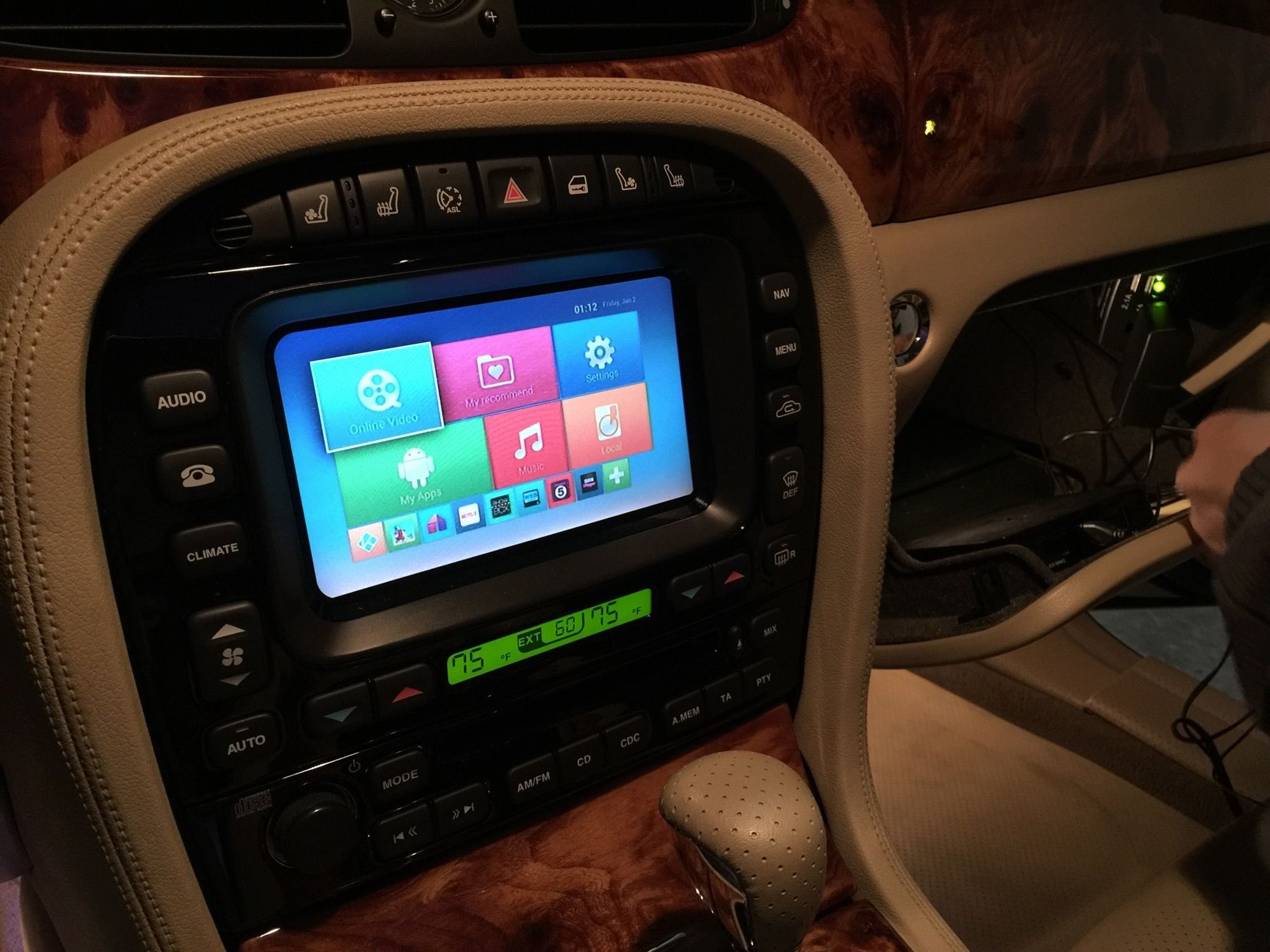

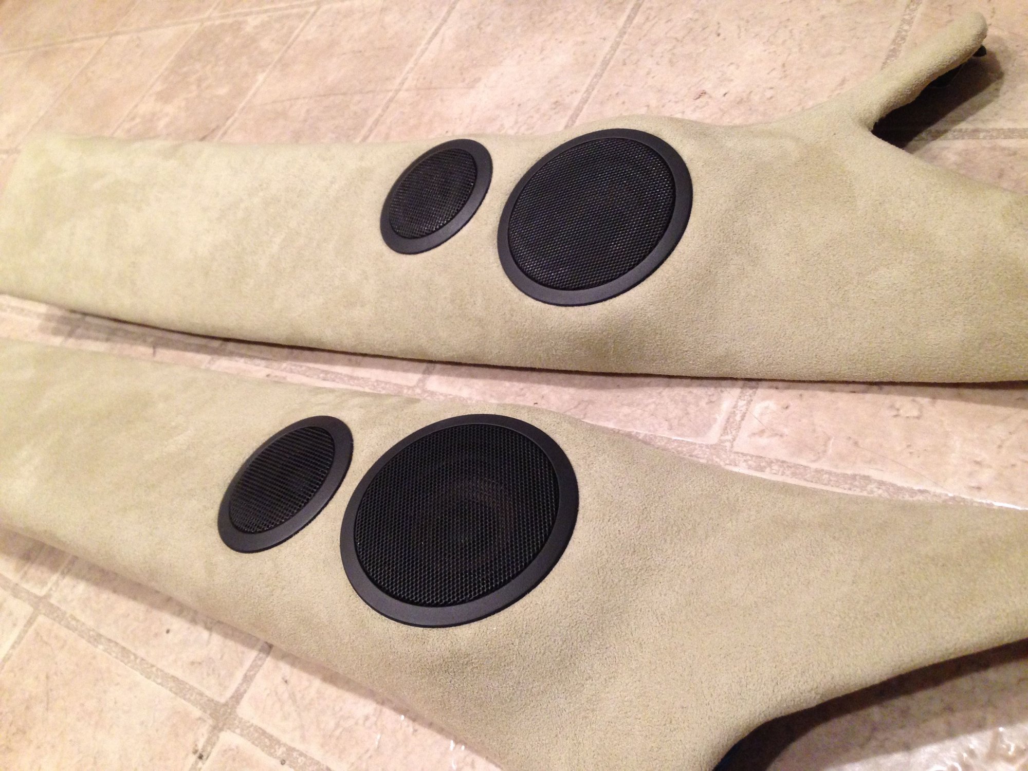

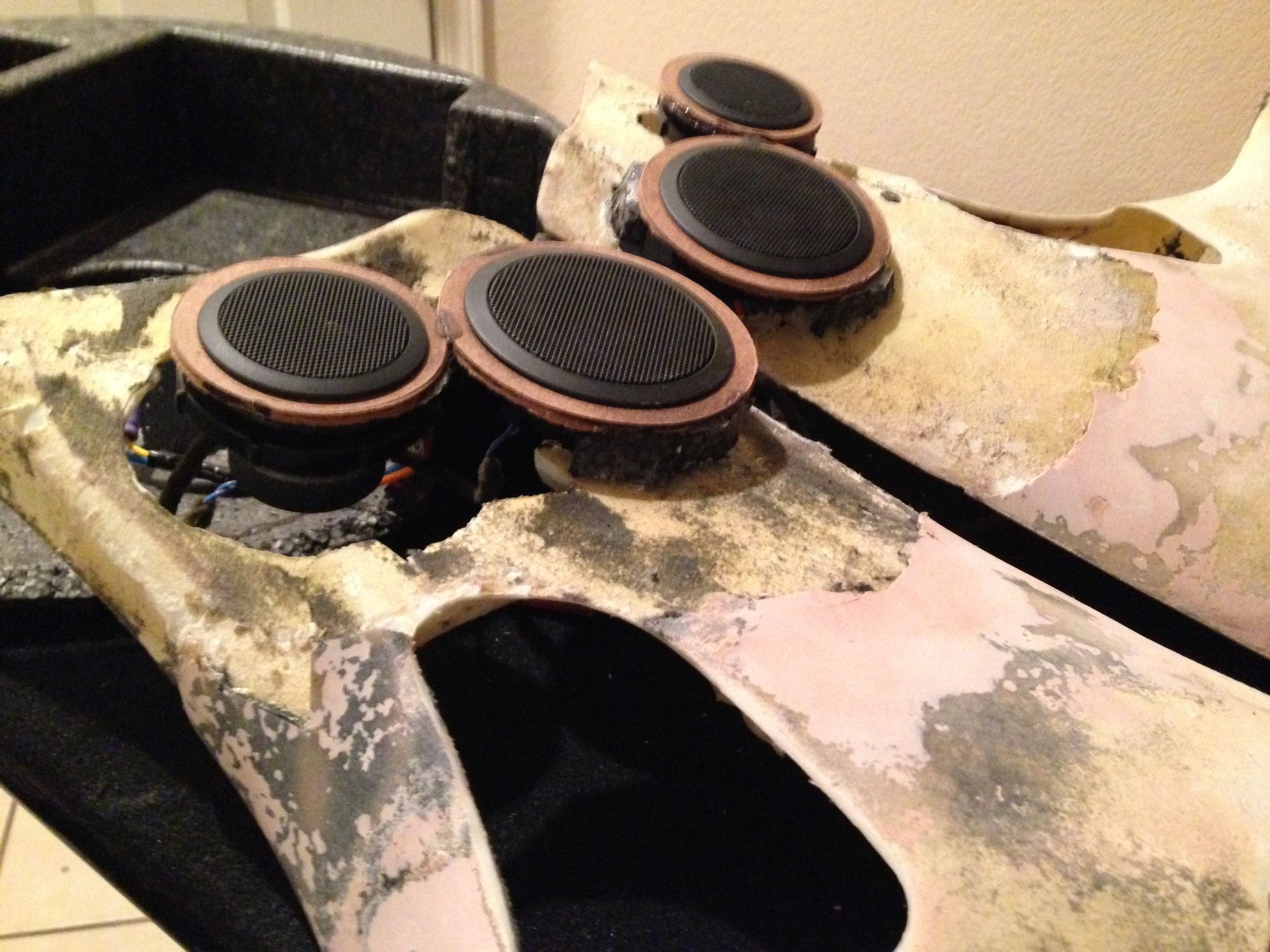

Todays progress
there's the tiny camera. smaller than trunk pop button
The skeleton. Mid is aim straight tweeter pitched towards us.
Cut my zebra blanket up to save some money.
First layer of fiberglass, followed by a bit of body work.
Wrapped in suede just like headliner. It sounds amazing up front cant wait to get rear pillars done
Driver
Passenger
Testing
still haven't decided what component to use. Here is the MXQ tv box

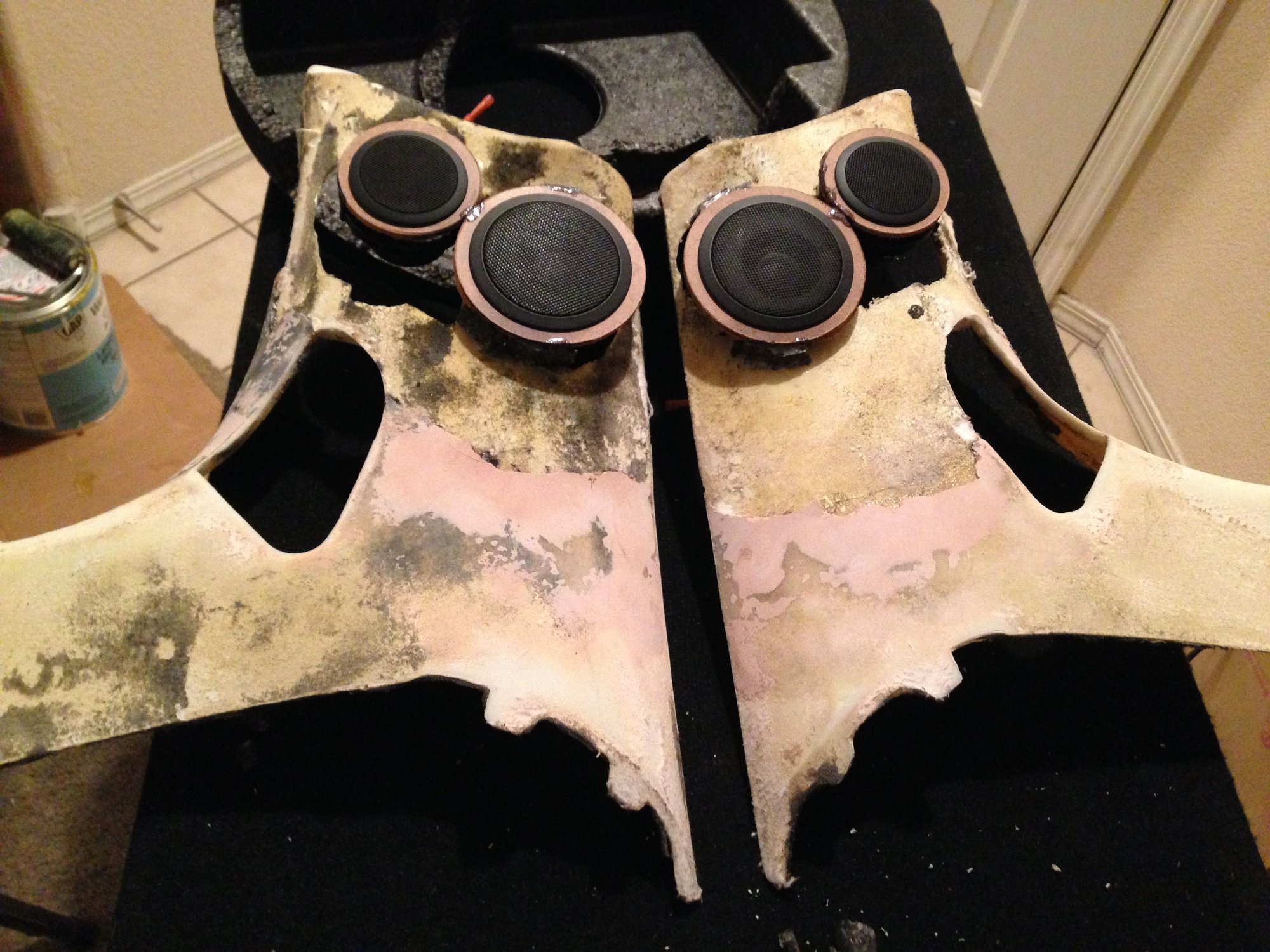

Alright The Rear C Pillars should be done by tomorrow.
Here is the Skeleton
Decided to pitch the tweeter higher but keep both speakers pointed straight
I used all of my Zebra blanket so Now I will hack up my Zebra pillow to make the mold. LOL Again i'm way over budget on this project.
