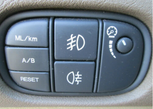

Howdy all!
I rarely post my own issues with our 2005 XJ8L as it has been pretty darned reliable...but stuff happens.
I had just finished the rear brakes recently, when I noticed (likely total coincidence) that the Fog lights front and back no longer come on with the button press. Curious as to why both would fail, I checked the dash light dimmer switch since it is also on the same cluster switch. Also not working.
Do I just remove the coin cup below it to get to the connector? Is there possibly something else that would cause all 3 to fail to work before I check that connection? Where do those go if the connector is still intact?
Happy cruising!

Thanks for the reply!
The turn signal stalk has full functionality: turn signals, lights and various modes, bright/dim.
It is the switch on the lower left which shares the cluster with the fuel/trip computer modes that is failing to work, though the computer buttons work.
Since all three fail to work (front fog lights, rear fog lights, dash dimmer rotary switch), I'll try a full module reset first (disconnect and touch the battery cables together for a bit). If that doesn't work, I'll have to dig into the electrical diagrams and see if I can track down a grounded wire or such (after verifying all fuses and relays).
fog lights and dimmer not working (this is not my jag, just a similar unit, probably from an S model)
