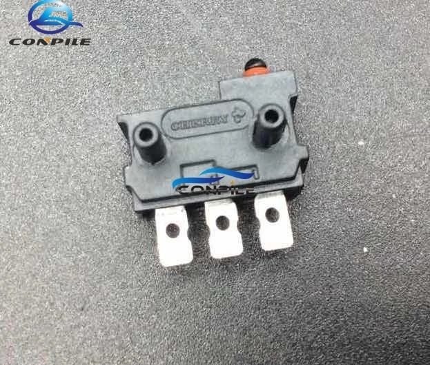

Thanks Meirion1, how many Microswitches do I actually need, please?
I found this, is it correct, please?
https://www.bing.com/ck/a?!&&p=af063...g2NzAyMw&ntb=1
Old Jan 28, 2023 | 09:10 PM
meirion1's Avatar
Joined: Nov 2009
Posts: 3,145
Likes: 805
From: The beautiful Mornington Peninsula in OZ
The link you sent is not the correct microswitch because
you need metal contacts on the outside.
You need one microswitch per actuator but I suggest
that you buy more as spares.
Old Jan 29, 2023 | 03:54 AM
EsRay's Avatar
Joined: Oct 2017
Posts: 1,302
Likes: 218
From: Dubai
Thanks Meirion1,
Is the link you sent previously for the correct one, please? It now appears to have disappeared? Is there a definitive part number or something that would enable me to source the correct microswitch?
I apologise for being such a pest, but I obviously want to try to avoid shelling out USD100 for a used Actuator, plus another USD100 shipping, plus 5% import duty, plus 5% VAT just to get it here!
Thanks again,
Ray
Old Jan 29, 2023 | 05:11 PM
meirion1's Avatar
Joined: Nov 2009
Posts: 3,145
Likes: 805
This is a direct replacement for a failed microswitch
https://www.aliexpress.com/item/1005001333053410.html
Old Jan 30, 2023 | 03:34 AM
EsRay's Avatar
Joined: Oct 2017
Posts: 1,302
Likes: 218
From: Dubai
Thanks Meirion1
Just to double-check, please, is this the correct one:
DJ1G-AG10 For Ford Focus Trunk Tail Door Lock Vertical Micro Limit Switch
While I am bothering you, is there also a microswitch in the DDM, please?
Regards,
Ray
Old Jan 30, 2023 | 02:48 PM
meirion1's Avatar
Joined: Nov 2009
Posts: 3,145
Likes: 805
Yes it's correct.
No microswitch in the DDM
Old Jan 31, 2023 | 06:37 AM
EsRay's Avatar
Joined: Oct 2017
Posts: 1,302
Likes: 218
From: Dubai
Yes it's correct.
Thanks Meirion1, you're a star!
