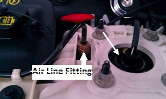

I had the same problem last month. I sprayed some soapy water and found the leak was from the brass fittings for the airline. Removed them and replaced the O-rings, all is fine now.

I wish it were that simple, mine is coming from near the center (there is some kind of sensor there), but not around the nut itself.

Update - Had the car in to the Jag dealer to look at some other items and he confirmed the air shock itself is bad and not repairable. See my post on 12/7 for a picture of where it was leaking. Jag will replace it for $1250 + about $200 labor. I just ordered one from Arnott for $399 and will replace it myself. Yes, Arnott's are 'rebuilt', not new, BUT they give a lifetime warranty. If it ever leaks they replace it free (less shipping and labor). I don't see how I can go wrong with that. Jag won't do that even at $1250, and if their quality had been good in the first place I wouldn't be going through this at 60k miles.
