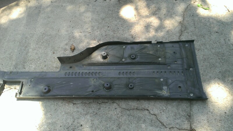

I got the multiple cylinder misfire codes on my '04 XJR again. I decided to change the fuel filter since I'm pretty sure it was original. It was pretty simple. I put the car up on ramps and removed the plastic tray from the driver's side.

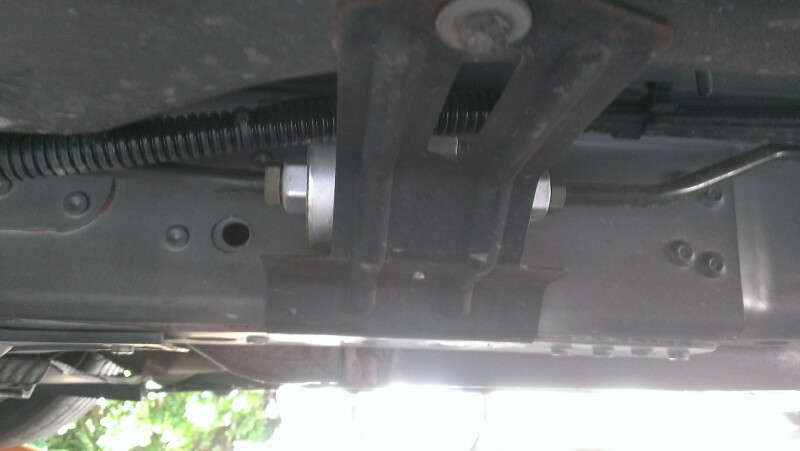

The fuel filter was right there under the driver's feet, held in with a bracket.
The fittings seemed to be 20mm and 16mm, so I used a monkey wrench. There was some residual fuel pressure in the line. Next time I do this I'll wrap a rag around the fitting before I take it loose. It was only a few ounces of gas, but I still got sprayed in the face with it.

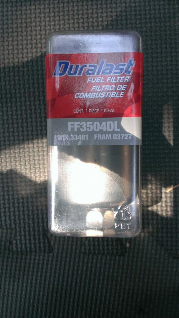

I got this filter at Autozone. I had taken it out of the package and had it sitting next to me when I got the gasoline bath. When I picked it up to install it I found the gas had washed all the lettering off the filter, including the arrow that shows you which way the fuel should flow. I compared it to the old filter to figure it out. Once it was back together the engine cranked for about 5 or 6 seconds then ran fine. I guess time will tell if it solved my problem.

The fitting on the fuel line looks like 16mm. naturally, I couldn't find my 16mm line wrench and the 15mm was too small, the 17mm too big. The fitting on the filter seemed to be 20mm - again, the 19mm too small and the 21mm too big. I used a monkey wrench.
