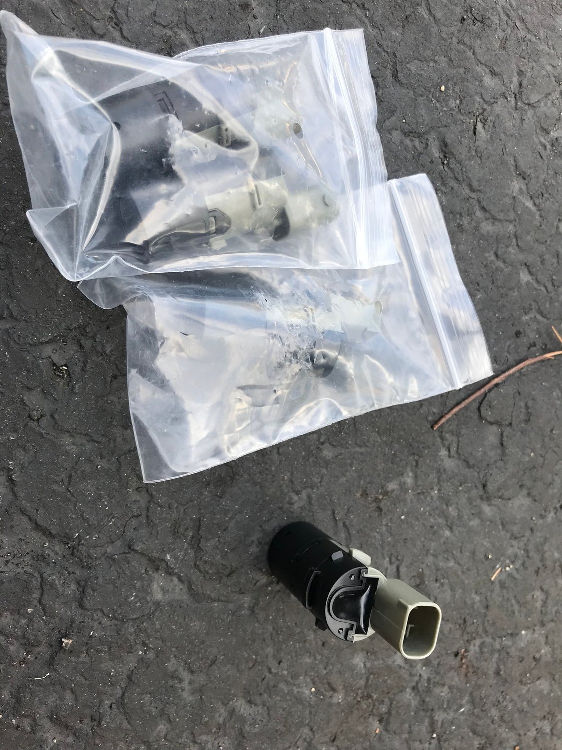

I found that these backup sensors work for my 2004 x350.

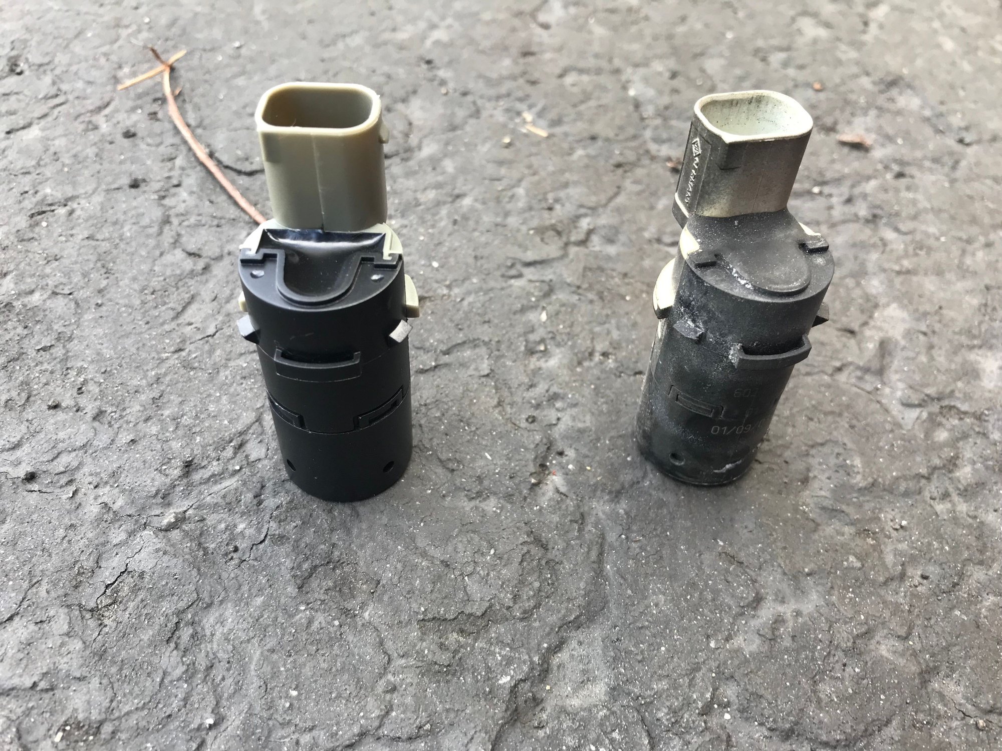

Here are the new sensors. They come molded in black. They are specified for BMWs, but work on my X350 and hopefully others as well as the X358s.
The new sensor on the left and my old one on the right.
I bought the full set for $21.88 with free shipping on amazon -->
here here
Amazon says they will not work, but they are an exact fit and work as expected.
They are cheap, so we will see how long they last. At least we know that BMW sensors will work so there are likely many other manufacturers out there for these if this particular set are not very robust.

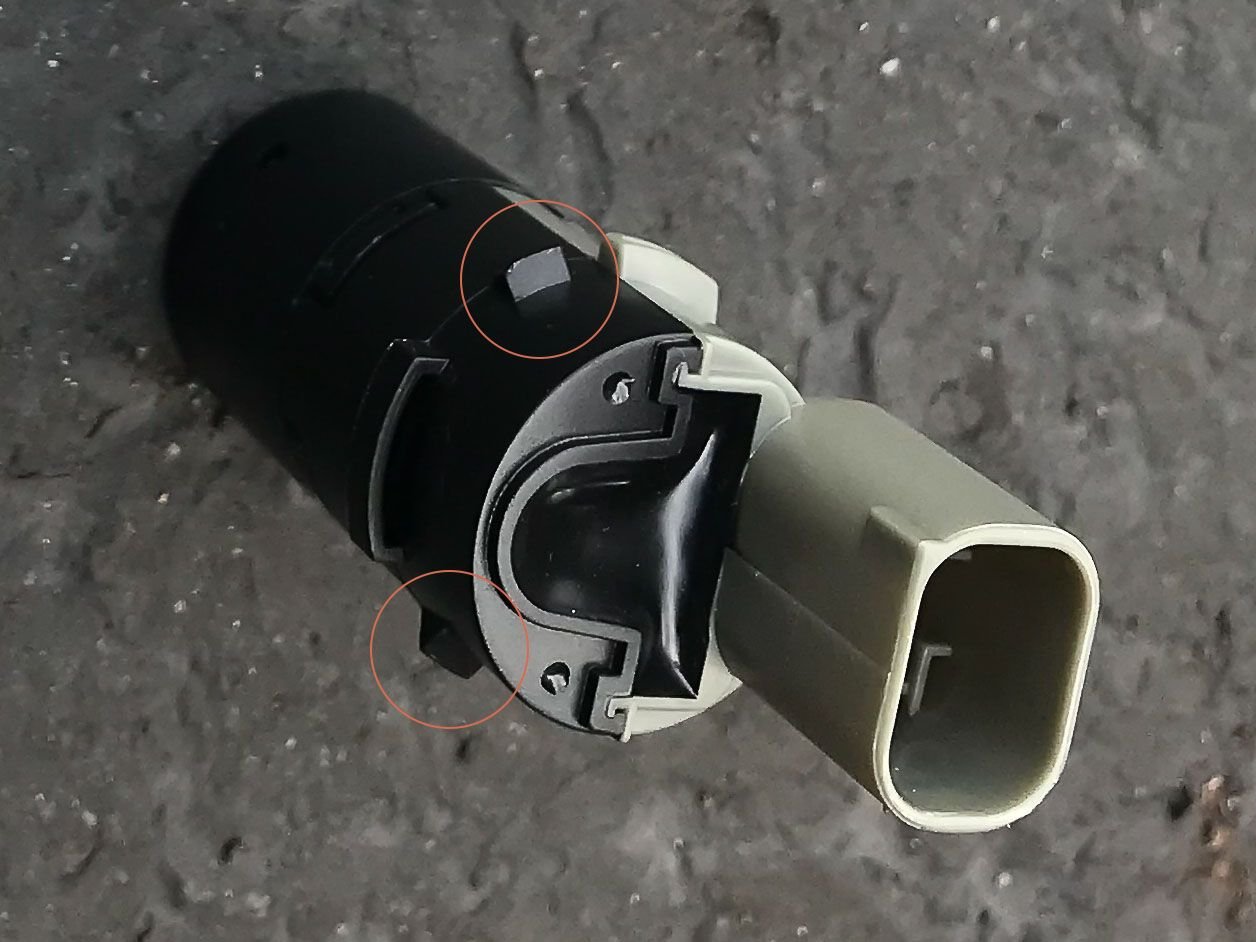

I think it is possible to install them in an incorrect orientation. I know they will slide into the opening, but I am not sure if they can fully lock into place. There are two tabs on the sensor body that slide inside groves in the locking tabs on the inside of your bumper.
The two circled tabs slide into the grooves of the locking tabs in the bumper.
As I understand these, for either side of the car, there is a pair of sensors. One for transmitting a signal and the other for receiving it. If either one is defective it'll cause issues. I originally had an extra full set from a junkyard xj8. My backup sensors have never worked since I purchased the car. I would just get the long warning tone that indicated a fault in the system. I individually swapped out each sensor in a stepwise procedure with one of the junkyard ones until the warning tone ceased. I thought the problem was sorted easily enough and reinstalled the bumper, etc...
When I first tested it all seemed great, so I buttoned it all back up and parked the car. The next day it started beeping indiscriminately and intermittently, and then eventually just regularly (as you are describing). There must have been more issues, so I did some research and learned more about them, discovering the transmitter/receiver aspect and also learning that our sensors are common and cheap (I randomly watched a video with some guy troubleshooting his in a Renault, and noticed they were exactly the same as ours!). So I just replaced them all, which corrected problem.
The point of sharing this is that, I can't be sure if I reinstalled one of them incorrectly, when I was having the same problem as you. I know when I installed the brand new ones, I properly cleaned all of the locking tabs and openings in the bumper, and made sure each sensor was fully seated. The first attempt, with the junkyard sensors, was a little more careless as I was merely troubleshooting at the time and I wasn't really approaching it from long-term perspective.
To answer your second and third questions, unfortunately they can't be turned in situ, and the bumper has to come off to correct this problem. Well, except for the outer two. You can just barely access them with the tail lights removed, but at that point it is not much harder to remove the bumper. The little sensor housings are weakly bonded to the bumper (melted to it, I think), and trying to fight them with the bumper installed risks breaking them off, for which repair would necessitate bumper removal anyway. There is only six mounting bolts for the bumper, so it is not too bad. The most annoying part is the removal of the trunk upholstery, floor, back panel, and rear lights. It's not too bad a job. You can also update your rear marker lights to
LEDs LEDs
while you have your bumper out.
I hope this helps and good luck!
