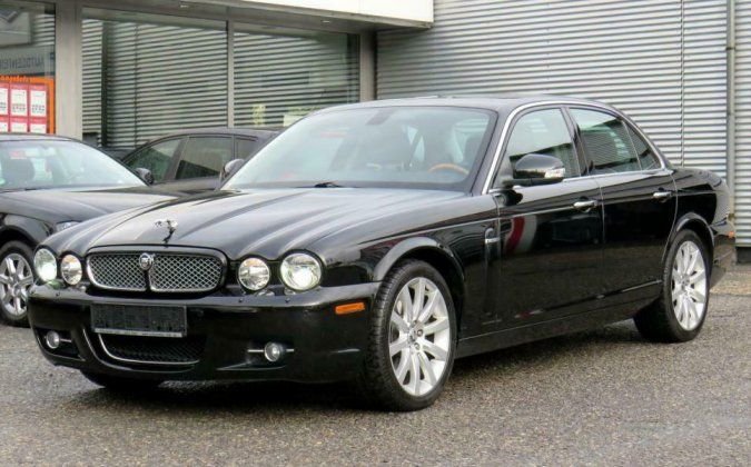

Jeff, my car is an X358 from 12/2008, 4.2 ltr N/A, two previous owners, 70 k miles, black on black.
I suppose the question is at what mileage you' ll have to expect starter issues. I'm not able to answer that question, because i had no starter issues. It was just a job of preventive maintenance because i often travel abroad and i dont like to run aground with such issues.
I used the repair kit containing switching contacts and the plunger for the solenoid. Its about 20 bucks and you'll have peace til the end of time...;-)
