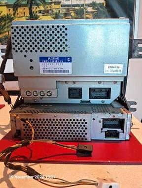

These are the numbers on my Denso Head Unit:
2W93 10E889 CJ
462200 - 5258
Can anyone tell me whether a replacement will have to exactly match all of these numbers, please?
Will those that have an included CD player instead of a tape deck (like mine) be universal? I have no problem with changing to a CD player...In fact I would prefer it?
I think I need to ensure it has those 4 RCA plug-ins for my rear entertainment module?
For example this one does not match the numbers but looks right:JAGUAR XJ X350 2005 Display Screen 2W9310E889CG | eBay It is numbered W93 10E889 CG (last letter G instead of my J) and 462200 - 5256 (the last number 6 instead of my 8)
I do apologise for being such a nuisance, but obviously the very last thing I need is to buy and ship the wrong unit!

Nov 19, 2024 | 08:08 AM
Thomas,
Please look at the pic of the back of my unit I posted previously. You will see that there are two connections to the right of the RCA's. Almost all of the replacements I ave looked at on eBay do not have the left hand one (nearest the RCA's) of these connections?
Please (when you have time) could you look at your schematic (I wouldn't have a clue how to) and tell me if this is also for the TV?
Thank you.

Nov 19, 2024 | 03:43 PM
Hi EsRay,
I have had a look at the schematics, and the connector you mention should be shown in figure 15.3 and be the connection to the audio/video selector. I believe that the audio/video selector is only present in cars with the screens in the front headrest, but I am not 100% sure. It might be that it is present as soon as the car has the rear entertainment system, but without the rear video screens.
Best regards,
Thomas
Reply 1
Nov 19, 2024 | 10:15 PM
Hello Thomas; thank you.
I think you are correct (yet again)!
I checked my loom and it does not have a plug for that specific connection because I do not have headrest screens.
So (it would appear) that all these different part numbers are related to functions you may or may not have. I think I will just have to ignore part numbers and hope that selecting one that matches all of my available loom connections (bar the inoperable TV) will work?
What do you think?

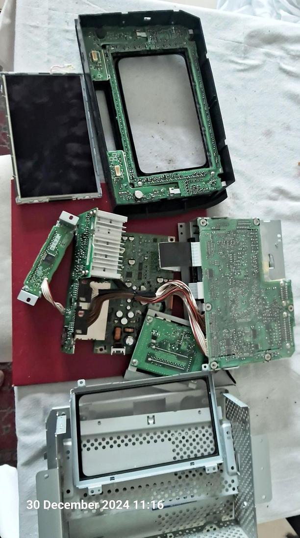

Dec 30, 2024 | 12:07 AM

Meirion1, not for the first time, I suspect you were correct!
Pics show details of the 'Cold Cathode Fluorescent Lamp' you referred to and (as you described) the flickering I experienced before the final failure was attributable to the fluorescent lamp...
Reply 0
Dec 30, 2024 | 03:27 AM
As CCFL tubes age they tend to show some colour shift at lower brightness levels (tend to move into the reddish hues until they warm up).
They do become more hesitant to strike and can flicker as they draw more current from their high voltage supply to strike.
You can often replace them but it can be a very fiddly job, as more often than not you have to dismantle the LCD display to get to the embedded tube(s).
They vary in size, shape and diameter, so you generally have to reveal the original to take the relevant measurements to order a replacement.
They also often have very tiny clear o-ring spacers along the original tube that need to be transferred to the new one.
The high voltage wires are soldered onto the tubes but covered by a silicon boot that also needs to be preserved and reused.
The good news is the tubes are generally still available and are usually pretty cheap.

Dec 31, 2024 | 02:09 AM
Having dismantled it that far, you could just swap out the entire LCD panel from a donor unit if you can find one.
As long as the part number on the panel is the same it should be a straight swap.
