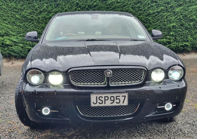

Hi Clubairth1,
The technology and design of LED bulbs to replace halogen is improving all the time. The latest LEDs have very small emissive area and produce a good beam. Some of the LED bulbs have shaped housings to prevent errant light output that can cause dazzle. The worst offenders for dazzle are aftermarket HID conversions. They produce chromatic effects that give lights a purple halo that can appear like blue police lights. We don't want that!
I have LEDs for my H7 high beams and they produce a good spread of white light. I'm not concerned about dazzling drivers, because they're high beams and are off when there is anyone in front.
I have also recently fitted HID-compatible LEDs to my low beams and they have better light output than my HID bulbs, and the beam cutoff is identical as it is produced mechanically by a shutter.. The only way to detect that they are not HIDs is to watch the startup, as they are instant, unlike the HID bulbs which take a second to strike.
Some jurisdictions are more pedantic about unauthorized changes to lighting components, but my lighting setup has never been failed or questioned during annual safety inspection here in New Zealand.
Pete M
Full LED front lights. High, low, park, fog, angel eyes and grille insert.

Pete these look great and exactly what I was thinking of. How did you source the right ones for the car? Are all 4 of the low beams of the same bulb type? Lastly did you swap them out yourself?

Hi JagNYC,
The outer headlights can be of two types. In some countries and on some models they were H7 Halogen, the same as the inner (High Beam) lights. These look very similar to the inner lights. In other countries and on some models, the outer (Low or Dip Beam) are HID, with projector lights. The HID lights are what is on my car.
The HID lights are very good and don't really need to be improved. The inner (High Beam) lights were H7 halogen on all models. If the HID low beams are fitted, the halogen high beams look yellow in comparison.
Depending on how strict the compliance regime is in NYC, there are a number of improvements. Sticking with the standard halogen bulbs, some people have recommended Osram Night Breakers, and there are a number of threads about alternative H7 halogen bulbs.
If you're up for a bit of rule-breaking, there are lots of LED alternatives for H7 bulbs (Sorry Thomas!). I have tried a few from China, but at the moment I have a set from Narva which are the best so far. It is really important to check the alignment of your headlights, especially if you fit a LED alternative. Mine don't seem to generate any negative attention from oncoming drivers. A few years back, before LEDs, aftermarket HID kits were the thing, and they usually had really bad fringing effects with purple halo rainbow flashes. They seem to have been mostly superseded by LEDs which are now fitted to most new cars, and don't seem to exhibit any fringes or halos.
I have changed all my headlight bulbs myself, and it is certainly a fiddly job. A small mirror and a head torch really helps to see what you are doing. Note that it is possible to fit an H7 bulb upside down, but you can usually see in from the front if it is correctly fitted.
As a last resort, the headlight unit can be removed from the car. It isn't necessary to completely remove the front bumper. This can be done one side at a time too. Remove the grille and disconnect the push fitting between the headlights. Pull the bumper side outwards where it joins the fender on the side. A spray of WD-40 into the join can make it easier to remove. There are three formed loops that click into a plastic fitting. Then the bumper will sag down at the front, and you can access the two 10mm bolts at the bottom and one at the top to remove the light unit. Getting the light out of the wing is a bit of a puzzle, but just keep trying different angles until it comes out. There is an electrical connector with a red locking tab that you pull first.
The light units, if they are halogen/halogen, could benefit from cleaning any dust or haze from the inside of the glass with a soft cloth. I wouldn't touch the reflectors. If you have HID/halogen units, the HID projector is removable with 4 screws. The projector lens can be cleaned on both sides, but again, don't touch the reflector.

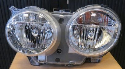

Coming back to the general topic, and to whether the car has halogen or HID lights: apart from Pete's explanation about how the headlights look in one case and the other, you can look on the headlightd from the front of the car. In case of HID lights, you will see a "D1S" engraved on the outer side of transparent plastic, and in case of halogens, it should read "H7". On the inner side, towards the radiator grill, you will always see "H7" engraved, as the high beams are always halogen, as stated by Pete.
Here's pictures of the different types of Headlights, you can clearly see the difference:
HID:
Halogen:
You can see that the halogen lights do not have the focussing lense of the HID lights.

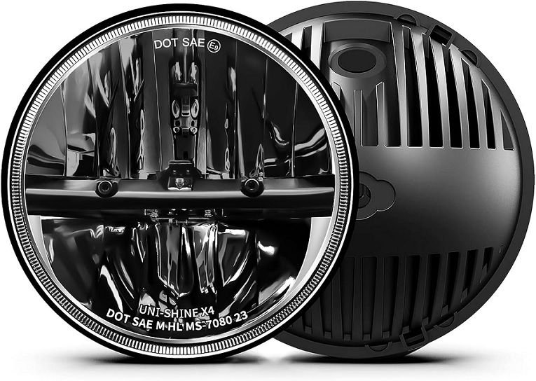

Do what you want but LED bulb's put in a non-LED reflector will not have the correct beam pattern. This is why government regulators have the rules they do. In the US we have the same legislation but it's rarely checked by the inspectors.
Now the correct way to add DOT approved LED headlights is to replace the entire unit. Many of these are out now and for us classic car guys this a great mod!
7 7" LED Head Light
What the problem we have is all the modern cars have different head light designs so no standards like years ago with 5" or 7" round and eventually rectangular head lights. These sealed beam LED's are made correctly and make a wonderful difference compared to the old dim Halogen setups. Plus only $100 for a pair!
Do check as Thomas-S advised above to determine which setup your car has.

Even the lights shown by clubairth1 are definitely not an option here, as sealed beams are not allowed in Germany, I would be curious about how you would technically fit such lights to our cars, as the headlight units in the Jag comprie low beam, high beam, position light, and indicator, and you would have to dismantle and reassemble them completely.
I would have thought that they would only be a replacement for cars with the round lights that were standard once upon a time.
Independantly on whether your car has halogens or HIDs, my suggestion would be to first replace the bulbs with new quality ones and to check the correct alignment of the headlights, as it is easy to accomplish and not so costly and sometimes the difference is amazing.
Only if that does not bring the desired result, I would think about the other options.

Thomas-S is right. What I posted won't work on a modern Jaguar. But in the US many old cars came with 5" or 7" round sealed beam head lights. I am sure older Jaguars as well. So these modern LED sealed beams are DOT approved as a replacement for OEM. Plus they do work very well and it's real easy to swap a sealed beam unit.
