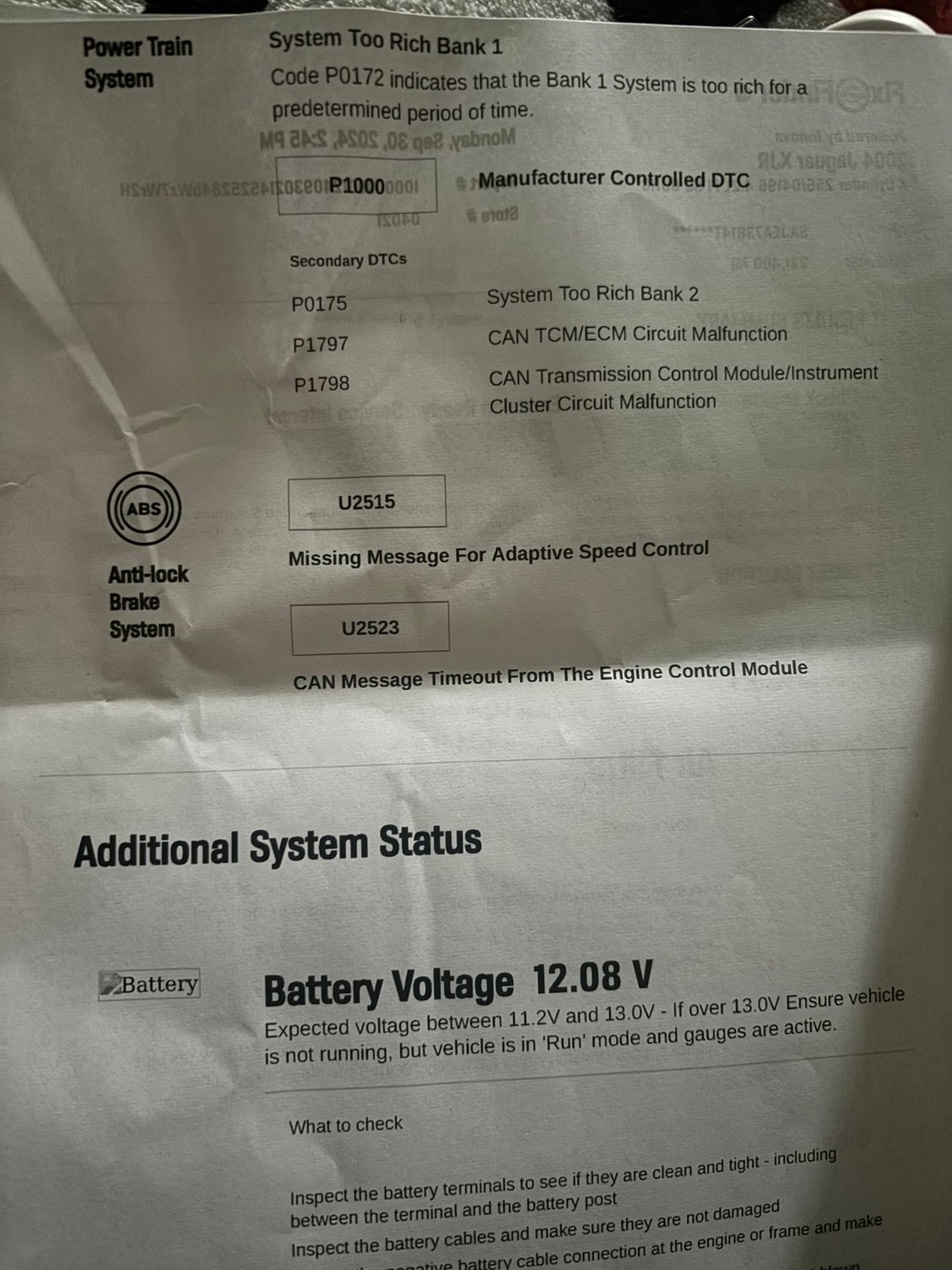

The owner told me to change both 02 sensors then it would pass smog. Then I took it to a shop they said it’s leaking air in the back of the engine. Give him 1000 bucks and he’ll fix it so idk what to do honestly. Any ideas guys? The air filter is fine doesn’t look to dirty. I appreciate any feedback. I just wanna be able to smog the car….

Anyone else notice that the stated battery voltage on that printout was only at 12.08 volts.
X350/X358 do not like such low battery voltages, as it plays head games with their systems and may make them throw spurious codes as a result.
Suggest rechecking battery voltage to make sure you don't have a weak battery, or a potential charging deficiency due to an alternator fault.
Charge battery up to see if it settles to a decent 12.6 volt level or slightly above.

"12.08 V"..."
- Replace your battery. Suggest Exide from Home Depot, as it is cheap and good, having higher surface voltage than similar batteries.
