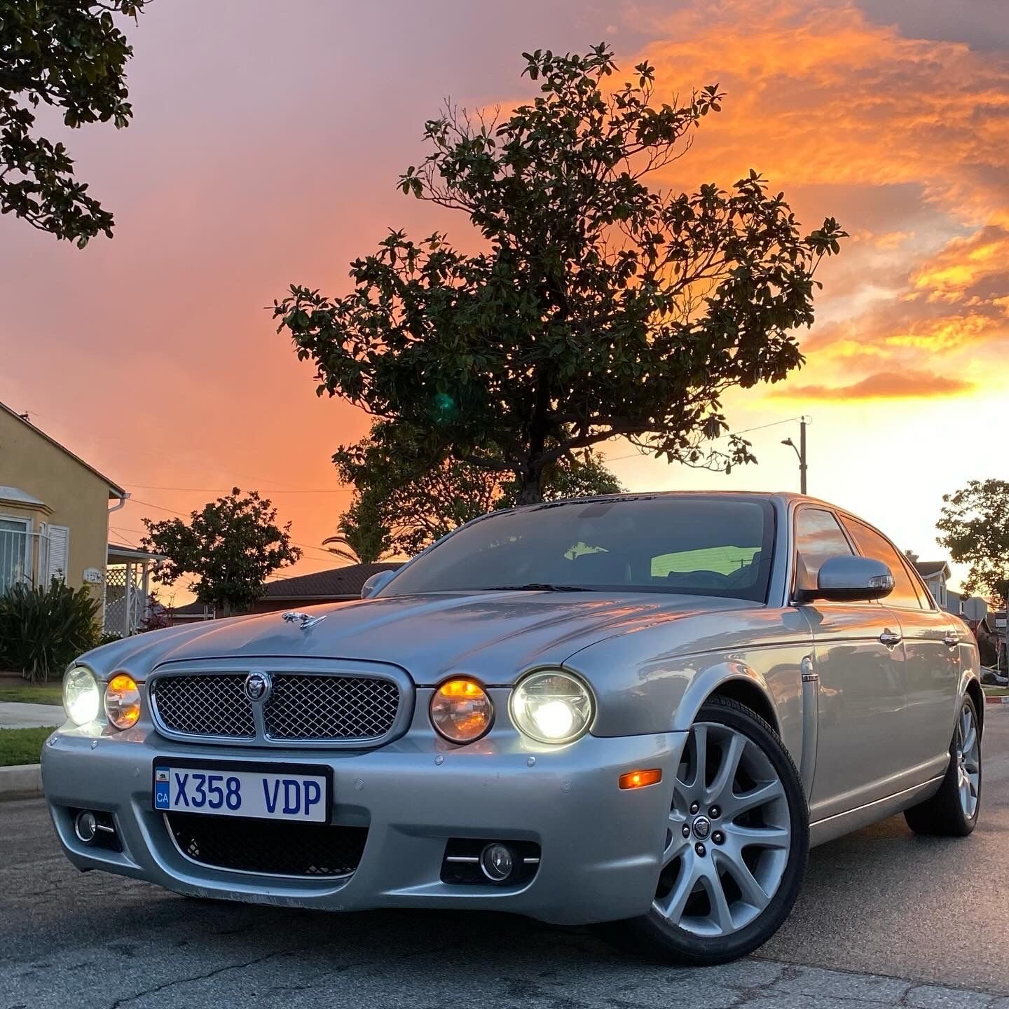

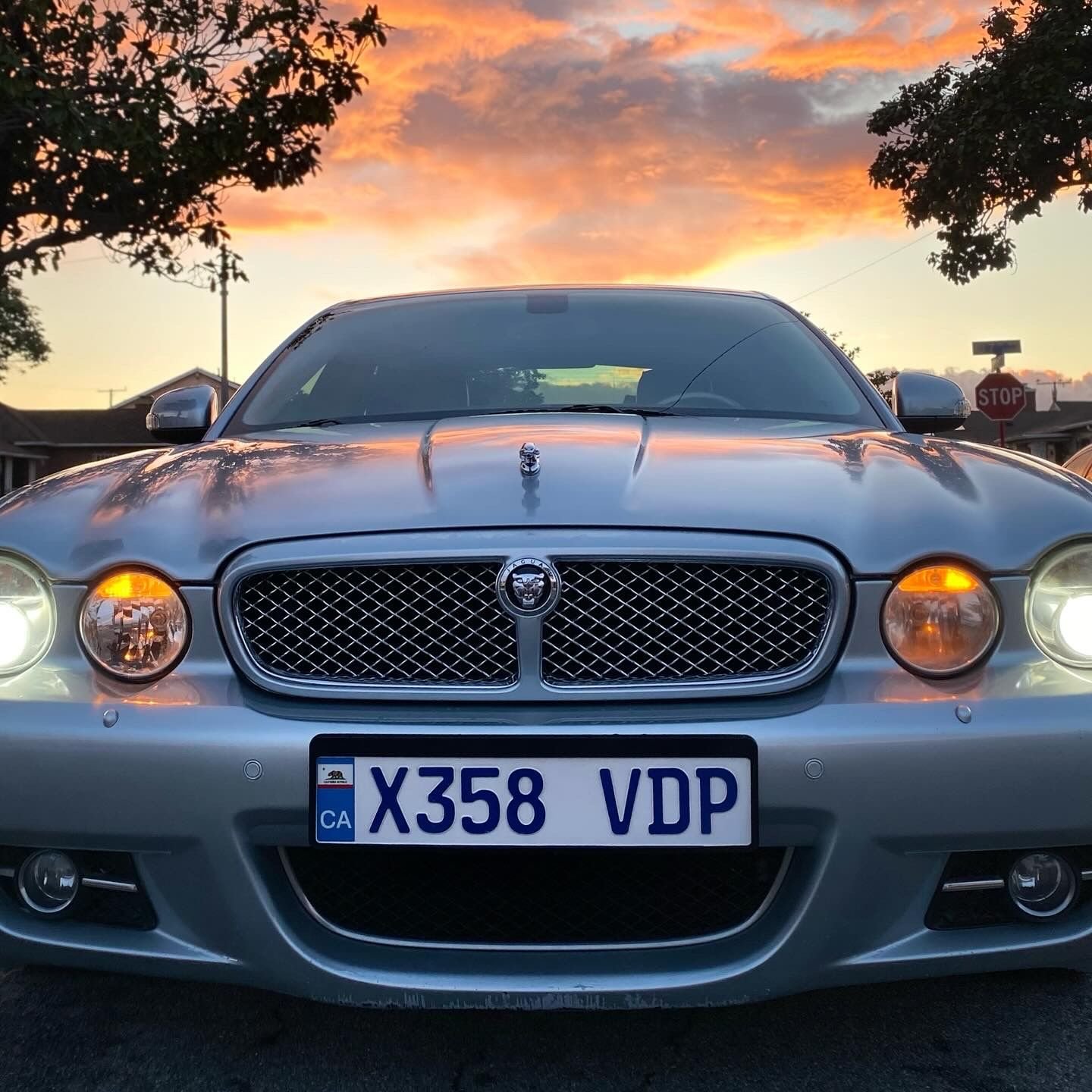

First off, great choice in vehicle. These cars are very durable and although hefty on the wallet when it’s time for some repairs, an independent Jaguar tech can make owning one a much needed delight in life.
The main thing is to always try your best to get any Jag with maintenance records. That will give you a good idea of previous ownership care and overall love for the car. I never trust anyone that says they’ve done “this and that” or “I got 4K worth of work on it recently” without proof. No exceptions.
Once you find the right one, take care of the most common “new owner” maintenance:
Oil/Filter
Cabin/Air Filter
Spark Plugs
Serpentine Belt
Transmission Filter and Fluid Service
Inspect Brakes
Inspect Cooling System and Hoses (esp T-Stat Housing)
Electrical (AC/Windows/Locks/Radio and all Lights)
Inspect Suspension Components (Sway Bar Bushings/Thrust Arms/Links/Air Compressor/Air Shocks)
The above is my list of things to do with just about any car I purchase. And I have not had any significant issues failures with my Jags following those steps without fail. The worst thing to have happened to my current XJ8L is Air Compressor failure which was cheap and easy replace. Was back on the road in 1.5 days. Air Suspension might the worst issue in these cars. The 4.2L V8 is perfect and durable. The Transmission is silky smooth and does the real hauling on the highway so you maintain great gas mileage for such a heavy car. Just make sure you keep it properly maintained at all times.
Youll be pleasantly surprised at how agile this car really is. It is in my humble and honest opinion:
The perfect Jaguar Saloon!
Lastly, I recommend that you go after the X358 version (2007-2009) over the X350 (2004-2006). Compare the two via Google and you’ll see what I mean. XJRs are great in any year so X358 & X350 are worth it for XJR versions. Happy Hunting!
If the air suspension it came with has been replaced with coilover struts, that is not necessarily a Bad Thing, and certainly not a dealbreaker. The air suspension is way past its design lifetime, and if not working properly can be very expensive to put right. I bought my XJ8 in December 2020, almost immediately had problems with the car dropping, warnings on the dash, and of course NONE of this happened on my rather lengthy test drive, which was after he owner brought the car several miles for me to see. I eventually gave up and ordered coilovers, and could not be happier. I don't have to wait for it to raise itself in the mornings, I can drive it for hours and hours without having to stop because the car is lowering itself after shutting off the air system, and it actually rides better than it did with the air troubles.
Another car I looked at had already had the swap done, and not knowing any better, I rejected that car, which I rather regret doing now. (Although that other car was not the long-wheelbase like I have, which I rather like!)
