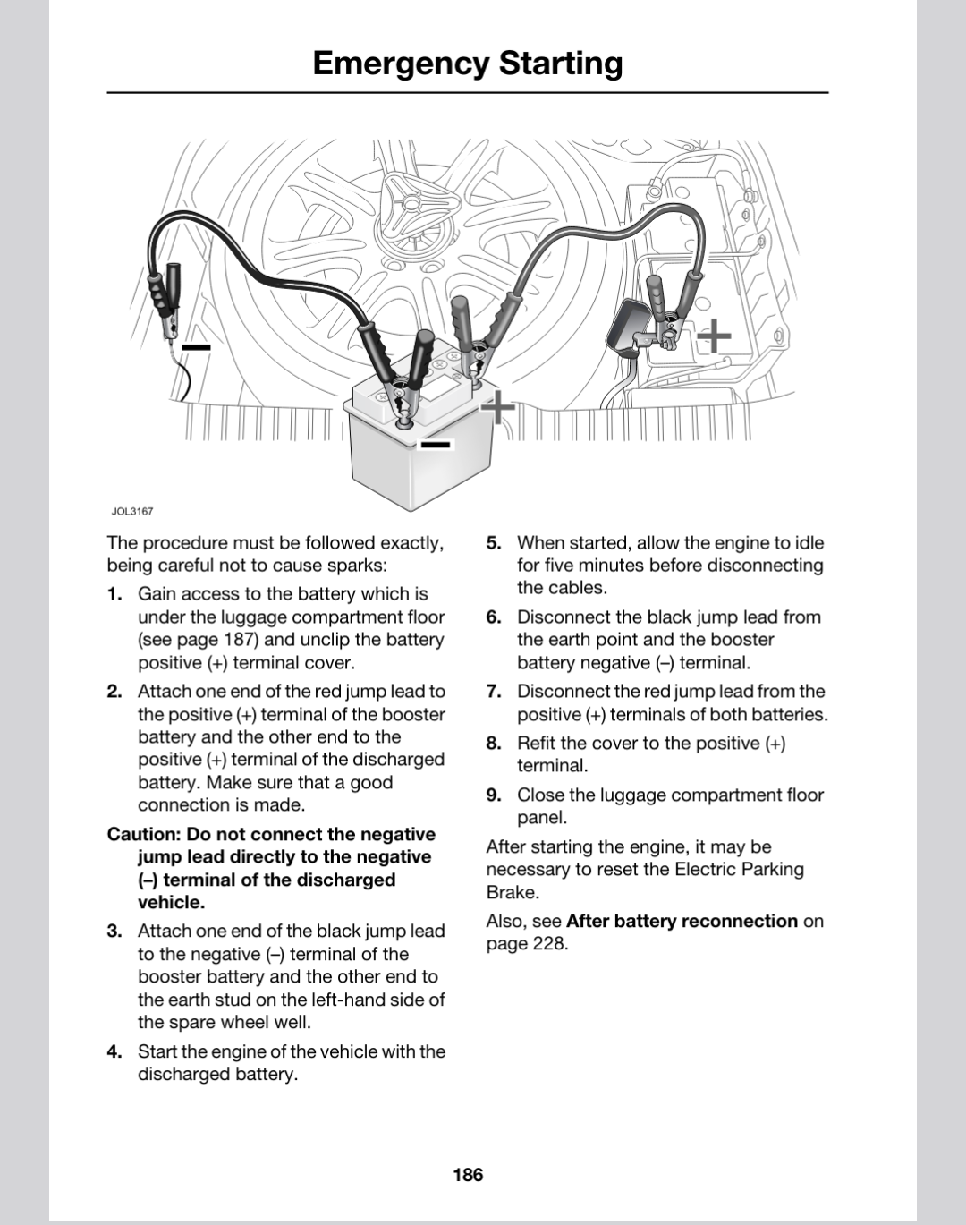

hello kind experts,
I am forgetting... how do i jump/charge the battery from under the hood ?

Took a quick look at the owners manual, there's no mention of jumper terminals at the front, you'll need access to the trunk. Even with a dead car you can still use the physical key on the trunk's lock, it's just tough to see from above.

The keyhole for the luggage compartment (boot/trunk) is well hidden.
Insert key in #3 and turn

  • If the manual lock has not been used for a long time you may need to use wd40 or similar to gently get the key to turn, careful to not overdo it and break the key !

Press down on boot lid when turning the key
