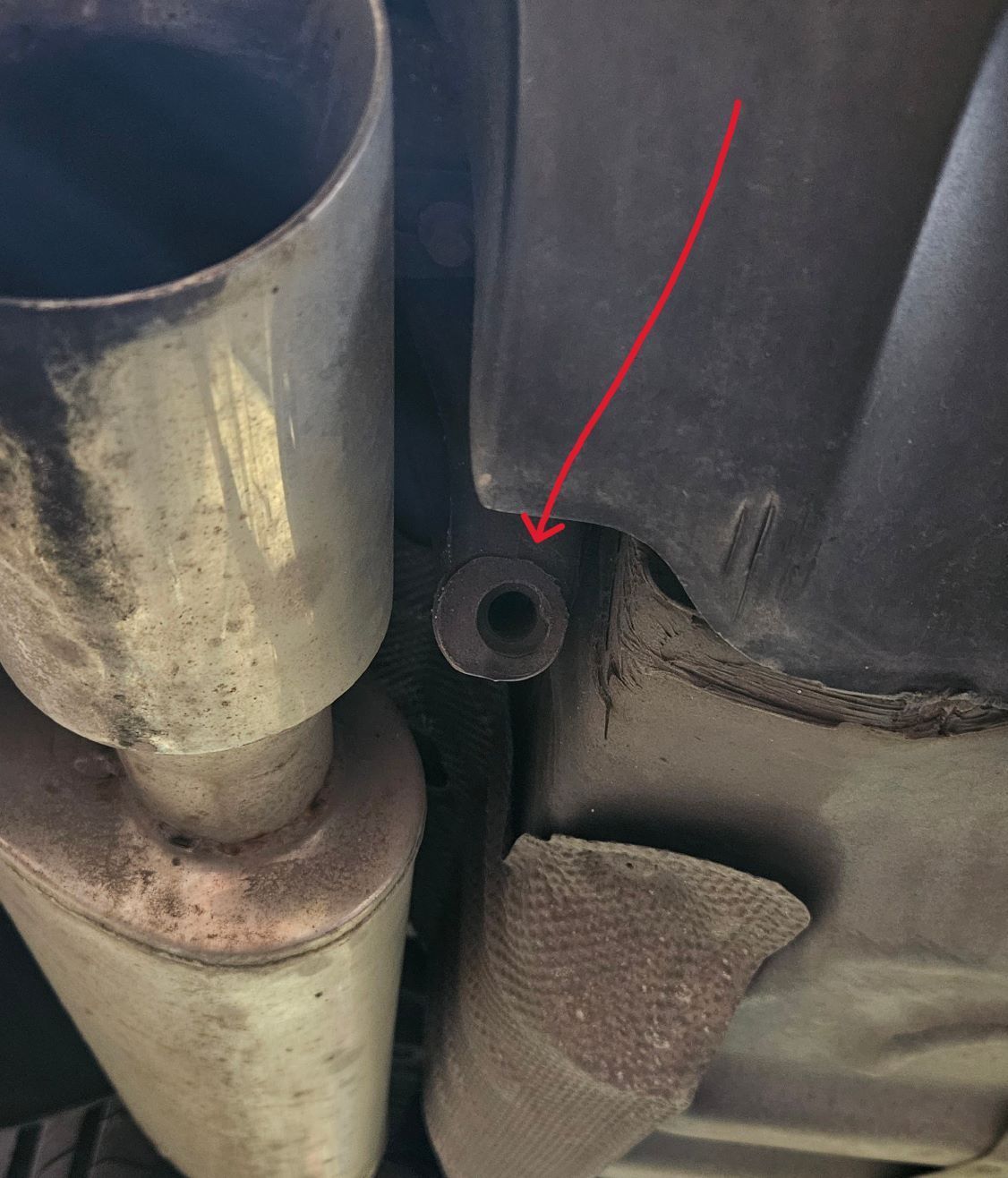

Default A hose outlet next to the left-side exhaust pipe
What is this thing, please? And is that normal that there is none on the opposite side of the car? (I.e. there is none next to the right-side exhaust pipe.)

If I remember correctly, that's not a hose outlet. It is the place to screw in the towing eyelet that should be part of the toolkit of the car. If I am correct, you should see the internal thread if you look with a torch.

Thank you, you are correct again!
Page 196 of the Owner's Manual:

The towing loop attachment holes are see-through holes. They are easy to spray it with a solvent such as carburator cleaner, then turn a cheap bottle brush around in them to clean the screw threads - note they are left-handed screws.
More importantly, do this in the front as well, that's YOUR emergency.
Finally, pack the holes with water-proof vaseline (buy a cheap outboard marine tube) and push in a cork or plug. Front lower grille (X358) comes off top first.
You'll thank yourself later.
