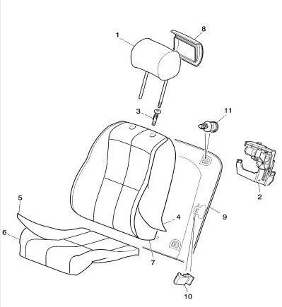

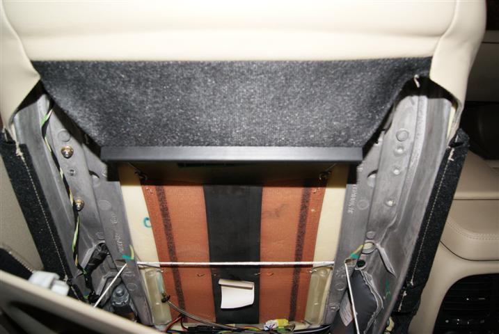

Please see the following diagram. And here's one with a removed seatback...
If I remember correctly, start at upper corner of the seatback and pull, pull, pull until the plastic fastener (#11 in diagram) gives way. Then move to the other upper corner and repeat.

Yep according to JTIS just pull at the top of the seat back.
