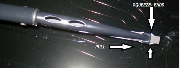

This vintage Jaguar has very complex windshield wipers. The wiper blade assembly has the washer spray nozzle integrated into it, the drivers-side has an air-foil attached and they are two different lengths. Also you can not lift the arms very high when servicing them. Factory is the only option, since generic wiper blade replacements will not work.

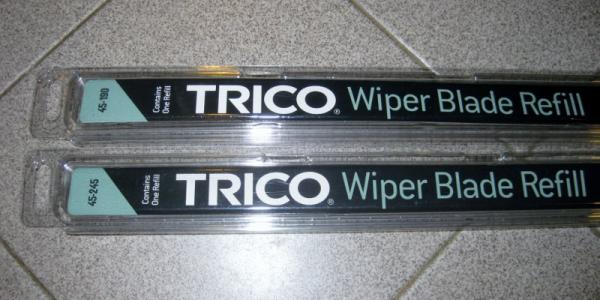

The simple solution is to just replace the blades. They are manufactured by TRICO and sold at O'Reilly for about $15.00 total.
TRICO refill part numbers: 45-190 and 45-245 @ $6.99 each.
Link to O'Reilly Auto Parts: http://www.oreillyauto.com/site/c/se...04&make=Jaguar
They are two different lengths. The longer fits the drivers-side.
Replacement is simple. Locate the tip of the old blade where the stainless steel "Barb's" are visible. Carefully take a pliers and squeeze them together while pulling away. This should release the blade and it can be pulled out easily.
Now on the new refill, there are (3) black plastic retainers that temporarily hold the stainless steel strips into the sides of the rubber blade prior to installation. These slide down and are discarded as you thread the new blade onto the wiper.
Easy low cost fix. Works great. Good luck.

Just for clarity's sake, the URL for O'Reilly is http://www.oreillyauto.com. If you Google "oreilly", the first site that comes up is actually NAPA Auto Parts, and the 45-190/45-245 stock numbers either don't exist or point to completely different parts!
Thanks!

Just for clarity's sake, the URL for O'Reilly is Home Page | O'Reilly Auto Parts. If you Google "oreilly", the first site that comes up is actually NAPA Auto Parts, and the 45-190/45-245 stock numbers either don't exist or point to completely different parts!
Thanks!
Scott,
The part numbers listed are the valid ZICO manufacturers part numbers visible in the first photo on the packaging, not the vendors UPC. I added a direct link to the O'Reilly Auto Part page showing the exact blades for future reference of Forum members. Finally beautiful weather has returned to Wisconsin. Have a great day.

I've been looking for replacement blades for my 04 XJ8. I printed edbernig's photo of the two blades together and took it to my local O'Reilly Auto Parts store. There were several versions of Trico blades on the display but not the one in the photo. And the self-service gizmo where you look up your own blades called for a RainX blade.
I took the photo to the counter and asked about them. They did indeed have them in stock. $6.29 per blade (same price for 19" and 24 1/2") and very easy to install. They work great.
