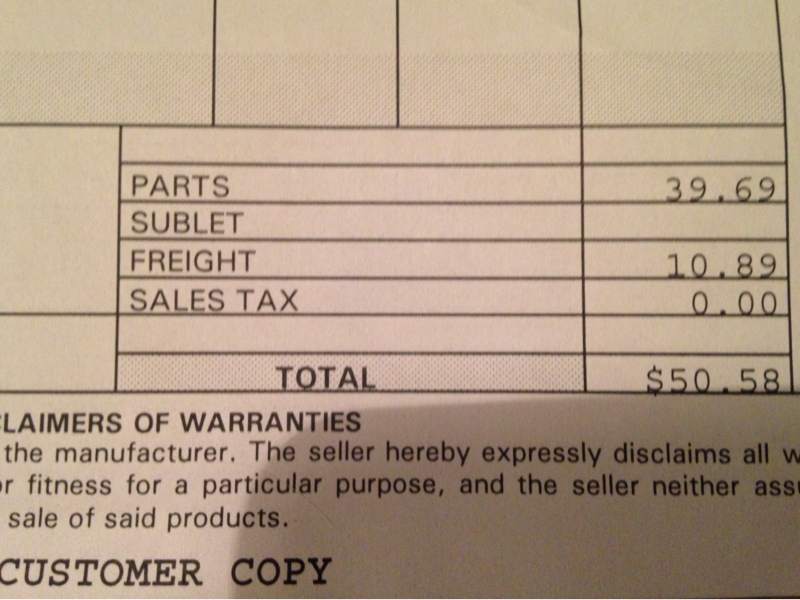

I Need Help With Power Steering Hose on 2004 XJR-image-4092266125.jpg I Need Help With Power Steering Hose on 2004 XJR-image-2545091399.jpg I Need Help With Power Steering Hose on 2004 XJR-image-1229897912.jpg
In locating ps leak, I replaced the pictured hose with jag part c2c6157; see number.
The leak turned out to be with ps pump. Replaced and no trouble since.
Thanks -mag
$39...???
I can't believe my lying eyes.
Where did you buy it for that price?
Anyway, given that your problem happened to be pump, is there any chance you still have that hose
or probably still in good condition the old one?
