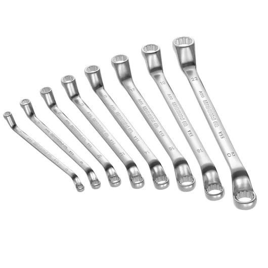

There are also several types of tools for confined spaces.
Offset ring spanners, swivel ratchet spanners, and double socket spanners.
Some photos below as examples.
double socket swivel spanner
double offset ring spanner set
double offset ring spanners

Thanks for these suggestions! I will look into some new wrenches. I think the kind like the last style posted would work great. I went back out to the car and had another go with it. I found the bracket holding the metal line and took loose the bolts that secure it. It gave me some wiggle room but not nearly as much as I needed to use a socket. Now if I get a wrench that lets me get the idler bolt loose I might still have a challenge getting the bolt all the way out. That line might block me and even if I’m able to bend it enough to get it out it might be hard to get it back in.

Got the job done today. It was punishment for my forearms and hands. The offset wrench helped me break the bolt loose. Then I used a flex head, ratcheting wrench once the bolt was out far enough. Then to deal with the metal line, I took the bracket bolts loose and used a piece of wood that I cut that looks like a doorstop, and I wedged that in between the line and the crank pulley till I had enough clearance to get the bolt all the way out. The old idler looked like it had seen better days with 102k miles on it.
