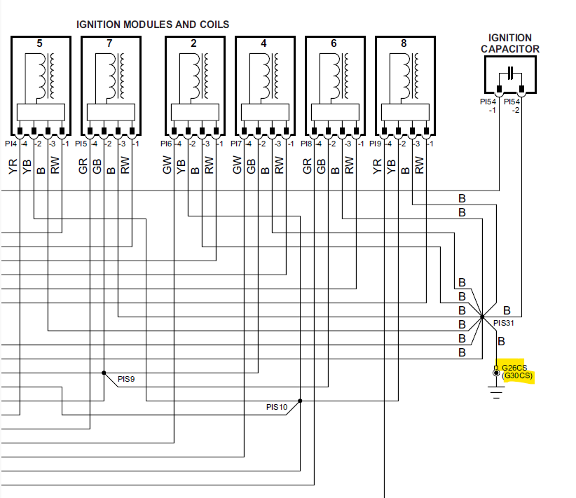

Dear Forum,
My ignition coils were replaced with OEM new 26,000 kilometers ago. Recently, I have had Restricted Performance flash up, (together with the resultant engine stumble), then disappear within seconds? This only happens at idle?
Codes have been firstly P0356 for coil 6, then P0358 for coil 8. I don't think the problem is the coils; could it be a poor ground?
Please, can anyone tell me where I find this ground point:

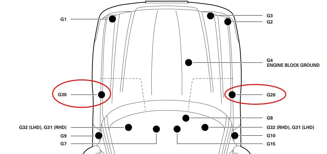

Hi EsRay
Here is the pic of the grounds. I think it is either 26 or 30 depending on LHD or RHD.
Pete M
Ignition coil earthing

Originally Posted by Pete M
Hi EsRay
Pete M
Thanks
