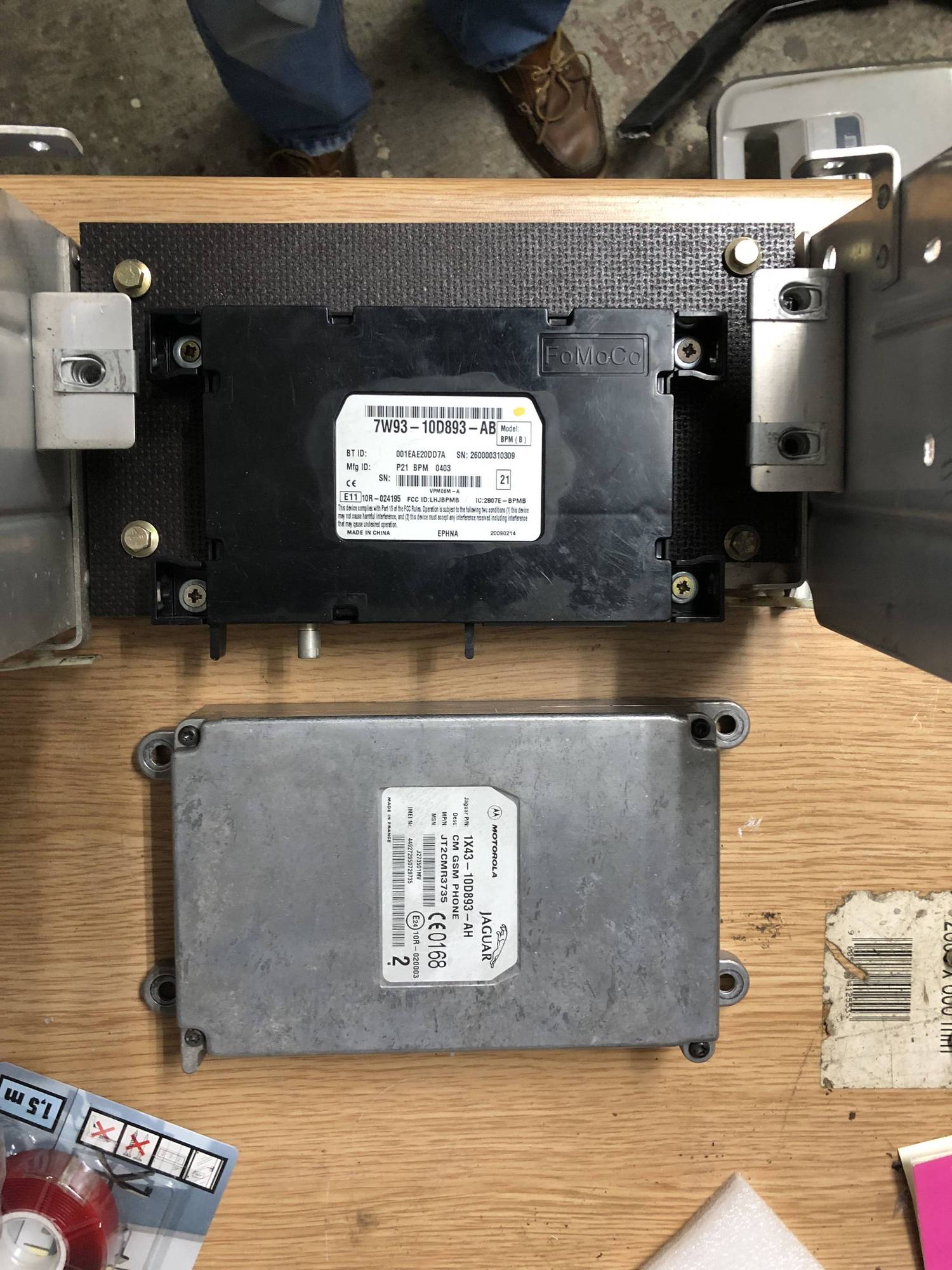

There are different versions of the factory bluetooth system. Only the latest one is supposed to work fine.
As my car did not have bluetooth I retrofitted this version and there are no problems with my iphone 8. I have not tried out later versions yet.
The module number of the latest version should be 7W93-10D893-AB. It is located behind the left trunk cover, underneath the navigation module.

Thanks for your reply Thomas. It looks like this part number is for the x type judging by eBay listings. Is it also compatible with the XJ? I thought the module part number ending in AC was for the XJ.

The part no. I gave you is correct, I remembered that I took pictures when I retrofitted bluetooth to my SV8, as my car is from Sept. 2003 and did not yet have bluetooth, only the integrated one that needed a separate SIM card.
So yes, it fits the XJ.
