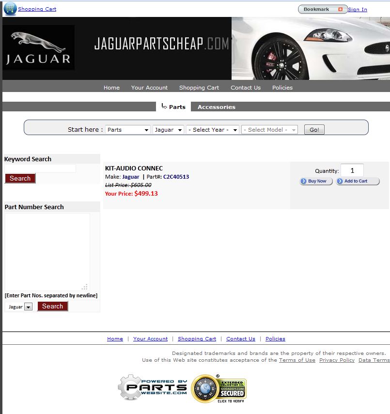

Brian, this module gets placed inline of the CD-changer just behind the head unit. There is a separate box that has a switch on it that allows you to select either the CD-changer as the source, or one of the three (3) inputs into the module (USB, RCA, or Ipod). The intrface still looks like the CD changer in all respects, except the discs themselves and the operations of the << and >> are different.
I'm sorry they're out Rob. I checked my receipts, and I bought mine in Oct 2012 for $340.
I used Jaguar of Novi, Michigan's online database, and found their ACM price to be $499. Give it a shot?
