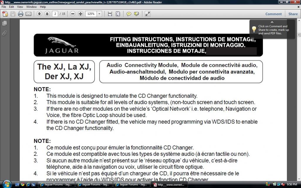

In the ACM's fitting guide page 2, it states in vehicles without the cd changer, adding an ACM 'may' require programming the radio to recognize changer (ACM).
Anyone have experience with the situation of adding an ACM in a non-cd-changer vehicle? I don't know if it matters, but the car does have navigation.
-or-
Anyone want to lay odds on the probability of needing WDS/IDS programming for the radio to 'see' the ACM?
see attached item 4.
thanks-
magmedia
-or-
thanks-
magmedia
If you have a 2008 or newer XJ I would say the ACM should work without any need for reprogramming. The programming is only for the head unit to recognise a CD changer, not an ACM in particular. 2008 and later xjs never got shipped with CD changers as standard, because Jag presumed everyone would fit the ACM (so why they did not do it themselves who knows?), so I presume they at least had the radios programmed to work with the ACM. My ACM worked straight away.
Prior to installing it, I spoke with my local jag dealer about the cost of reprogramming the radio for the ACM. They said they have never heard of any need for this to be done and said it should work straight away. I'd be inclined to think this is the case in all jags (x-type,s-type,xj that uses the same ACM), because I do not see any advantage for jaguar in having differnent programming for whether you have a CD changer fitted or not.
