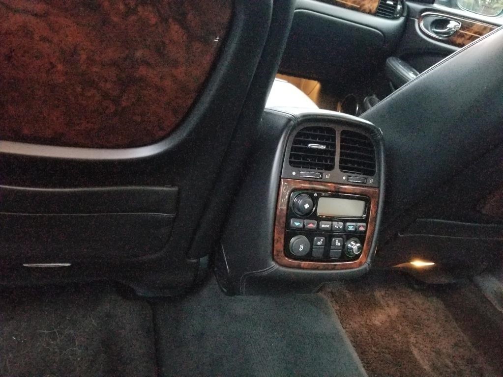

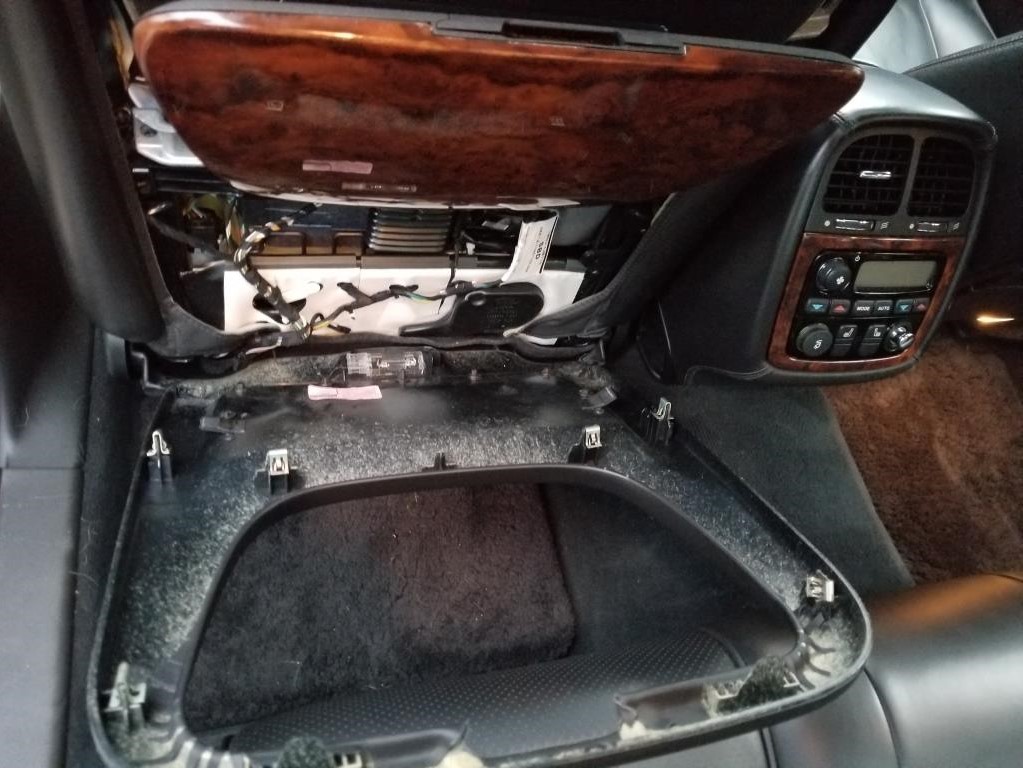

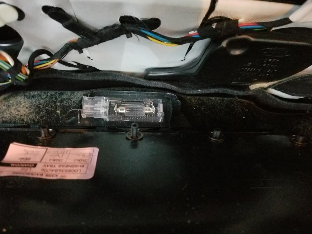

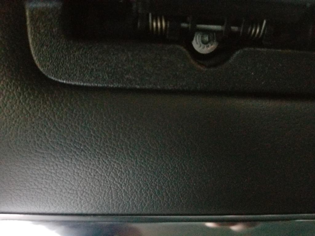

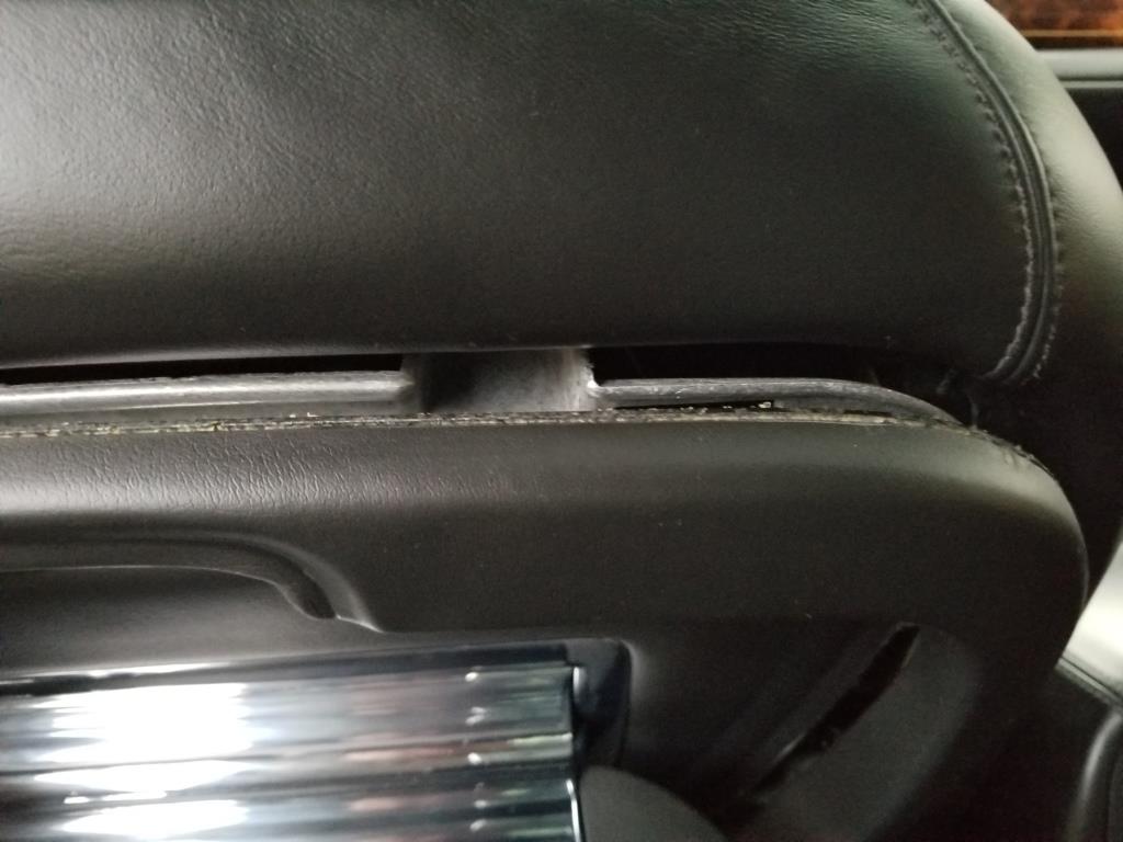

Hi Aix - the short answer is yes, you need to get to them from the back side of the covers, but luckily it is fairly easy to do. If you don't have the tea/picnic/laptop trays, it's one step easier! In my case, one of the lights was burned out, or so I thought.
If you do have the trays, remove the release latch first. There is an Allen head screw under the latch that removes it. Next, remove the seat back by prying it away and releasing the spring clips, there are six in all. Then lower the seat back down, and you will then be able to access the bulb and housing. I discovered that someone had been into my seat at some point before. The spring clips were not fully seated, and one clip was 90 degrees off. The big thing was the wiring was disconnected from the light. Always nice to be able to fix a problem with no parts required. There may also be a way to release the bottom catches to get the seat back completely removed, but I couldn't easily figure out how, and I didn't find it necessary for what I needed to do. I hope this helps.

Thanks a lot for this documentation!
The car doesn't have trays, so I can just pry them of.
I broke to much plastic in cars over the years by trying that, but now that I know that this is the correct way ...

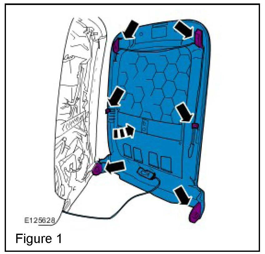

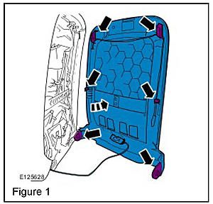

Well, I went out and took another look at mine, and I could not get it to move to the right. In looking at a higher res version of the photos I took, I can see a spring clip on the right, but it would not move far enough to clear the electrical connection on the left side. The only instructions that I have found on removing the light were contained in a TSB for the rear seat blower motor, and those involved removing the seat back cover, then disconnecting the wire. Not sure if this is something unique to the X358 or not, but I was just sharing my experience. I've attached a photo from the bulletin.

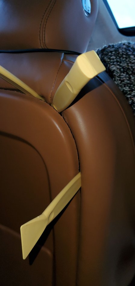

Are the top friction clubs supposed to be super hard? I've been trying for a bit and can't get it. Pulling somewhat hard but it just feels like if I try harder it'll break? Maybe I'm just being scary but someone let me know please
( side ones eere tiny ones and came off really easy. )
