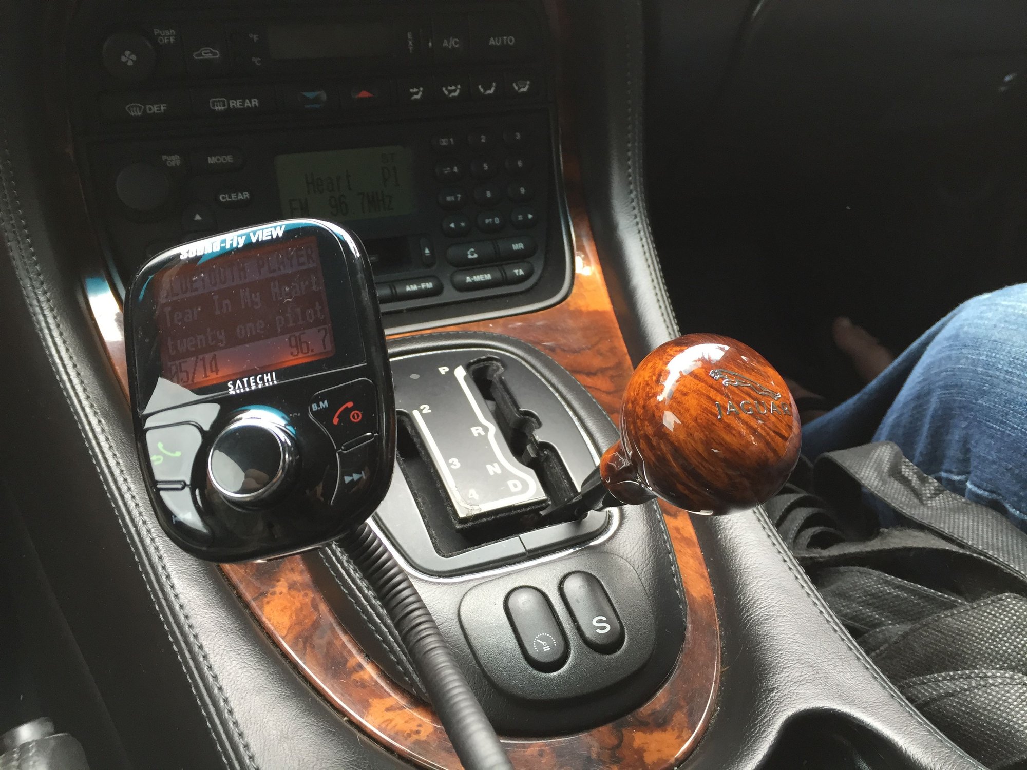

Shopped around and tried 3 BT/FM units. The one I like best is the SoundFly View. It was the most expensive, but is feature rich and is built well. I got the genuine Satechi version. (There are Chinese Knockoffs for much less.) Very satisfied. I hold all my contacts, makes phone calls right out of the unit. No need for me to ever get my Iphone6 out of my pocket! (not as good as the 2015 XF I drove while my '00 VDP was in the shop however.). Plays my music library brilliantly.
Satechi SoundFly in my '00 VDP.

I just purchased a Nulaxy KM28 and VicSing FM-Bluetooth units for my prebluetooth era 1994 XJS and 1999 XJ8 rides
because the Law concerning "hands free" cell phone use pretty much requires it. That is if you are inclined
to use a cell phone while driving a Jaguar . . . a questionable practice.
Any way both of those products connect to the Jags via the 12vdc power outlet (us retrominded senior citizens
call them cigar/cigarette lighters).
They are on the end of a 6 - 8" flexible stalk which can be bent for the best viewing angle. They offer multple
USB connections for charging USB devices and connecting USB memory devices and SD memory cards along
with direct audio plug between the media devices and control unit
for playback of WMA/MPG3/4 files using the Jags FM radio stereo sound system.
The units also connect to a variety of Bluetooth smartphones and media playback devices.
The smartphone calls use the microphone built into control units and the car radio speakers.
Both units have a very nice playback of the music and phone calls.
Best part of all - NO WIRING required !
Just plug them in and power on your radio and find a quiet FM spot (87.9MHZ here in the Atlanta, GA area)
to tune the FM radio and the media control unit .
Apparently there have been some upgrades to the FM channels that improve the data transfers between
the media control units and the FM radios. Very nice sound and little if any background noise if the
best FM channel is used.
The units will find your smartphones via bluetooth and ask to pair with them.
Only downside, you have to be tuned to the FM channel to use the bluetooth adapter for phone calls.
I have a preset channel button for the devices so if I happen to be listening to a different radio station and
a phone call comes in, I just select the radio channel preset button and then hit the accept button on control unit.
I get to use the Jaguar built-in tape player/cd changer/AM-FM radio with no expensive modifications to the
vehicles and add a Bluetooth connectivity to beautiful Jaguars.
These FM -Bluetooth devices really work nice and don't cost a lot for us Jaguar owners who have to pay
for other expensive stuff like insurance, petrol, taxes, and gut sucking maintenance inspections and repairs.
Press On Regardless and Happy Trails
Bob
