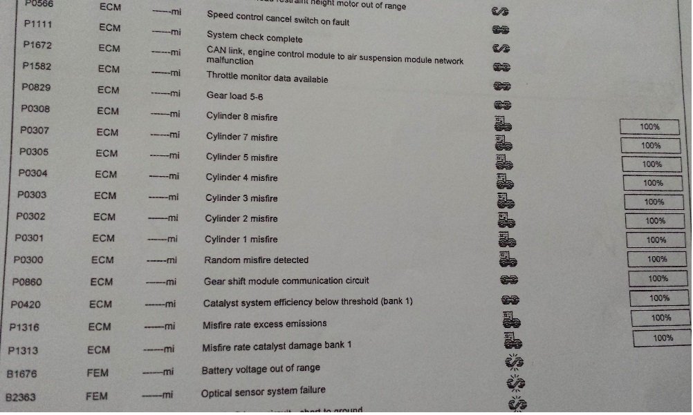

I stopped by my local AutoZone this afternoon to talk with my knowledgeable friends there about the diagnostic report I got from Jaguar. Take a look at it and see what you think. Why would 7 of the injectors be clogged? Is it more likely an exhaust issue (cat or oxygen sensor) that's giving problematic readings to the PCM? Maybe it'll make sense to you or someone else reading this thread. If you click on the image it will be big enough for you to read the detail.

What's prompting me to explore cleaning the injectors is that I have an engine light that's throwing P0420, right bank cat. So I had my Jag dealer do a diagnostic (shown in post above) that showed misfires in all but one cylinder. Their suggested fix was to replace plugs and do 3-part engine clean that included the injectors. They thought that was more likely than the cat or 02 sensors.
Take a look at the reading and see what you think. I have no performance issues that clue me in to what's going on. If the engine light weren't on I wouldn't think anything's wrong.
I'm not sure what exactly I'm looking at Mr. Beachy, I've no experience with Jaguar software - did the dealer give any advice from the tech on what it means? I will say that it seems pretty common that the jag injectors need cleaning, could almost be a regular maintenance issue.

Supposedly the 100% on the far right indicates the bulls eye faults. So 7 of the cylinders showed misfiring, along with a couple exhaust related faults. The dealer's diagnosis was plugs and upper engine cleaning, including injectors.
This morning I cleaned both oxygen sensors on the right bank. They had some carbon buildup on them. When I took it into town for a drive the engine light went off. It is stays off now I'll know it had to do with the oxygen sensors. If so I think it could still be the cat that's fouling the oxygen sensor(s). In that case I think it wouldn't have to do with injectors....
