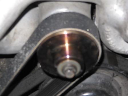

I installed a pulley from Powerhouse and the front of the pulley aligned with the end of the S/C shaft. To install this one you have to super heat the pulley and install quickly before it cools and locks onto the shaft. I used the smaller pulley so I had to machine the snout to allow the pulley to fit around it
