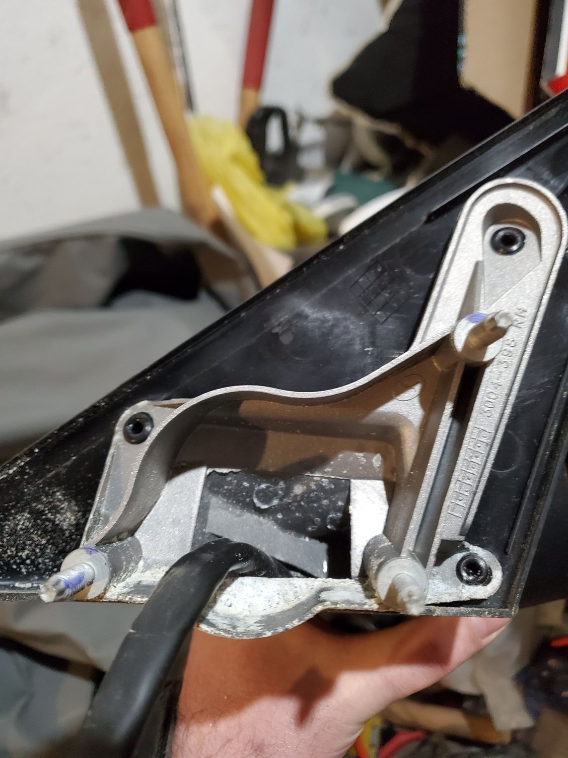

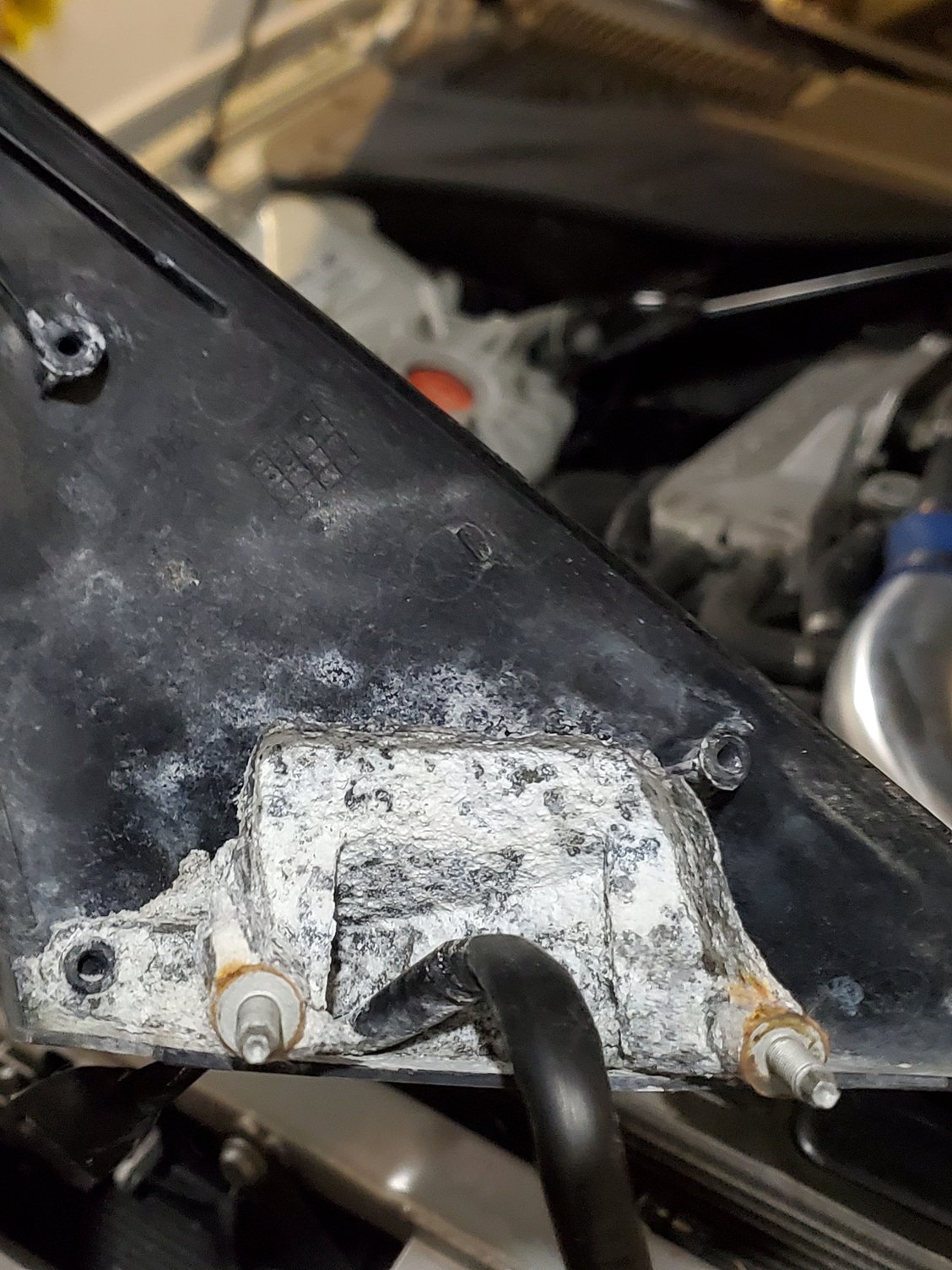

Lots of posts about bad mirrors on here. Glad you were able to fix it. Seems the major issue is some alien metal they used in the mirror mount. I changed out my mirrors today. Live in VT a fair amount of road salt. I winter the car but it was not so lucky with the PO's.
Degraded and just gone mount.
Newer mirror still starting the bad stuff at the bottom tho.
Lost some feature with new mirrors. No more motor fold. They came off xj8 but the others were rejecting the car and were just about swinging door scratchers. Some day I will get the features back but ill run these until then.
The metal comes out looking like kitty litter. Fitting. Lol
