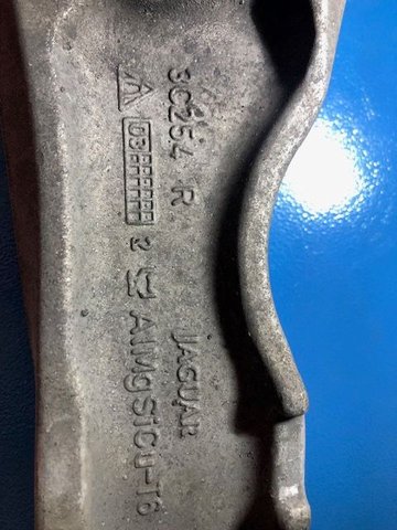

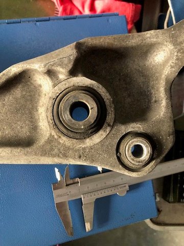

sorry about the delay, I could only take the pictures today.
Here's the pictures of one of the old lower control arms. They are the originals from 2003.
The hole for the bolt fixing the strut is about 14mm.
Now, the only thing that remains open is the pictures and measurements of the bolt and new struts. I will try to do it next weekend.

That's quite a lot of difference since the o d of my bolt is 12 mm
That could be the source of the noise without the grommet on the other end of the bolt.
Many thanks for your efforts.
