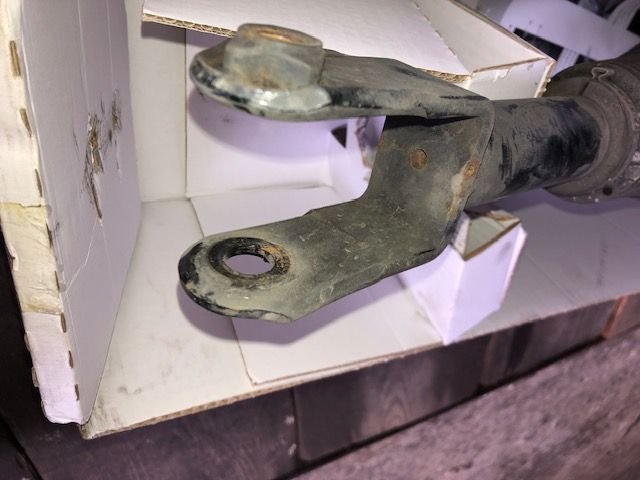

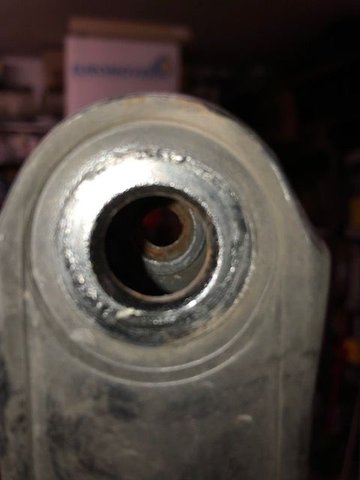

With refernce to the fork on a front strut, on one leg of the fork there is a nut welded
on the outside and one the other leg a hole to take the bolt.
The id of the nut is 12 mm but the id of the hole is 15 mm and the difference is to accomodate
a rubber grommet which isolates noise.
You can see in the photo how the hole is chamfered on the outside toprovide a fixing
for a grommet which will act like two '0' rings stuck together.
Many thanks fo your replies

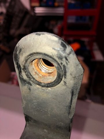

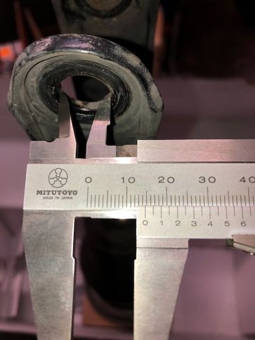

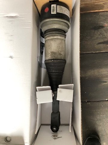

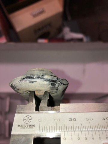

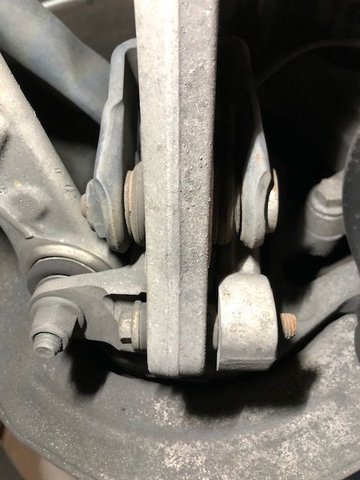

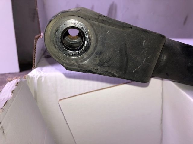

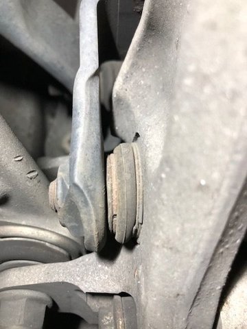

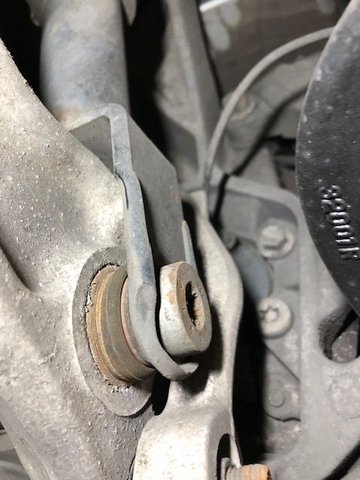

I have been to my workshop and, as I have started to do some work on my car and it is on the lift, I could take pictures of both the struts I had removed and of how the current struts are on the car.
Guess what? No grommet, either on the old struts, or on the new ones, and they are all Bilstein parts.
Adittionally, I have had a look at the Jaguar parts catalogue, the technical guide and the workshop manual, and there is no mention anywhere of such a grommet.
Thinking about it, I also came to the conclusion that technically such a grommet does not make any sense, because if it was where you state there is no noise that could be damped by such a grommet.
I have to say that it seems that the front struts have already been replaced once before I purchased the car, as they were made in 2009. Original Bilteins, also marked Jaguar, but the wrong ones for the car, as they have the red dot indicating that they are the sport ones. As an SV8, the car shoulod have the comfort ones, and the rear ones indeed were the comfort ones... go figure.
Here's the pictures I took today. The first ones show one of the old struts, and the last ones how the bottom of the new struts are bolted to the wishbone.
And here's a diagram from the techncal guide:
Maybe you will be able to post your pictures, I am really curious to see them.

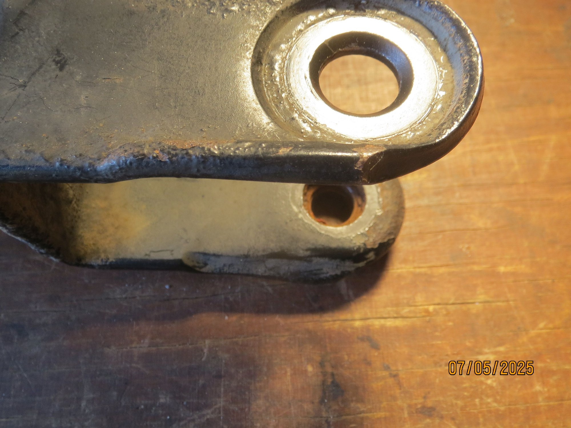

I have found one picture which was there all the time and I hope you can see it.
My VIN is 22366 so that fits in with your slightly older Jag.
So in the case of your old strut when the bolt is tightened, the inside of both
arms are touching the ? aluminium alloy bush in the lower control arm, is that correct?
If that is correct if I made the hole smaller to fit the bolt that should solve my problem?

here's the pictures that I took yesterday. Basically, the dimentions are the ones you cited.

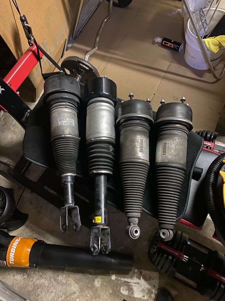

Then, there is this thread in the forum:
https://www.jaguarforums.com/forum/x...wapped-288061/
In it, Indyx358 posted the following picture:
No grommets in this picture.
