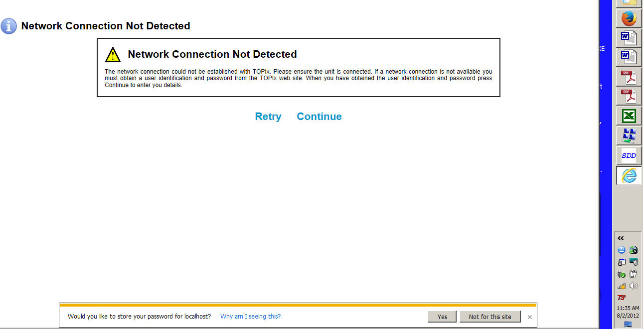

I haven't gotten as far as you did.
I uninstalled V142, downloaded V130 files, and installed V130 and its updates 1 and 2 over the last three days. There were no errors encountered during installation.
When I run the SDD program it opens IE and goes to:
http://localhost:8080/user//user/request_login.action
When I enter the user ID and password from the Offline Authentication pdf file, it either says Authentication failed because TOPix service temporarily unavailable or it just sits there with its little blue wheel turning over the word identify for hours at a time.
I tried turning off the Windows firewall but it made no difference.
Any suggestions? Anyone? This is still my Toshiba with Win7 Home Premium 64 bit OS and the SDD icon set to XP compatibility mode.

Old Sep 25, 2015 | 03:14 PM
trosty's Avatar
Joined: Sep 2013
Posts: 703
Likes: 228
From: Dallas, Texas
Did you completely remove every facet of the previous versions from your previous install. Did you clear the registry?
Did you go through every sub folder and delete every IDS, SDD, Mongoose JLR driver and their associated components prior to the new install? If you didn't, there is a good chance anything new is not going to work.
You need to turn off the firewall and any anti virus software.
Other than that, maybe a complete restore of your operating system and a clean install of the SDD V130. I've only done that procedure about 15 times now and it never gets any easier or quicker.
I freakin, hate SDD.

I tried running the SDD after disconnecting from the internet and checking for any JLR or SDD apps or processes running - there was one JLR app running which I ended in task Manager.
I got the same little stop app or open browser window and IE opening, and an "internet not detected" screen and continued to the user and password entry, entered the user and password from the readme file and got a user authentication failed screen; the computer date was 8/2/2012.
I did not download or run the Panasonic setup files mentioned in the readme when I downloaded the v130 files assuming they were for Panasonic Tuffbook users only. ("1. Download and extract the Panasonic Configuration Script on to the target desk top (NewPanasonicLaptop_SDDConfig_V13.zip)" Are these needed on a non-Panasonic machine?
Attached Thumbnails Mongoose JLR SDD software installation?-net-not-detected-date-shown.jpg   Mongoose JLR SDD software installation?-user-authentication-entry-screen-disconnected.jpg   Mongoose JLR SDD software installation?-user-authentication-failed-while-not-connected.jpg

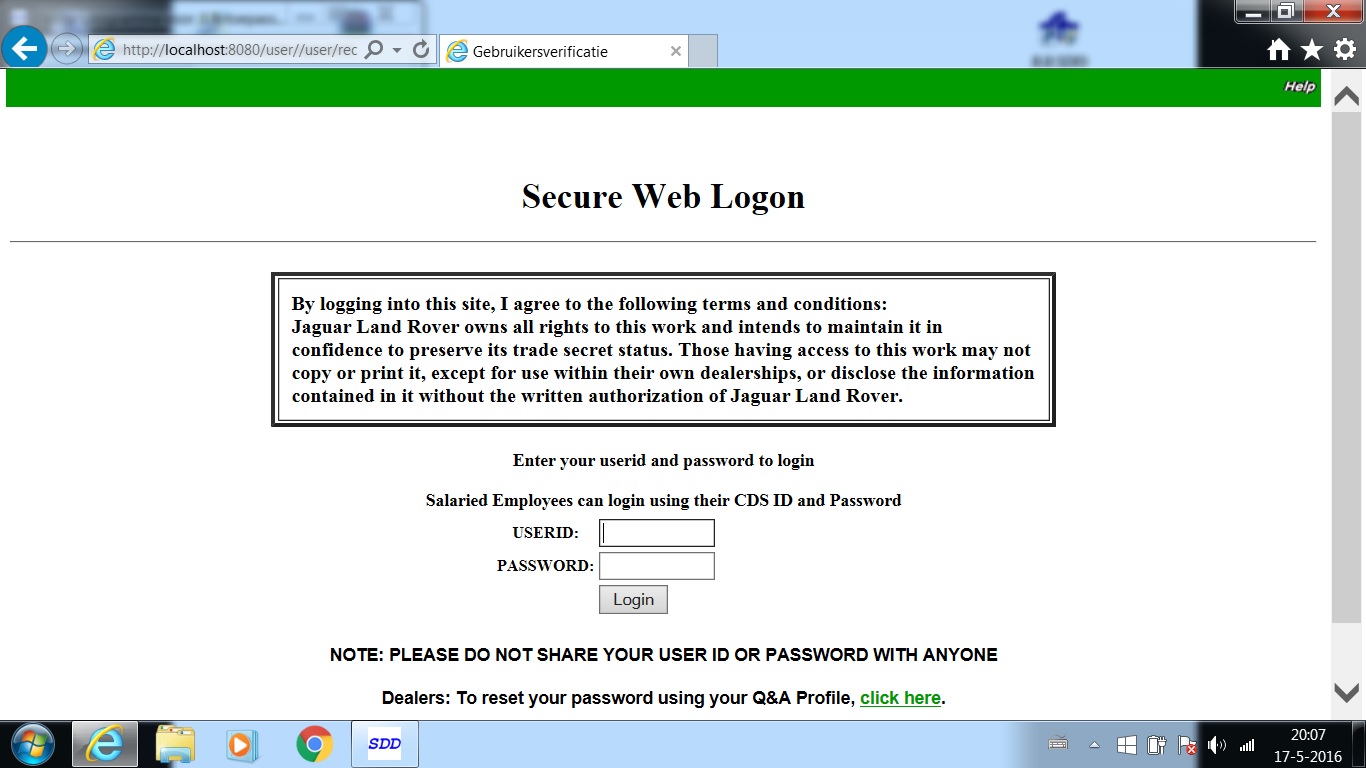

I am new to the SDD software, so I have never used or installed it but it seems I have a similar problem as philwarner had.
I can go to the login screen,
I get a message: Identification has been verified
and then: User Authentication Failed.
Complete story:
I bought a refurbished Dell laptop with Windows 7 pro 64 bit, I5 processor, SSD as harddrive and a original Mongoose Pro. The people where I bought the Computer and Mongoose from installed the Mongoose software (maybe here lies the problem?).
I installed Norton Anti virus without a problem. Then I downloaded all the files from Index of /265935/idscentral
JLR PanasonicScript-Setup
SDD_145.00_FULL
SDD_145.01.001
SDD_145.01.002
SPA_145
VDF_JA_145
VDF_JV_145
VDF_LA_145
VDF_LV_145
And did the installation according to the manual. Because I was having problems having the Panasonic Script to run (Windows error, needed to install: C++2005 Service Pack 1 MFC Security update.exe ) I used the Windows software remover and deleted the Mongoose (maybe not complete?) . After I installed C++ there were no problems installing the SDD. But when I try to login it will give me the message: User Authentication Failed .
I tried to set Norton on non active with no succes.
Any thoughts? Idea's?
At this point I think it would be easier to install a cracked version instead of original.
Or do I need to run the DrewTech Mongoose software?
Attached Thumbnails Mongoose JLR SDD software installation?-login.jpg   Mongoose JLR SDD software installation?-loginok.jpg   Mongoose JLR SDD software installation?-foutmeldingtopix.jpg

IMHO you have gone through too many tweakings in your softwares' installations.
From my experience (said above already), it is very important to start from clean. After many unsuccessful attempts, for me it worked only after a fresh re-install of the OS on the laptop (Win XP Pro-SP2) and loading of the many IDS-SDD and calibration files from two CDs.
I used a clone Mongoose (non Pro) and v131.03
Since then works like a charm.

The SDD version you are using requires you to log in to topix. The last version that did not require a log in to topix for use of all the SDD functions was V130 (or V134 I cant remember now!).
So if you don't pay your monthly dues to topix and have a legit username and password, its all for nothing. It will read you dtc's (all of them) but I am quite sure you won't have access to many (read if any) functions to change stuff because it is all centralised on Topix now and downloaded as required via the internet.
Also using Win 7 64bit isnt going to help, ideally you need a 32bit Win Xp SP2 laptop. With Win 7, You have to use VMware which also has its own irritating settings.
It cannot for any reason, under any circumstances, be allowed to connect to the internet once the SDD has been installed. All the pre requisite software and settings should be done prior to installing the SDD.
I could go on and on about what not to do, because I spent more than an abnormal amount of time trying to get a version (and I have many versions) of mine to work.
It really is a lot of trial and error and luck, there are many threads on this board that should be read too prior to installation to give you an idea about what the process and pit falls are.
I can give you a link to access V125 or 130 if you like, just pm me.
