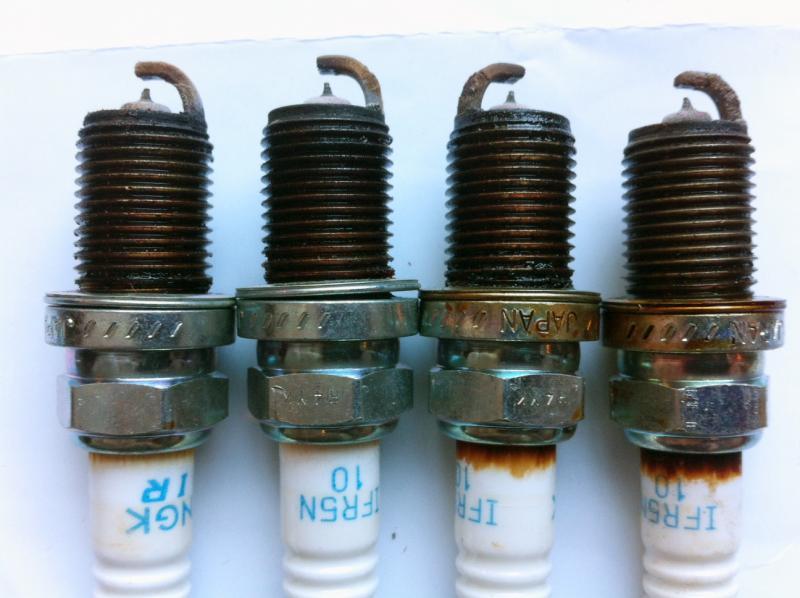

Am no experienced plug reader myself, but they clearly are not eroded at all. They do have some carbon buildup, but other than that they look fine to me from the pictures (would prefer to see them more detailed).
Errr - are these special plugs? Every plug I've ever seen has a flat topped centre electrode. These look like they're burnt away to a point.

Bank 1 plugs. They were a lot "wetter". As you can see, these electrodes are worn unevenly and there is carbon build unlike bank 2.
By the way the far right plug, closest to the firewall, has buildup inside the insulator chamber unlike the other 7.

I HAVENT BEEN FOLLOWING THIS THREAD MUCH SINCE ITS A RUNNER. BUT THOSE PLUGS ARE TOAST IN THE MIDDLE AND THE OTHER SET OF 4 ARE TOAST ON THE END. THE IR(IRRIDIUM) PLUGS ARE SLATED FOR 100K SERVICE, BUT I HAD BEEN DOING RESEARCH INTO DRIVABILTY ISSUES READING THROUGH ADVANCE TECH INFO ON ASE'S WEBSITE ABOUT PLUGS. EVEN THOUGH IR'S ARE SLATED FOR 100K SEVICE, "ALL" MANUFACTURERS SAID THE PLUG PERFORMANCE BEGINS TO GO AWAY AFTER 60K. THOSE ARE ADDITIVE DEPOSITS BY THE LOOK OF THE HARD LIGHT COLORED BUILDUP. ANOTHER ISSUE THAT THE PLASTIC BATHTUB INTAKES SUFFER FROM IS COLD START OIL VAPOR/OIL BUILDUP INSIDE THE INTAKE. AND THIS IS A PROBLEM WHEN COLD. INJECTOR CLEANERS AND INDUCTIONS CLEANER HAVE TO BE RUN A HOT ENGINE NOT COLD. THIS IS WHY YOU HAVE DIFFERANT GAS BLENDS FOR SUMMER/WINTER. TO EASE STARTING. IVE SEEN MANY CARS START ROUGH, ALITTLE BLUEISH SMOKE AND A COUPLE RAPS OF THE THROTTLE CLEARS RIGHT UP.
DONT KNOW IF YOUVE DONE IT OR NOT. BUT I WOULD PULL THE INTAKE, CLEAN OUT THE OIL POOL IN THE BOTTOM TOTALLY AND DECARB THE INSIDE. REPLACE THE GASKETS AND SEE WHERE YOURE AT ON THAT....
FUNNY TOO HOW JAGUAR AYS THE "CORONA RINGS" (BROWN DISCOLORATIONS AT THE BASE OF THE PORCELIN) HAS NO PROBLEM WITH THE PLUG PERFROMANCE( iDONT KNWO FOR SURE EITHER) BUT THE DEPOSITED PLUGS HAVE BIGGER DARKER CORONA RINGS, OR IS IT JUST ME? GO TO NGK, CHAMPION AND OTHER PLUG MANUFACTURER WEBSITES FOR ACCURATE PLUG READING INFO WITH PICS

Jahummer, I'm good with all Brutal said here, just be aware his plenum [intake] comments apply to NA engine, not you, you have a Super. The plugs have not eroded much, iridium plugs have a very small, point type center electrode, not the wide flat electrode of older plugs. I'm right on board saying those plugs need to be changed out, it's time.

No doubt replacing them helps, but what I'd like to know is there anything with this bit of evidence that would indicate another concern with the motor or even something related to the idle RPM drop at stop?

I just flicked back and looked at the photo of the first four plugs to compare with the second photo. Looking at them, the dirtiest plugs look almost as though they have nt been as tightly seated as perhaps they should have been. It looks like you have had some combustion mixture leaking past the two centre plugs in the first photo, and the two right hand plugs in the second. Were they the plugs that were harder to remove?

The two with the larger coronas are also showing wet threads and the crush washers are looking a bit discolored too.
Languid is onto something.
Maybe leaking plugs.

Dropped car off at the dealer and left the plugs with them. Tech said that if there was a leak of any kind, it would trip the CEL or there would be codes in IDS. Any truth to that?

Picked up the car today. Their Jaguar Master Tech said the plugs looked about 84K miles old although they do mostly warranty work and don't have occasion to replace spark plugs that often.
I drove around a bit and must say the plugs made a big difference with throttle response vastly improved.
