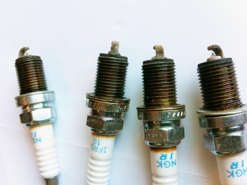

Plugs from bank 2

Those plugs look like they have been burning lean.

Well Steve, despite what you and the master tech said, I figured it would not hurt to replace the plugs. It may be too soon and possibly coincidence but the motor is running a lot smoother no roughness stopped in gear. RPM at idle is higher too. The Bank 1 plugs were a bit wet with oil and a bit of carbon. Two of them took quite a bit of effort to remove. I'll take them to the dealer Monday for their thoughts. I still have rough idle for about a minute on cold starts which they think they can eliminate.

Whow, I have never seen plugs in such a bad state; they are just burning away ! It would be better to show all four as a comparison, plus a new one so everybody including those who have never seen a plug out, can see what has happened.

Good Grief,
I'm 67 and I've never seen plugs that badly eroded away. The two outer ones don't show a lot of fouling, but the white carbon build up on the centre two plus the completely eroded electrode is a little odd. Almost as if they are running too lean, but I can't figure the carbon deposits out. They don't look like oil carbon, it is usually fairly black. Way back when, before emission controls & catalytic converters etc, we use to just the state of the engine by the colour of the tailpipe. About that colour was usually a little lean, but almost right. Tailpipes today are usually a light chocolate when the engine is running right. It could be worth while taking a look at yours to see what colour it is. If it is very light, it might be an indication. Without looking back through the thread, how many miles have you got on the clock?

p.s. I just had another thought; it's almost as though the plugs are the wrong heat range for the engine.

Jahummer,
another question; are they in the order left to right (in the pic) rear to front? Or are they random?

xrguy, Brutal,
I keep looking back at those plugs, and the outers (in the photo) are running 'clean', but the two in the centre are fairly 'deposited'. I'm not experienced enough to ascertain which of the two outers is the correct 'burn' colour although I suspect the right hand one is closer to ideal than the left. In my experience, with factory standard mainfolds the outers always burn a little leaner than the inners. Thinking that through & given that the computer is going to look at air flow sensor, exhaust gas content, and throttle/power position to calculate what it thinks the fuel/air ratio should be, I'd reckon that there is an inlet manifold/plenum chamber air leak somewhere. (jahummer, I'd also guess that your fuel consumption is a bit higher than perhaps it should be). Looking at those plugs, the centre ones are being fed on a richer mixture than the outers, and the left outer looks a bit lean to me.
What do you guys' think?

Is the second from the left a different type or is it just the other way up ?

Am no experienced plug reader myself, but they clearly are not eroded at all. They do have some carbon buildup, but other than that they look fine to me from the pictures (would prefer to see them more detailed).

I do not think they are eroded but there are burnt oil deposits built up on the ground and electrodes, some worse than others. They had about 84K miles of use.
I will posts pics of bank 1 plugs, instead of having the tan coloured build up, they have some black carbon and were damp, with oil and 2 were a bit hard to remove.
They are all the same, NGK IFR.
