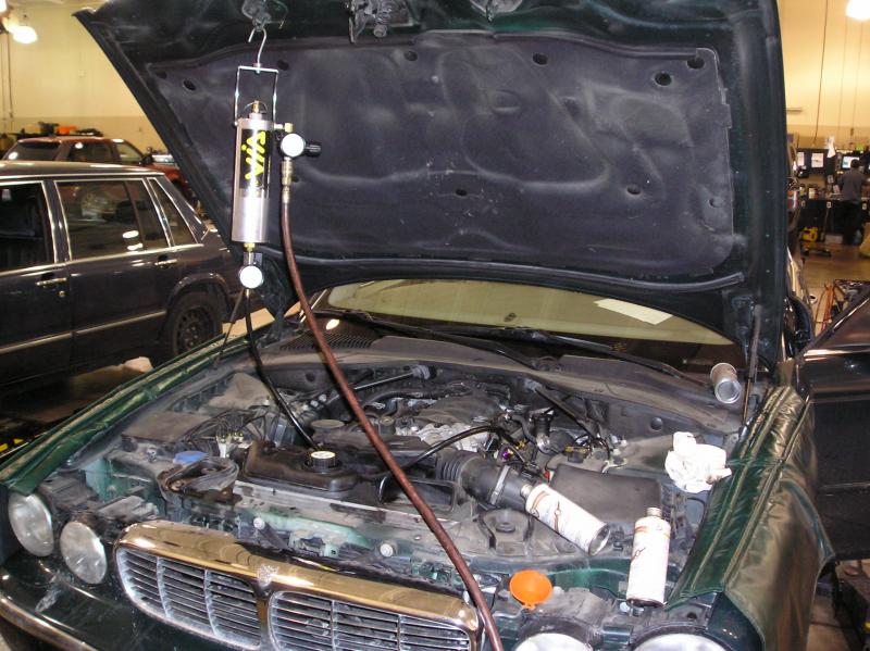

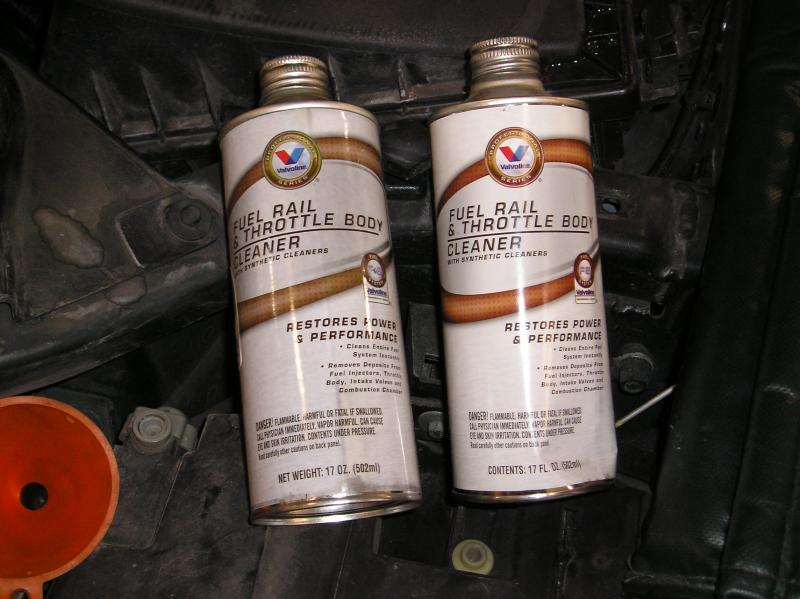

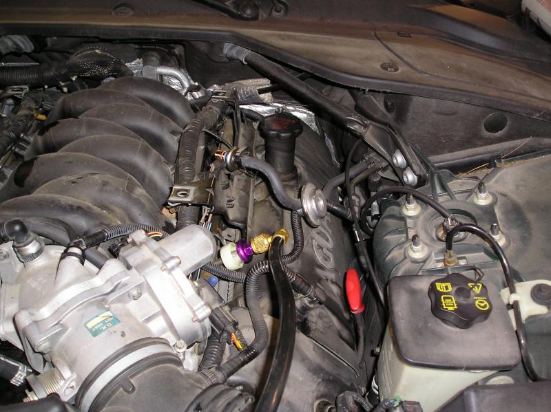

If it were me, I would do as I suggested to Jahummer in another thread, treat the tank with BG 44k twice about a week apart. You may notice some subtle improvement like he did. Don't be afraid to be a little aggressive a time or two while it's in there. I don't know what that stuff is, but it is a big help sometimes. Once you are back on good gas alone, assess the situation.
If you feel there is still a need for improvement, go ahead and schedule an injection cleaning. Be sure it is the type that runs the engine on the cleaner only, with the fuel pump disabled. Here are a couple of pics of the setup we use. You can see the fuel line to the rail is completely disconnected and the cleaner apparatus is connected straight to it. I'm not going to get into who's chemicals to use; I've said in an earlier post we tried Wynn's and switch back to Valvoline SynPower because of poor results with Wynn's. Jahummer seems to have had some success, so that's one for them.
We run two cans through the injectors; fill the apparatus once and run 'til empty. Fill with the second can and start and run the engine 'til it's running smooth again. Shut the engine down and let it sit for 30-45 minutes, let the cleaner sit there and soak. That appears to 'soften up' the coking or buildup. Start and run the engine 'til is empty again. Now, reconnect the fuel system and prime and start the engine.
Now the fun part......... go out someplace safe and run the dog crap out of it. Give those injectors and engine in general a workout. Bring it home and disconnect the battery for a while and clear out all the fueling adaptions. Reset the clock, windows etc., and you are done.
Now, when I talk about results, I'm talking about something I can quantify or prove. I just happened to do one of these jobs today, and there is a before and after print of the fuel trims in this instance. This case is almost too dramatic, but that's the way it went in this case. Long Term Trims staying at plus or minus 5% are completely acceptable. The 12% we started with is not.
Our numerous trials with Wynn's did not produce that verifiable results like I had here. In a couple of cases we followed it up with SynPower and got the wanted results. So that's where I get my feelings about it; and I fully expect someone else may have gotten better performance with Wynn's than we did.
I hate to ramble, but there are no quick answers to some questions or problems. All this work had to, of course, follow the normal full diagnostic path. Meaning all other possibilities for high trims are investigated and or ruled out, such as intake leaks, MAF Sensor, purge system, smoke testing etc. Then the injector cleaning is the next step. There is always the possibility that even the injector cleaning does not provide results. At that point you are left with the more unusual or unconventional things to consider. Sometimes there is an induction leak that is at the bottom side of the intake plenum or intake gasket. Even smoke testing would not find that. Then it becomes the remove the intake and replace the gaskets and reassemble. On numerous occasions that has 'magically' repaired a leak condition after all else has failed. Sometimes the only answer is to remove the injectors and send them to be professionally cleaned, flow tested and balanced.
I wish there was always a quick, concise repair.......sometimes it just ain't possible.
Class dismissed! Sorry I ran over.
Cheers,
