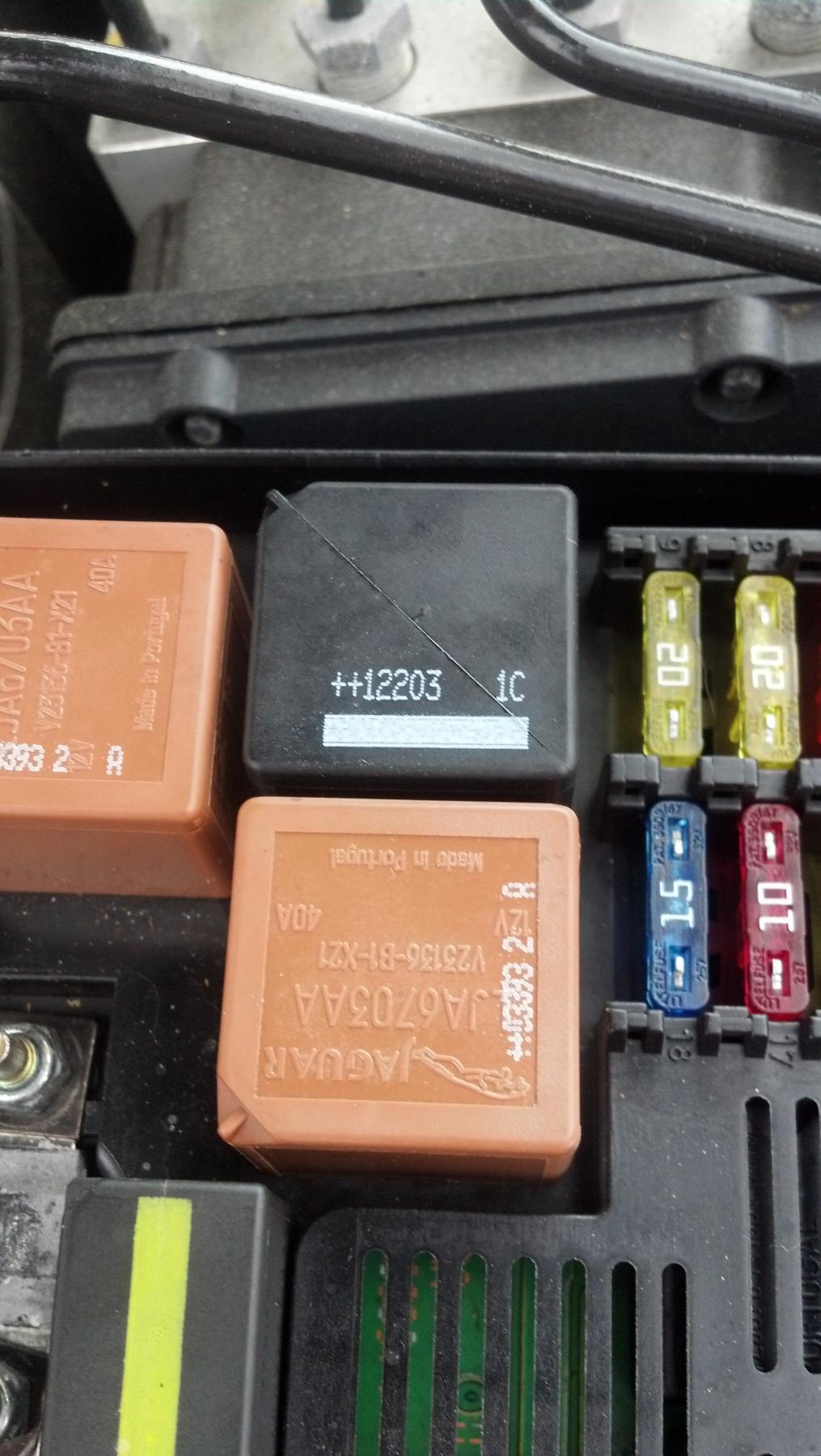

Then, the Air Suspension Fault started flashing back and forth with the CATS fault. I found that the car has no air in the system and the compressor is not running, therefore the air tank is not filling and the system is not getting any air... Last night (Monday) I removed the spare tire and the foam cover to see if there was anything obvious I could see/hear. I did not see anything and did not hear the compressor with the car running or not, when sport mode was engaged and disengaged, etc. I found all three fuse boxes and checked everything that had to do with the suspension and none of the fuses were fouled. The #4 relay under the hood (bonnet for those who refer to it in that manner [I watch A LOT of Top Gear and Eddie Izzard and have picked up on the differing terms]) fuse block is one of the culprits I’ve read about and intend to replace as soon as I can. Additionally, my mechanic explained to me that the front shocks (dampers) have been replaced. I checked the wire connections on top and the pins inside; all was in order.
Prior to this, I went to my local auto parts store to have the codes read and they only came up with the standard P1111, which as I’ve read is, essentially, rubbish. I plan to go to the local Jag dealer if the #4 relay doesn’t remedy the issue. I may go anyway as it’s probably the best choice. But, being stubborn as I am, I feel I need to try this first. It’s not TOO costly and might just do it. When I removed the spare I also disconnected the NEG battery cable for a bit. I reconnected and, as I thought, the faults were not appearing, but, of course, the CATS came back this morning and the ride was still VERY rough so the suspension was not getting any air and it’s only a matter of time before the fault appears again. With all this being said, does anyone know which thread is the most solid for both of my issues as I feel they are separate, but could possibly be related? I’m at a loss as to what to do or where to go other than what I’ve already reported here.
Now that that’s all been said, I have a couple more minor issues that I am hoping to find common fixes to. The first is regarding the right side front seat (the passenger’s seat here in the U.S.). The lumbar control will go forward (pressing on the lumbar region more), but when pressed to release the pressure, it does nothing. I checked all the fuses related to the FR seat and found none in need of replacing. Any thoughts? Secondly, and I know sounds VERY bizarre, I was listening to my chosen morning radio show on my way to work and to help clear the moisture on the rear window, I switched on the Rear Defroster(RD) and the radio immediately went to a high degree of static with the radio program barely audible in the background. When I switched off the RD, the static went away. I did this a couple more times to verify the relation and it was most definitely verified. Once again, any thoughts? Thanks!!!
Attached Thumbnails Multiple Suspension Faults (& others)-resizedimage_1403018905968.jpg   Multiple Suspension Faults (& others)-resizedimage_1403018905314.jpg   Multiple Suspension Faults (& others)-resizedimage_1403018904561.jpg

Thanks for the prompt reply. I was not able to locate a relay locally. The best I could do is have one ordered and it’ll be here tomorrow. Meanwhile, I looked at the box again and saw that there was an identical relay right next to the #4 so I changed them out to see what would happen. All of the Auto part stores I phoned called it a flasher relay so I did the due diligence and turned on my flashers and removed the #4. The flashers worked fine. I removed the identical relay and placed it in the #4 slot and the one from #4 into the other’s spot. I did not notice anything at all. While on my run to pick up lunch, I had to brake hard and the CATS fault appeared briefly again. The ride is still very hard as well.
If I'm not mistaken, its actually the #1 relay under the bonnet.

As pointed out the relay for the air compressor is R1 in the fuse box in the engine bay. The relay is orange.
Try swapping out the relay with another orange relay.
If you find another color relay in the R1 slot (like black) someone swapped out the original orange relay. It may be a FordMoCo relay (my opinion - this 40A relay is a lesser quality relay then the Jaguar orange 40A relay.
Also, test the R1 relay - could be faulty - I had a parasitic battery drain issue and my compressor relay (black FordMoCo) was not working correctly.
I believe there is a fuse in the boot fuse box for the air compressor as well (could be wrong - long day) check the electrical manual and make sure the fuse is good.
As far as CATS is concerned - once a fault is detected - even if the fault is rectified - the code(s) must be reset by the dealer or someone that has Jaguar level software like WDS...
I'm pretty sure the same is the case with the air suspension system.
Just my $0.02
You hit the nail on the head with the black relay. It didn't say Ford MoCo, but only had a the following markings ++12203 1C. I've added a pic as well. I will check another orange fuse right now and report my findings in this reply. As for the fuses, I've been through all of them that had anything to do with the suspension, air compressor, etc and found none that were blown.
Verdict of the test. There were three other orange relays in the box and I tried each one. I had my wife start the car and I timed it for one minute each time the engine was started and the compressor did not run on any of them. I can guess with 99.9% certainty that it's not the relay. I a seeing a replacement compressor in my future..
Unless I get more ideas of testing... I'm all ears at this point as I have nothing else I can think of.
On an unrelated note, the lumbar button on the right side seat not going back when the button is pushed and the defroster causing the static in the radio... Does anyone have any thoughts on it as it seems I've come to an impasse with the air ride...
