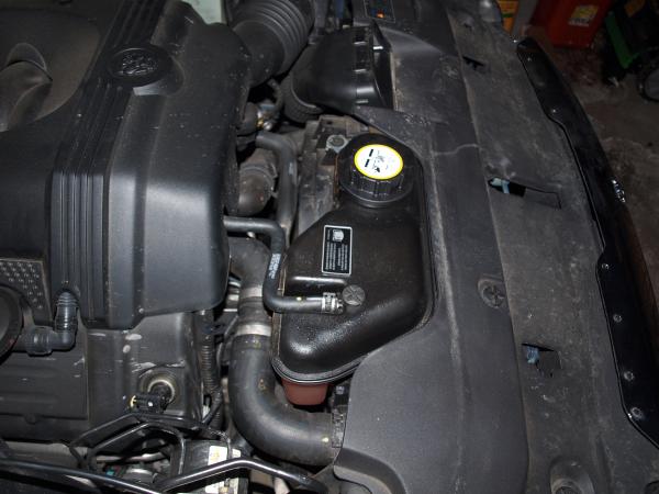

Fraser, funny you should post this as I was about to post a similar tale. As misery loves company you should know mine was in the shop this week for the same issue. The lip that rings around the waist of coolant tank was collecting coolant, the first sign that plastic nipple preparing to break. My indie mechanic says this is a chronic issue with our cars, it's the first thing he checks when he has one in his shop. He too wonders why they went with plastic.
Luckily in my case it was an inexpensive part and easy access meant a quick job for the mechanic. But, of course, then I get the "as long as we've got your car here, did you know you're due for a 60,000 service ...."
TO ALL OTHER READERS -- Keep an eye on yours! Luckily these warn you with some drips and drops before they burst and spew coolant. Photo of offending part attached. Pay special attention to the tube attached to the tank, clamped on. This is where I'm told the break is likely to occur.
