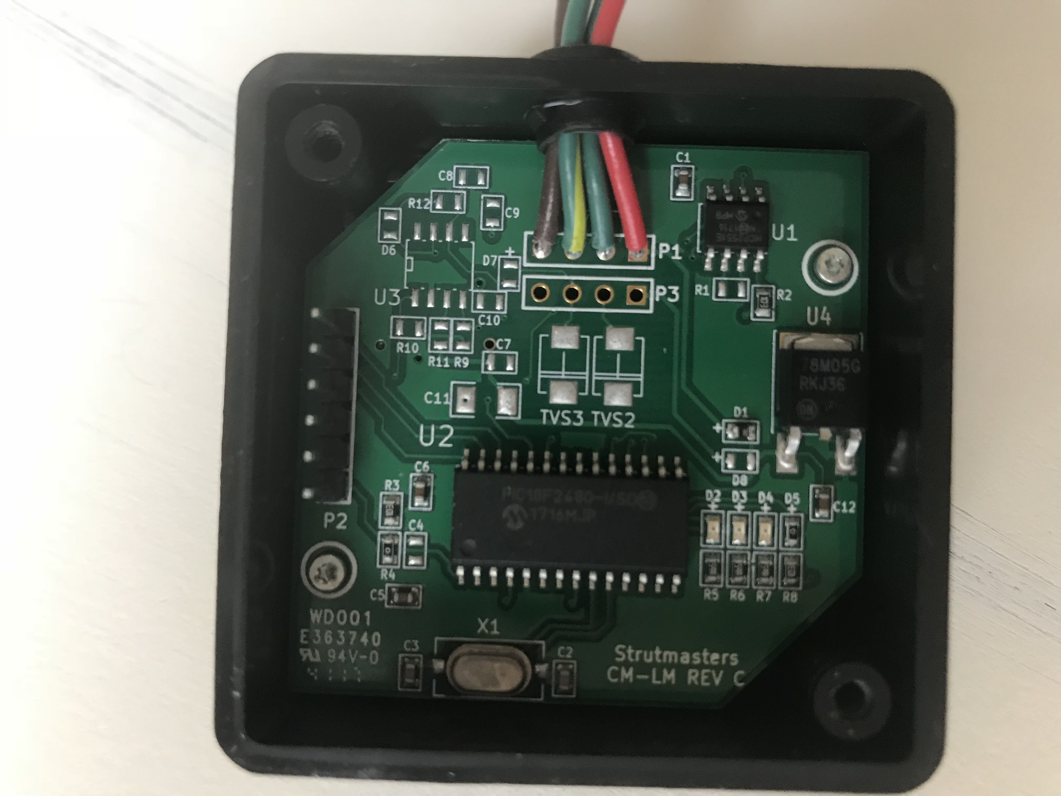

I did not need to use their suspension message interrupter. I was able to unplug the ASM from behind the rear seat and do not have any fault codes. As a side note, for some reason I thought their module was a plug and play, but it needs to be spliced into the system behind the seat, so a little more permanent than what I had originally thought.

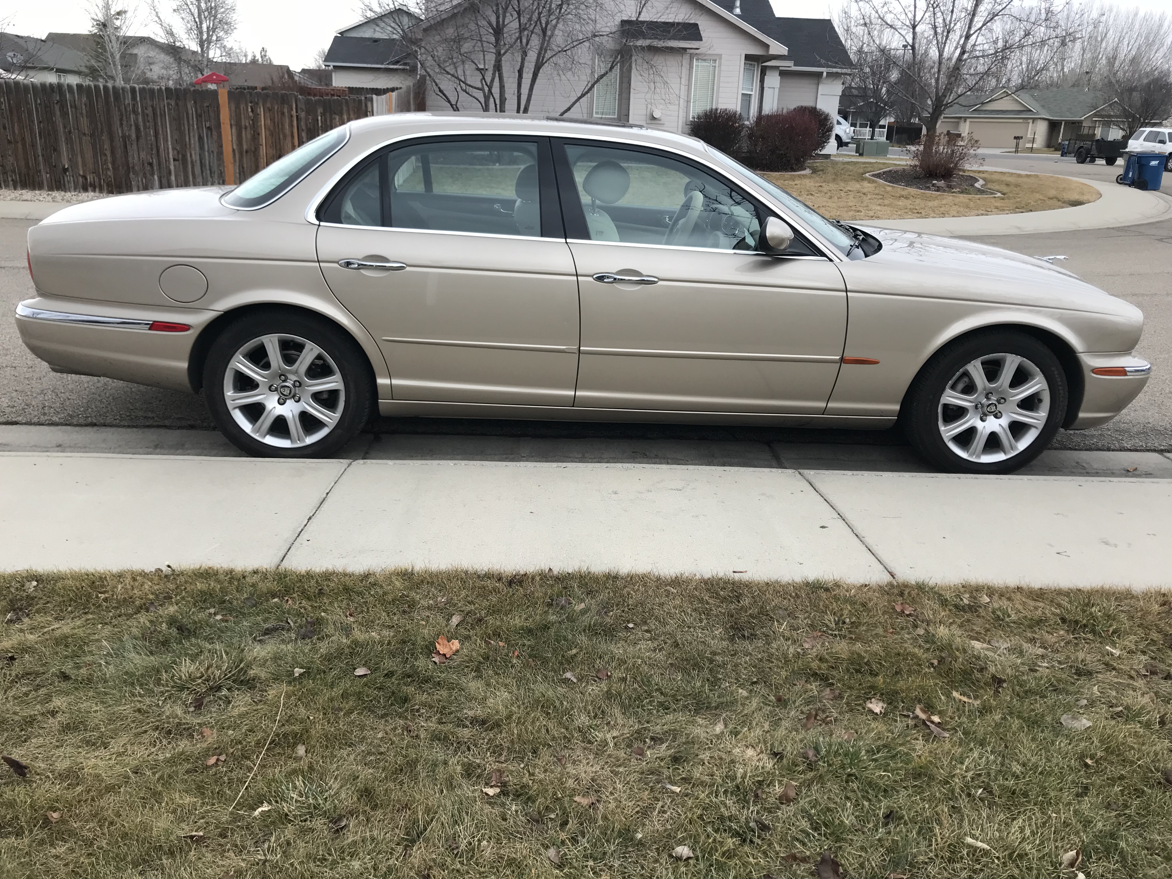

Initial impressions are that the car sits a little higher than stock and is certainly stiffer, but based on other member’s reviews they say the height will lower and soften a bit over time.
