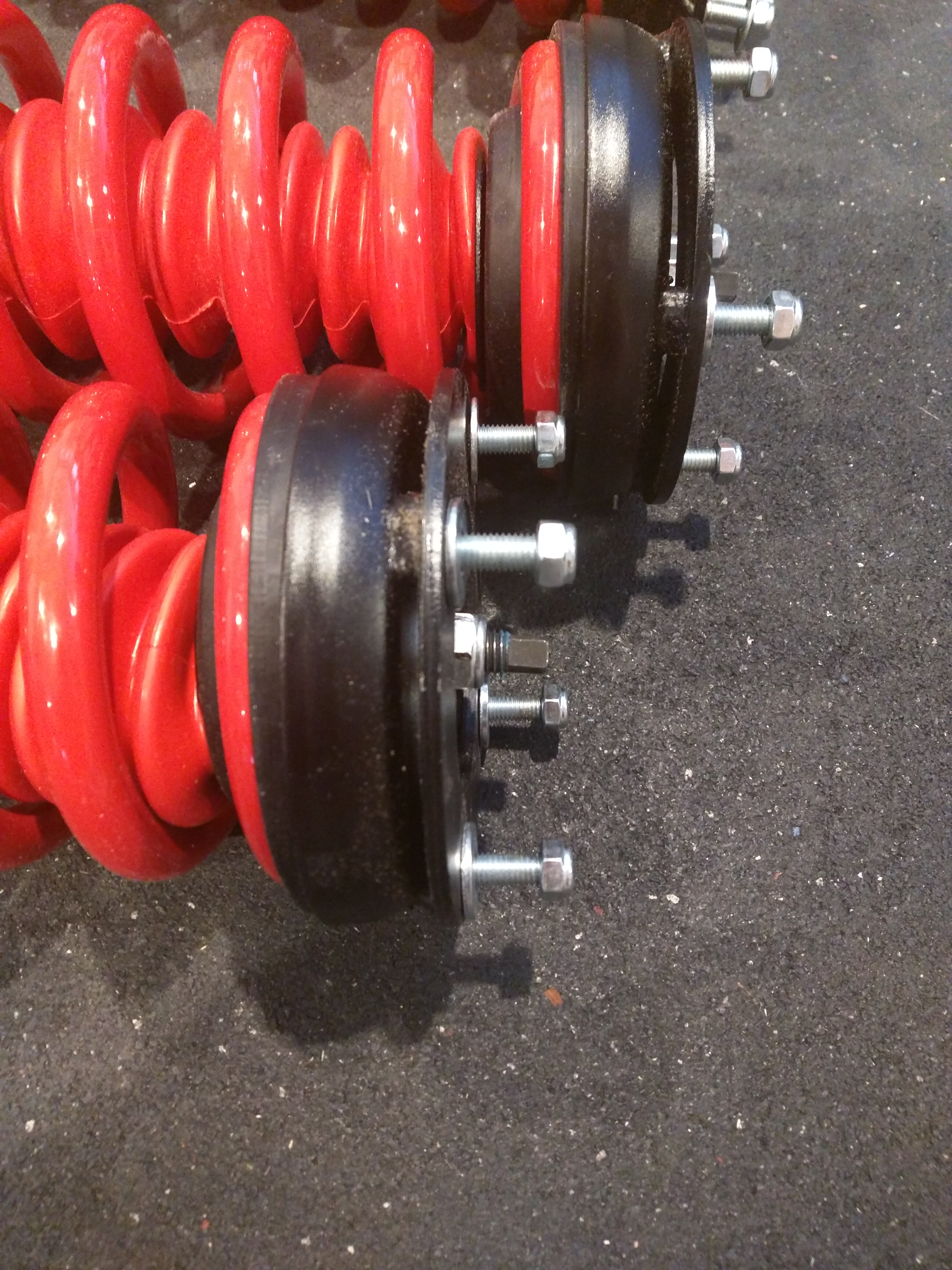

Attached pics.
Now, be aware... Many posts say that the shocks are Bilsteins. This is due to the Strutmasters site pics with yellow shocks that are clearly Bilsteins. Problem is that Bilstein shocks from the S type R model which are Bilsteins..are not yellow. they are black for the rear and green for the front
What I just got from them are rather generic looking black shocks with red Eibach springs.
I'm going to install them tonight. Ill let you know my impressions in about a week or so. If i think there is room for improvement, I already have a plan:

Well that's a bit of a deal breaker. I thought the struts in the kit were higher quality. I'll be looking forward to your review. Unfortunately we won't really know the actual quality until they've been on the car long term.
