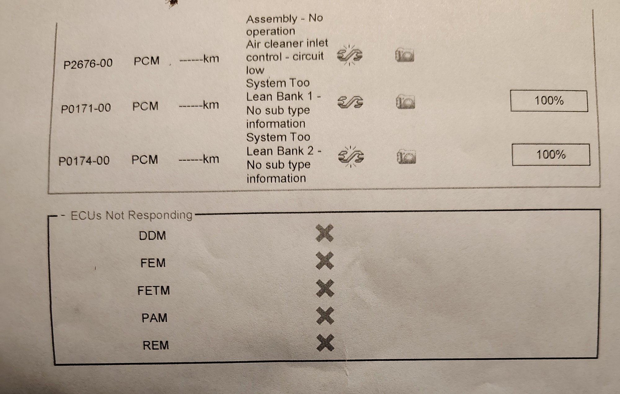

Attached is the SSD. My gut feeling tells me it might be about the first 0402 - ABS receiving invalid data from TCM - intuition tells me its electronic, not mechanical, Maybe someone could relate. @clubairth1, thanks, can you take a look?

If SDD is not connecting to 5 modules I think that will need to be fixed before you can move forward?
Have the codes been cleared to see what comes back? U codes (Network Codes) tend to point to low voltage situations and I ignore those. At least in the beginning.
There is a general reset in SDD but not sure if that would do anything for your problem or not.
The 171 and 174 codes are very common and usually indicate air leaks somewhere in the intake system. On old cars the plastic intake piping can crack. Look underneath the plastic and make sure the air box lid is on right.
