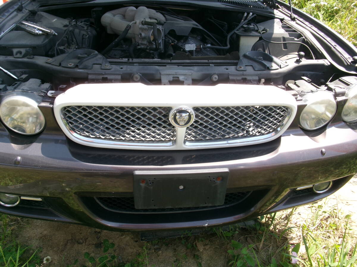

P.S. Any chance that lower bumper mesh grill survived the front wreck? Mine fell off and for the life of me I can't find a replacement.

Originally Posted by rsa760041
That grill is for an X350. That Portfolio is an X358 I believe. 2008 UK, 2009 US. You can occasionally find them on ebay and they are not cheap. I bought one piece by piece 10 years ago, about $750 and that was just the upper grille.
In fact, they are all over ebay now. Just 2 of them below. Seems $1200 for the upper is the going rate now. I could sell mine, but then I'd be up a creek if I pranged the nose of my Portfolio.
https://www.ebay.com/itm/28553275360...3ABFBMhISj0fxl
https://www.ebay.com/itm/28644265058...Bk9SR4SEo9H8ZQ

Xenon Headlight will be expensive if you don't have one off your 03 that will work. The X358 grill is different than the X350 as for as the emblem placement, When i fixed my 05 XJR I wanted to look like the X358. I modified the 05 grill with a piece of PVC pipe and some epoxy for the emblem mount and used a center cap emblem for a the badge. The badge diameter is a little smaller but nobody notices the difference and it saved me a bunch of money when I did this back in 2012 as these cars where hard to find as salvage units back then.

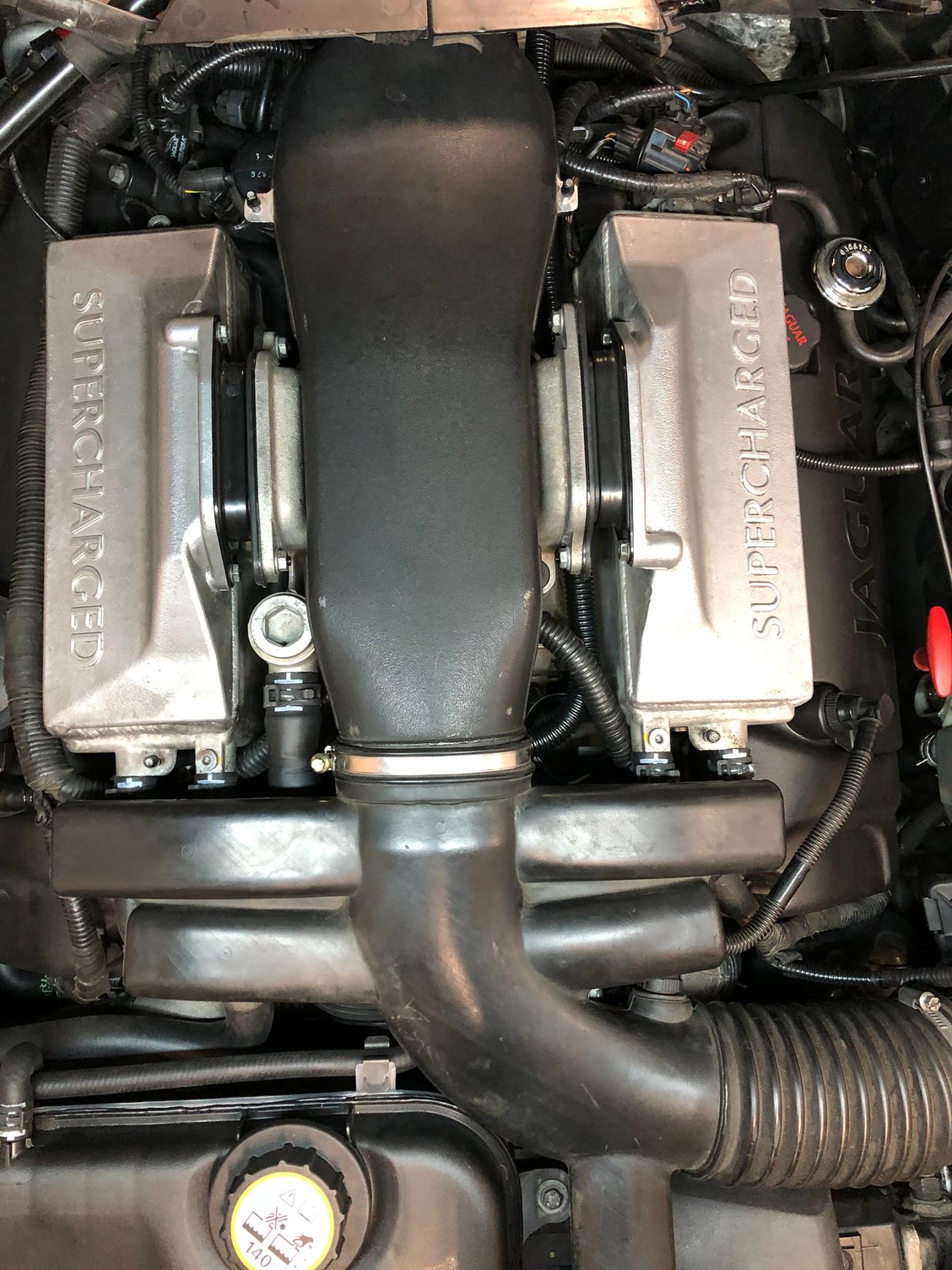

Hi, progressing very slowly, but I'll need to have everything done in next two weeks to avoid some fines. I'm stuck on the following topic: had to remove and mount all three radiators - main, AC, and intercooler, two are new, one has been repaired. I'm looking into the manual, and there are two procedures to refill the whole system - one simple, and one requires a special tool with a manometer that you screw on top of the expansion tank, create vacuum, suck the liquid in, etc. No other comments are supplied. I don't want to mess it up. Could you please share how did you replace the coolant in your cars? It has to apply to the Supercharged version, since we have two radiators and compressor cooling on the same liquid / circuit. I'm afraid that i.e. the intercooler radiator will be empty, etc. Please help.

About the radiator and intercooler, I recommend taking this opportunity to have custom ones made in all aluminum. The stock ones have plastic end tanks which can't be trusted in the long run. It's not a big deal, you find a shop that can do it, they order a core(the fins and tubes) in the correct size, and fabricate custom tanks and barbs. Also, you can split the engine and supercharger cooling into two completely separate loops
The supercharger intercooler has it's own pump so you just divorce the plumbing and add in a reservoir for the intercooler. You should also upgrade that pump while you're in there.
As for filling, I've not checked the service manual but vacuum is always the best if you can. It ensures that you don't have any leaks, you watch to make sure it holds a vacuum, and prevents you from having any air trapped in the system. If you can't get the equipment to vacuum fill then I don't know of any reason you shouldn't be able to fill normally.
Edit: I just checked the FSM and it does say to vacuum fill, but I don't see any warnings saying you can't fill without vacuum. Nonetheless, that isn't a guarantee and vacuum is the fsr superior method.

Vacuum filling is not a must, the Jaguar workshop manual shows both options.
When I replaced the valley hose on my SV8, which in my opinion is more important than the radiator job recommended by Pirate_Freder, especially as you already have the radiators, I refilled the whole system in the traditional way without any problem. My intercoolers where empty, as well, as I had removed and cleaned them.
The only "special tool" you need is the is the big hex insert (I think that it is a 17mm one, but I am not 100% percent sure) needed to open the supercharger circuit to be able to fill it. You can see it in the picture between the suoercharger intake and the intercooler on the left:
I have attached the relevant excerpts from the workshop manual.
