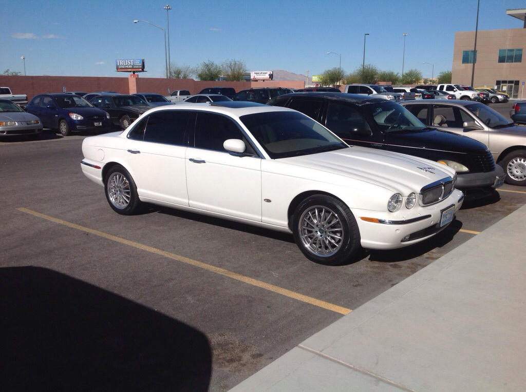

I'll get a few pictures snapped. It's close to standard ride height. It does look high if you are used to the resting ride height overnight.
That's what I used too, Strutmasters. It's a bit stiff riding to me, but I came from long wheelbase comfort air. I did go immediately from the install to driving 1,500 miles and could feel it soften a bit. It's probably got some time to go before it's broken in. The handling is exponentially better.

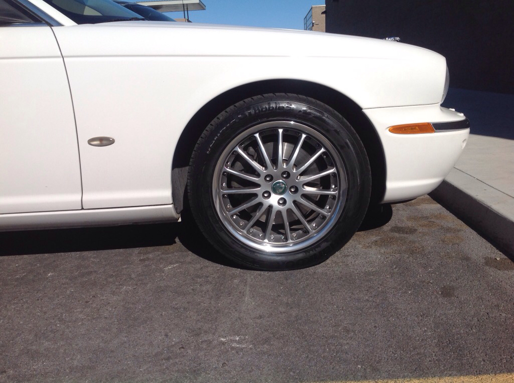

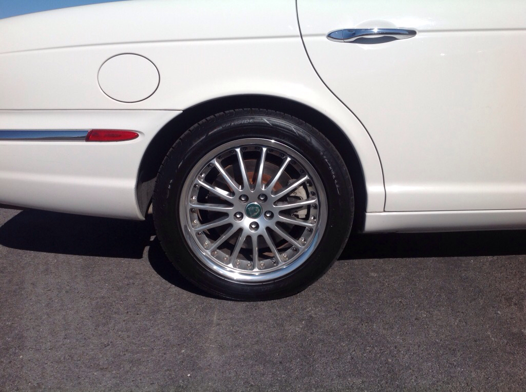

Some shots I took before I left work.

WOW!
Talk about a clean XJ! That is one of the first white ones I have seen.
Ever think about blacking out the roof with a nice gloss 3M vinyl? I think that would look snazzy.
Thank you for taking the time to post a picture I appreciate that a lot. What size tires are you running looks like a pretty high wall?
I showed my wife the full shot you took and asked her to find the flaw in the image. She had no idea it was different. I think it looks not much more than an inch higher than the oem. Looks great to me.

The tires are 235/50/18s which are the stock tire size on the Vanden Plas, but the wheels are Conventry Whitleys with green growler center caps. I think it may settle a bit more as it breaks in. It definitely looks a bit lower after a decently long drive. I had thought of larger wheels as 20"s were an option in the same style, but I was worried about bending wheels.
