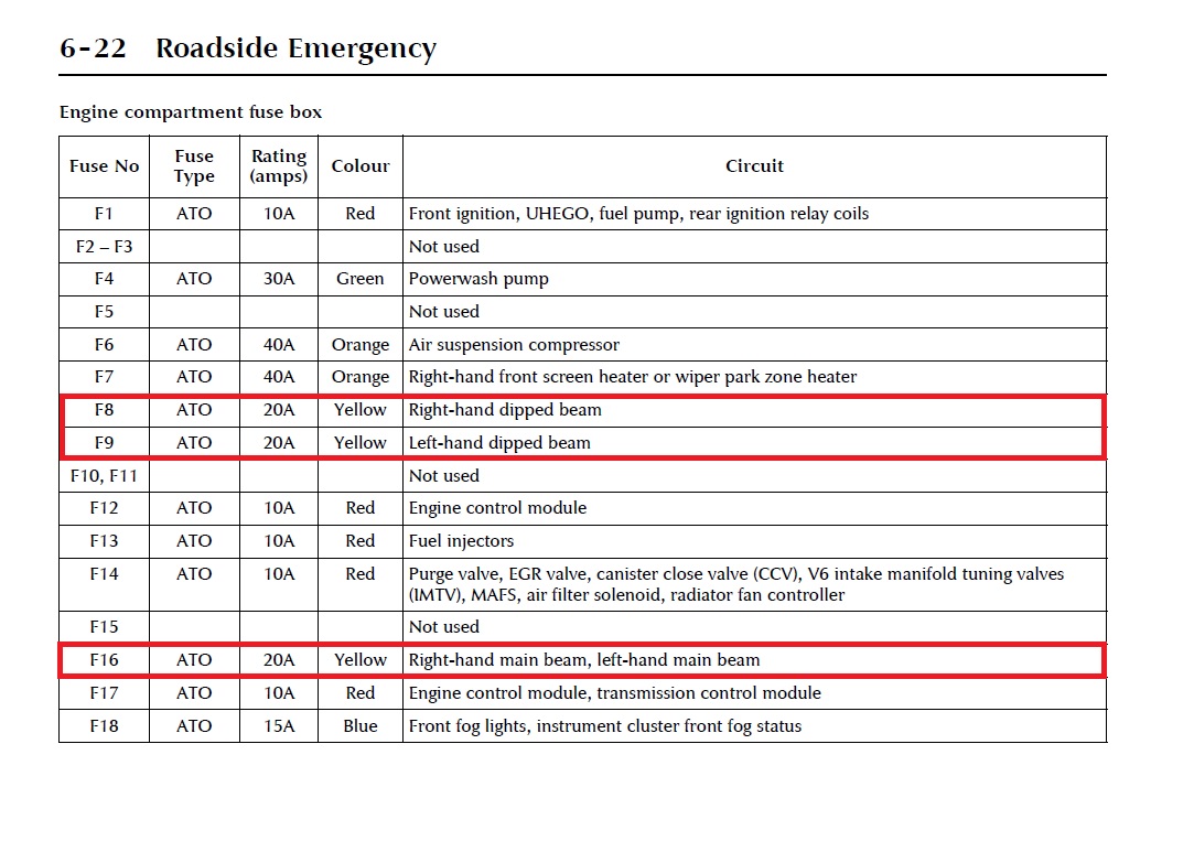

The main beam lamp unit and the front parking (side) lamp are in the inner unit and the dipped beam and the turn signal lamp unit are in the outer. Dipped are fused separately but both main beams are on the same fuse:
